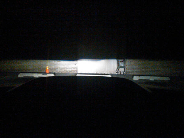

    Congrats, I started my retro last year but just got around to finishing it up and mounted on the truck. Here is an output picture after I got them aimed. Still need to drive around and see if I need any minor adjustments.
    Let me know if you have any questions along the way.
