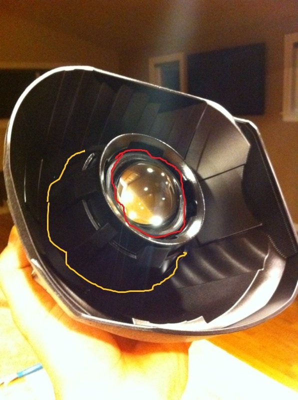

    Sorry for the dumbass moment but in this picture which part needs to be glued the red or the yellow? Or are you talking about putting glue on the back side

    apply the silicone on the projector, where it touches the shroud, then slide the shroud over top so the silicone doesn't get onto the projector lens.
    then if the shroud touches the reflector bowl you can silicone in those areas as well, but apply the silicone on the inside of the shroud so that it doesn't become visible from the outside.
    hope that helps, so really to answer your question...you can glue both red and yellow areas, but at the minimum the red area

    Got it just don't get any glue on the projector lens it self.

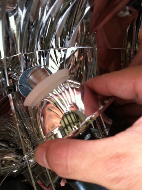

    ok got them apart and was just looking how the projector goes threw the bowl does this rubber washer need to be on inside of the bowl or outside? And this is the BIG rubber washer not the smaller one. Wasn't sure which one to use.

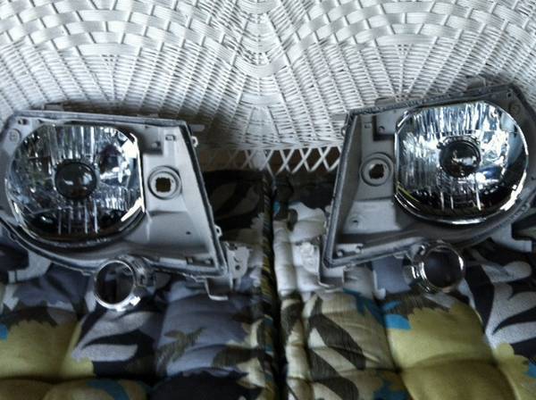

    Ok figured that stupid rubber washer part out, now on to the dreaded shrouds! Do I have to take out the reflector bowls just to put the shrouds in or just glue em in. This is what I got so far! Painting turn reflectors also tonight, hopefully pick up on the shrouds later.

    you can glue em on with the projectors on.. doesnt matter.. but test fit everything first before you glue em

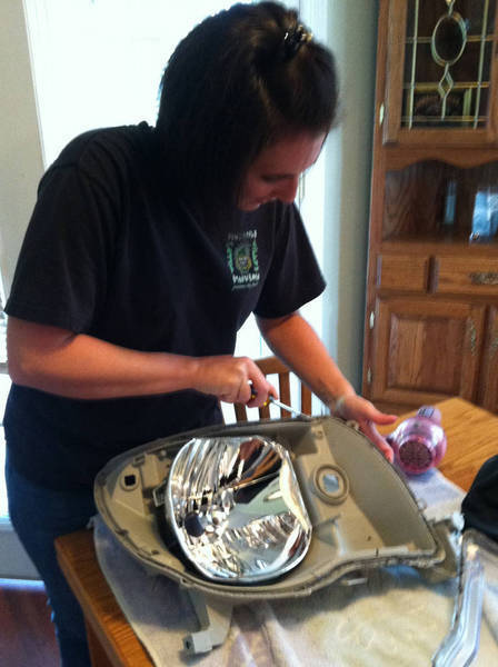

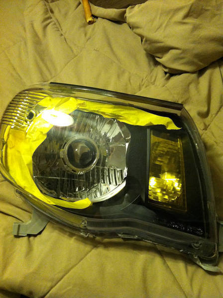

    A few other pic's from day one of the retro process! Even got the wife to help!
    Taped off to paint side marker yellow and popped back in my yellow turn signal reflector and had to sit everything in to just get an idea of what it will look like. All the painting is done and I'll take pics of the painter tape off this afternoon when I get home. Haven't done an alignment yet that's next, but all depends on the weather this afternoon. But that's next on my list. How far from the wall to do a proper check 30ft?

    Anthony, lights are looking good...not too hard eh?!
    Nice to see that you got your wife to help! How did you do that?? lol
