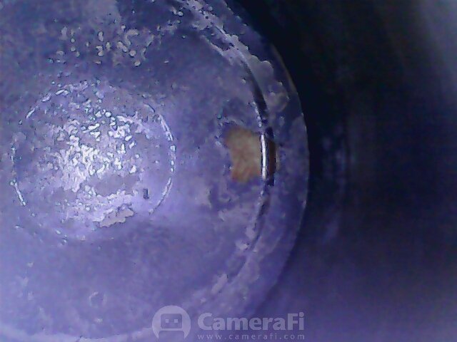

    A borescope sounds like a good idea. I bought this one from Amazon and the best images I could capture were these. It works well but the mirror that goes on the end to shine upward(at valves) doesn't capture good images with this particular borescope.
    Borescope I bought: https://www.amazon.com/gp/product/B076RMDZL8/ref=oh_aui_detailpage_o01_s00?ie=UTF8&psc=1
    A few images I captured with it:
