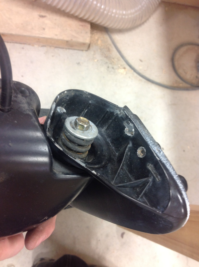

    If they are moving a lot. Just re tighten the joint
    Here is the main bolt

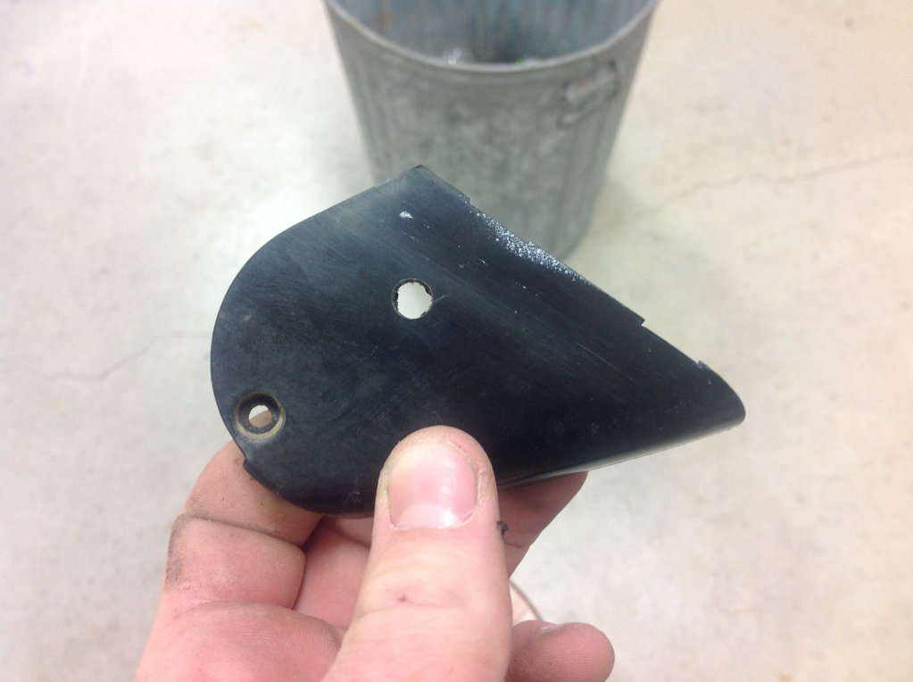

    Have to take off the cover which is pretty simple just one screw(ignore the hole I drilled, for something else)
