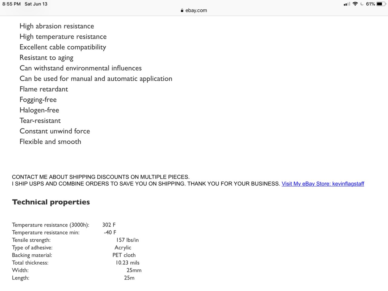

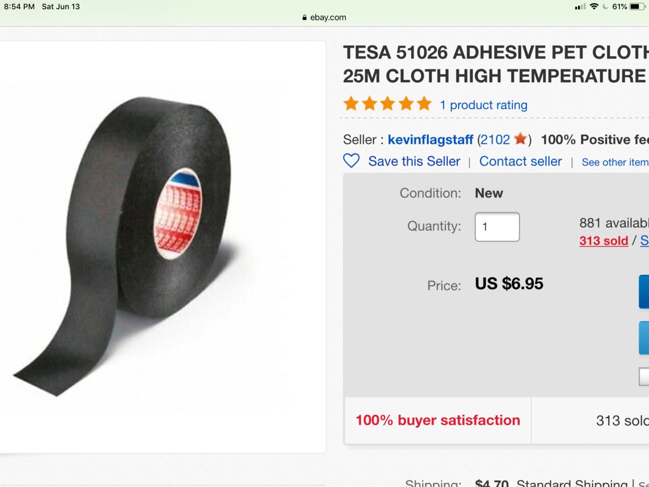

    There lots of different type Tesa tape, you want the 51026 type, 300 degrees resistant,

    Thanks for all the feedback, guys. After a ton of head scratching I decided to replace plug wires (even though the plug wires were new a year ago)... and bingo. Maddening after pulling the intake off about 4 different times while i did the troubleshooting, but glad it's back up and running.
    That TESA tape is awesome!
