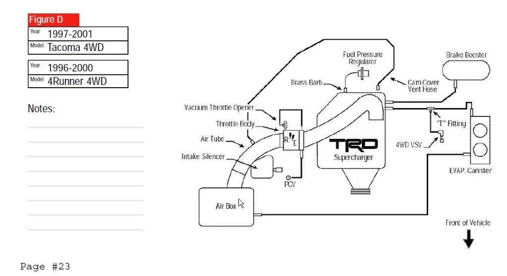

    ok I think I found my problem. I have a vac hose that wasn't plugged in. It's the one on the air intake...to somewhere behind the motor. Anyone know where this line needs t run too?

    The one on the intake tube just shy of the throttle body?

    I found it. It goes in the back of one of the heads. The driver side behind the s/c. So I ran sea foad in it. And it got better. A tech at my work said flood it with sea foam and let it sit for 6 hrs so well see after this

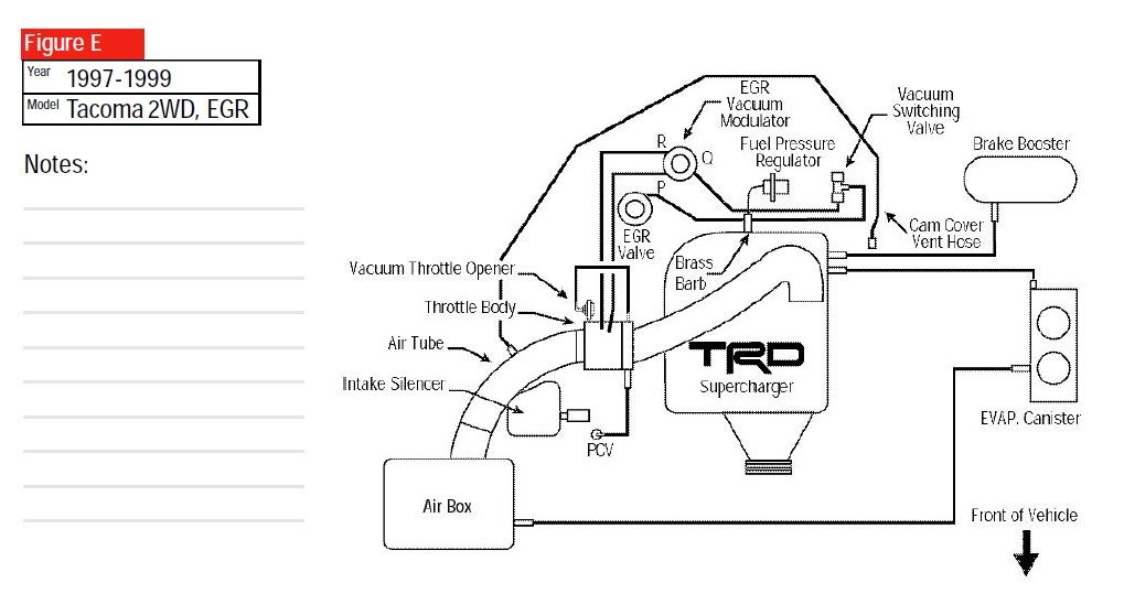

    Sweet!!!! Yeah that's the cam cover vent.
    Here's a lil helper if you still have issues. *Should* be the same for a 95
