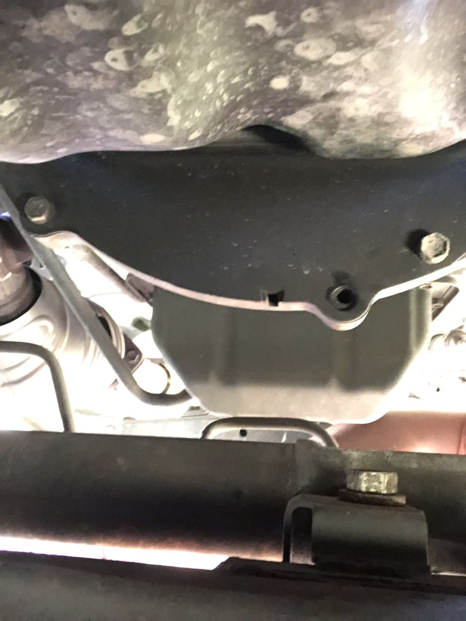

    I bought a 2000 preunner a few weeks ago, and currently am underneath it hand-cleaning old crud and gunk. I noticed a missing bolt on what appears to be the transmission. I'm not a well versed car guy. Anyone have 2 cents I could borrow? Do you know what bolt this is?

    Is the bold missing or has it been sheared off?

    Inspection plate bolt doesn't appear to mate to anything behind, You should be fine.

    Looks sheared off to me, you'd have to drill it out and tap chase new threads and then you can put a bolt in it

    Just an empty hole. Can't see threading at all, probably gunked, but no leak coming from it

    If it isn’t leaking let it be.

    I don't know what that hole is for, but it's not for a bolt. There are no threads in it, and there isn't anyting in it on my truck.

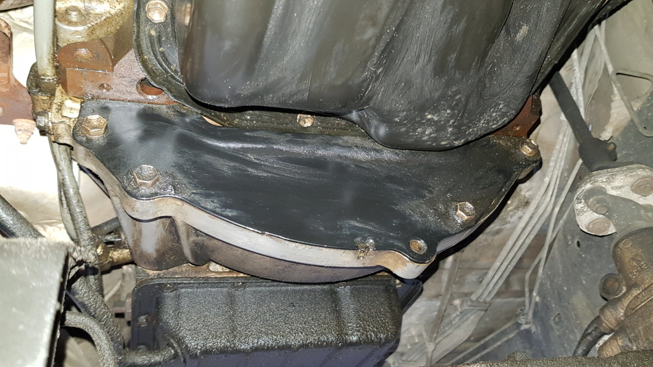

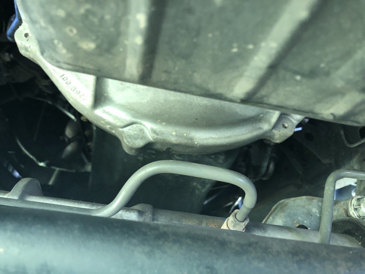

    I like to think my prerunner is pretty minty and it’s missing that bolt too.
    From the front it’s missing (first photo), from the rear (second picture) there’s not even a throughhole

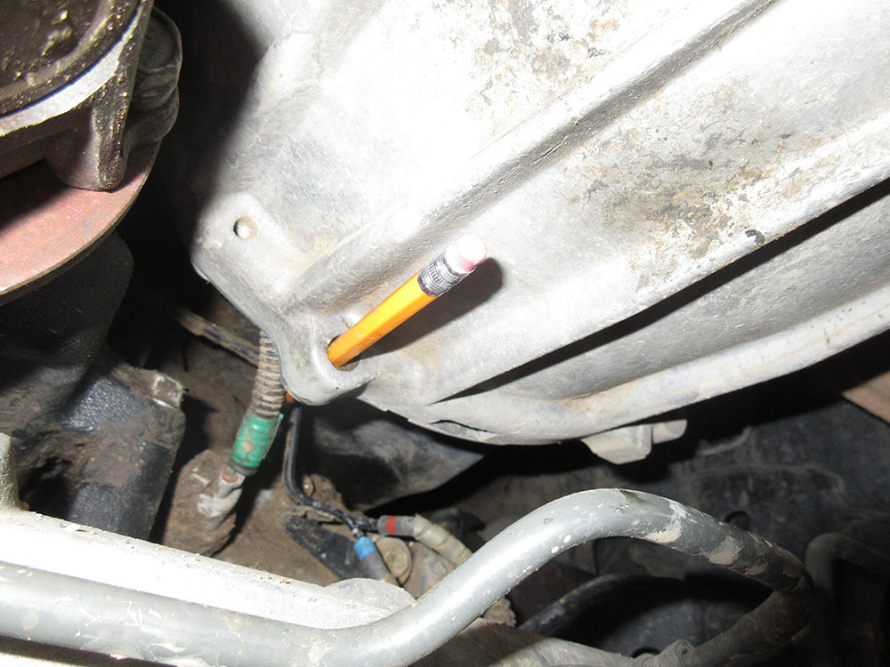

    Interesting, on mine it does go through.

    It's just an inspection cover. You can remove all the bolts and use duct tape if you really wanted to. It's just there to keep crap from flying into the tranny.
