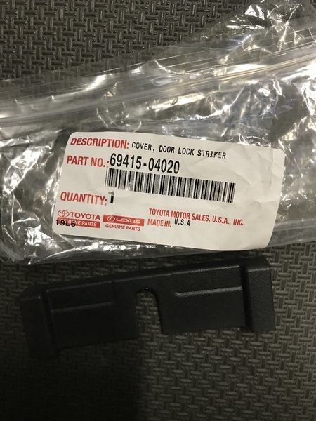

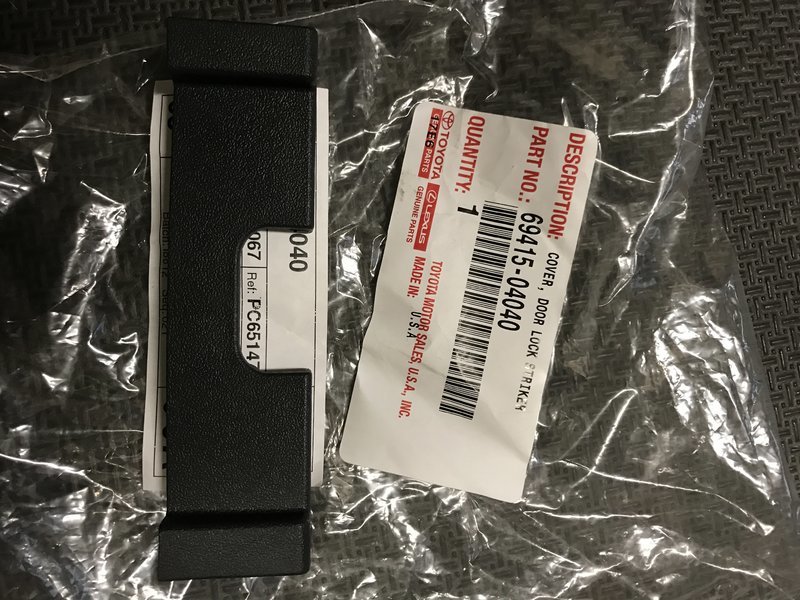

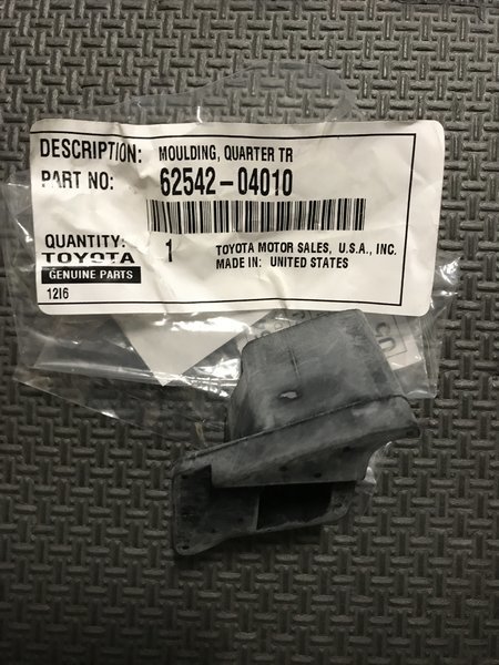

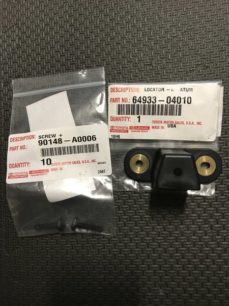

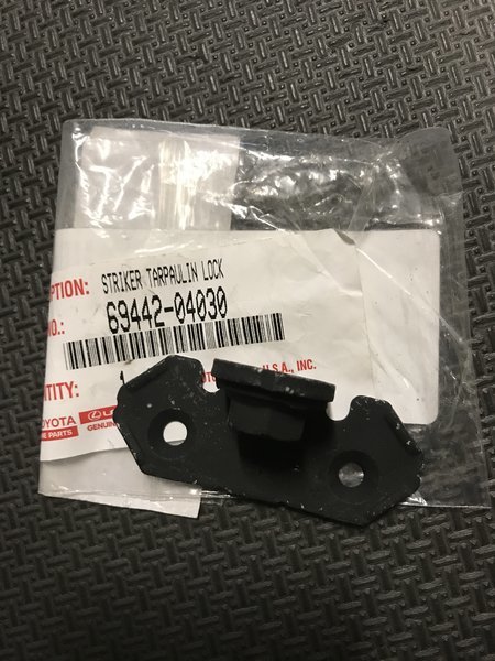

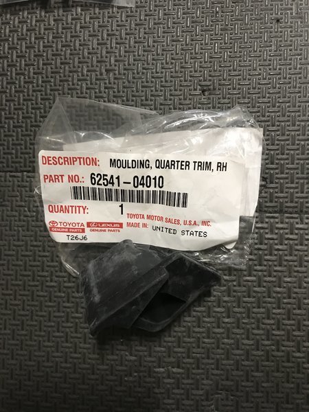

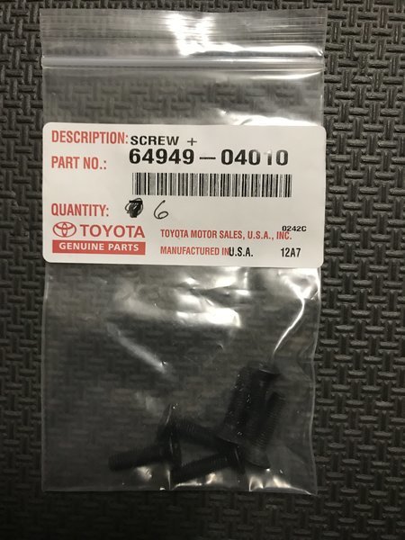

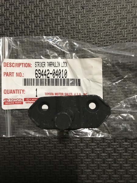

    62541-04010 SIDE PANEL CAP - 1
    62542-04010 SIDE PANEL CAP - 1
    64933-04010 FRONT REINFORCED PIN - 1
    90148-A0006 SCREW HEXALOBULAR - 2
    64949-04010 FASTENER TONNEAU COVER - 12
    69442-04030 STRIKER(NO.2) - 1
    69415-04040 STRIKER COVER(NO.2) - 1
    69442-04010 STRIKER(NO.1) - 5
    69415-04020 STRIKER COVER(NO.1) - 5
    BED RAILS YOU HAVE TO CUT YOURSELF. I DON'T HAVE THE PART NUMBER FOR THE BOLT THAT GOES THROUGH THE FRONT PASSENGER MOUNT. MINE CAME WITH THE COVER I BOUGHT.

    I bought them online from Titus Will Toyota. Amy discounted online parts dealer will work that's in your part of the country. Just order the parts you need with confidence. I will include images to make it easier for anyone to envision.IMG_1541.jpg IMG_1540.jpg IMG_1542.jpg IMG_1543.jpg IMG_1548.jpg IMG_1545.jpg IMG_1546.jpg IMG_1547.jpg

    $214.22 with the front seals w/o shipping. Front seals are $25.68 each. You would have to cut your own rails. Did they sell you the cover from another truck? If so that truck has all the hardware and cut rails you need. How much did they charge you for just the cover anyway?
