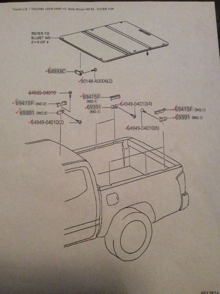

    Got bored and priced everything out including the 3 tonneau sections:
    Tonneau Cover
    Part Number: 64903-09010
    Remove
    $159.20 $159.20
    Tonneau Cover
    Part Number: 64902-09010
    Remove
    $159.20 $159.20
    Tonneau Cover
    Part Number: 64901-09010
    Remove
    $215.68 $215.68
    Striker Cover
    Part Number: 69415-04040
    Remove
    $8.09 $8.09
    Striker
    Part Number: 69442-04030
    Remove
    $17.58 $17.58
    Striker
    Part Number: 69442-04010
    Remove
    $15.28 $76.40
    Striker Cover
    Part Number: 69415-04020
    Remove
    $7.84 $39.20
    Side Panel Cap
    Part Number: 62541-04010
    Remove
    $25.68 $25.68
    Side Panel Cap
    Part Number: 62542-04010
    Remove
    $25.68 $25.68
    Front Reinforced Pin
    Part Number: 64933-04010
    Remove
    $4.65 $4.65
    Screw Hexalobular
    Part Number: 90148-A0006
    Remove
    $0.75 $1.50
    Fastener Tonneau Co
    Part Number: 64949-04010
    Remove
    $2.82 $33.84
    Protector
    Part Number: 66249-04070
    Remove
    $97.40 $97.40
    Protector
    Part Number: 66248-04070
    Remove
    $97.40 $97.40
    $961.50 + tax + shipping. The bedrails kill the shipping increasing it by $100. Curious, does the trifold sections include all the gaskets or are these also bought separately? I saw this PN 64917-04010 from https://www.tacomaworld.com/threads/2016-tonneau-cover.480897/#post-14659218

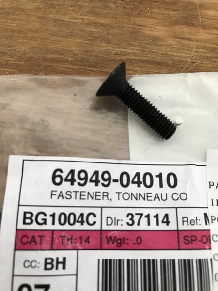

    From my measurements, these screws are countersunk M6 25mm pitch 1.00. If you want to saveyourself for$30.
