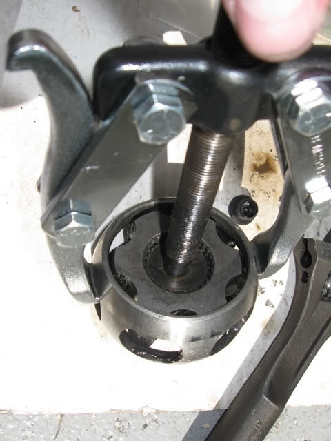

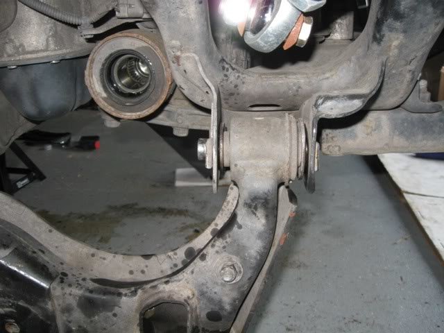

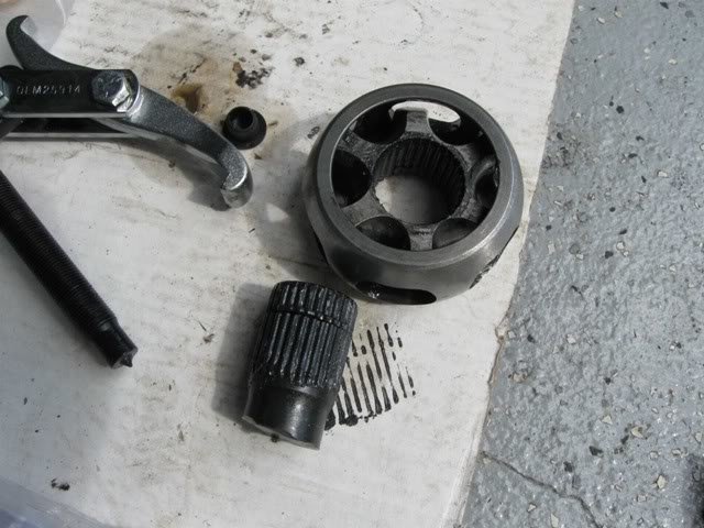

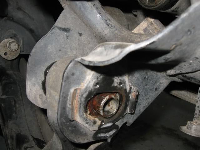

  11. Jun 7, 2009 at 6:21 PM
    #191
    mjp2
    mjp2 [OP] Living vicariously through myself Moderator
    Feb 16, 2007
    #924
    22,016
    Milton Juevo Portimous II
    NJ
    Current: '21 Bronco Badlands. Previous: '06 TRD Access Cab, v6, 6-speed
    I got the axle out of the outer CV joint cages but it took a 50 ton press. This is no joke. The 20 ton press could not budge the thing and the 50 ton press was slowing down before the internal c-clip finally let go.
    Once that clip was dislodged I was able to press the axles out with a standard puller.
    I finally dropped my skidplates, continued disassembling the front passenger side suspension, and ran into a snag. The bolt holding the front of the lower control arm in place is seized within the LCA. I suspect it's something else I broke last year when I while testing at Barstow but I won't know for certain until I get the whole assembly cut apart and inspect it.
    In itself this doesn't sound like much of an issue. A sawzall will make disassembly a breeze, but that bolt controls wheel alignment. With it frozen within the LCA the alignment would change as the suspension cycled. Eventually the tabs that keep things in place bent, so those will need to be reinforced and/or replaced along with the LCA alignment bolts.
    Yet another job to add to the list...
