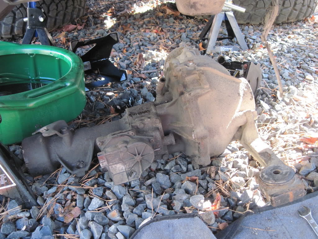

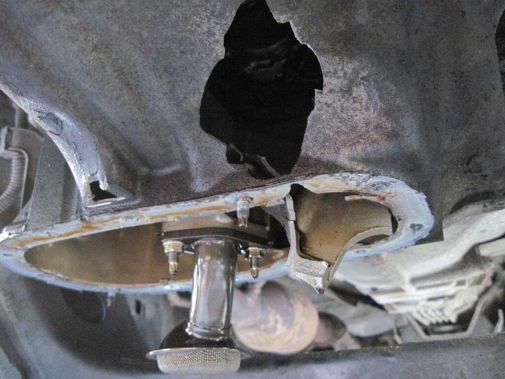

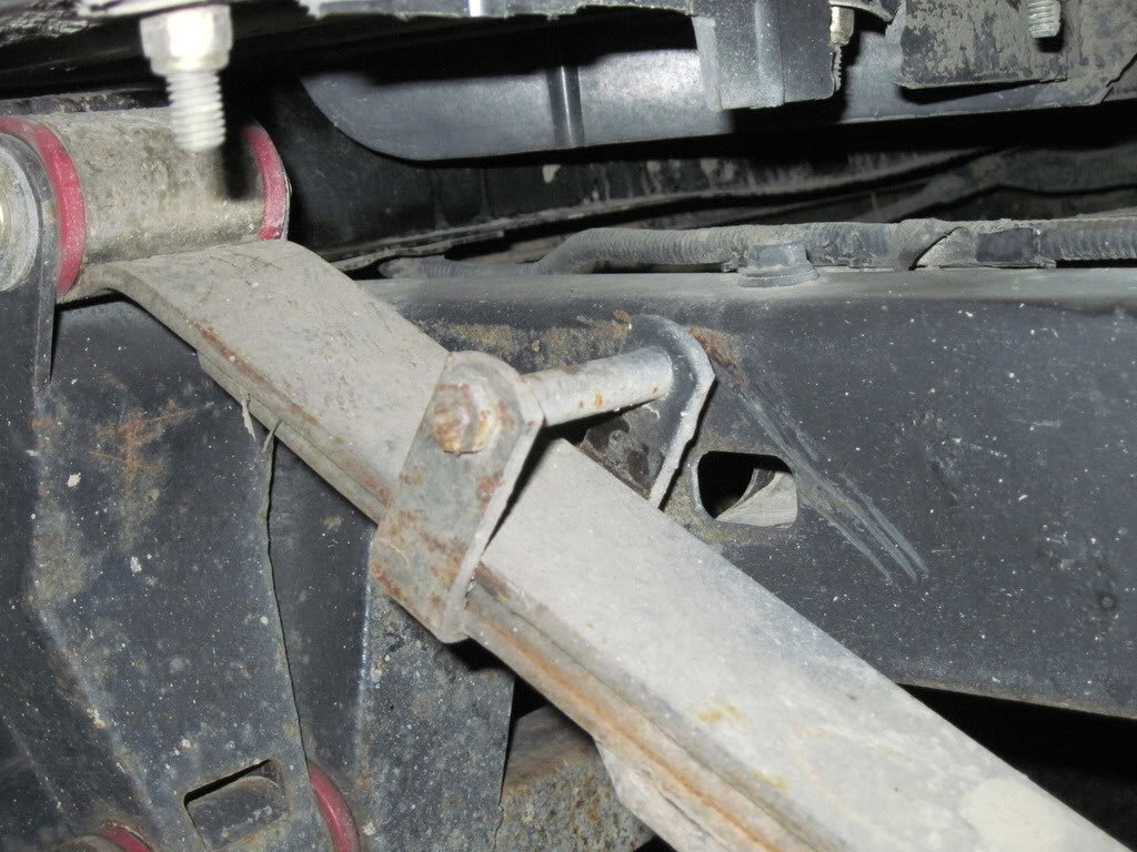

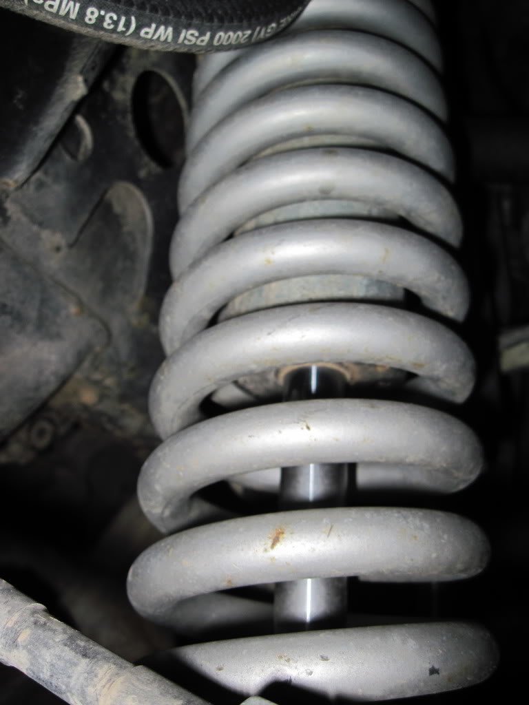

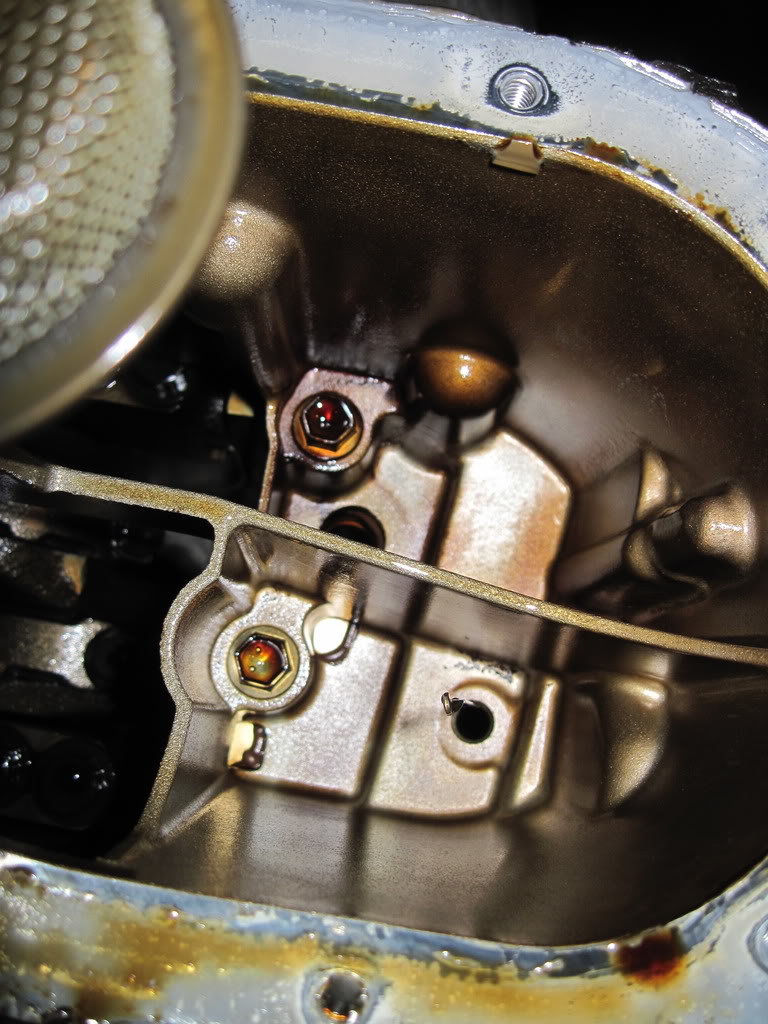

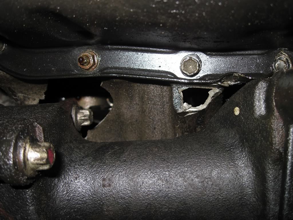

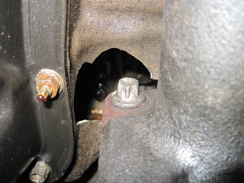

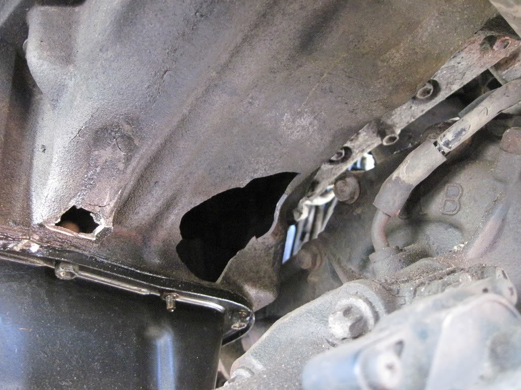

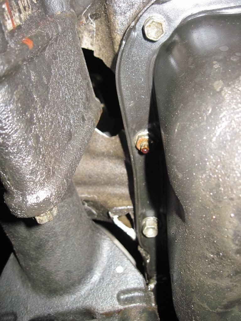

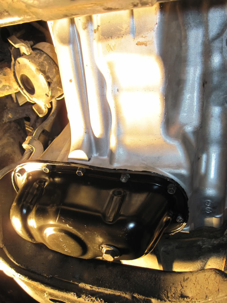

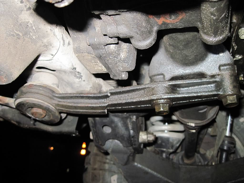

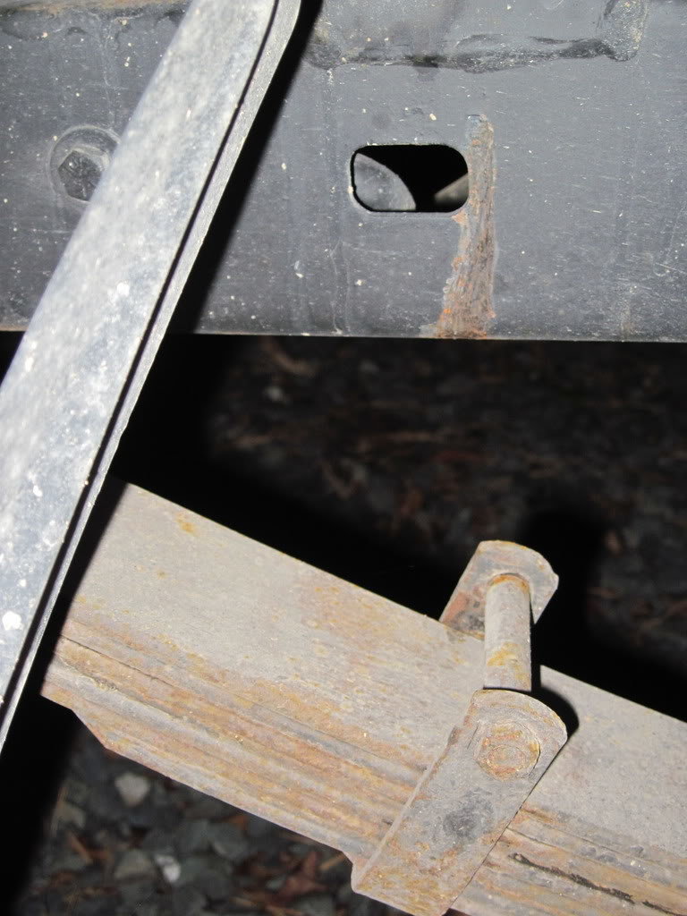

    Post race review of the truck:
    I had some coil binding on the driver's side. I'll be switching to 18" 650lb coils this winter.
    Mounting hardware for the rear leaf springs were rubbing the frame. I also wore out the rear springs so I'll have some custom ones made over the winter as well.
    The torque arm/driveshaft skid worked flawlessly and saved me in the rock on the Primm course.
    Broke a front differential mount.
    Bent my lower oil pan and shattered my upper oil pan when the differential hit them.
    Had to remove the front differential and steering rack to replace the oil pans, but fortunately the job was possible with the engine remaining in the truck.
    Everything's nice and shiny now.
    Nice to have the truck back on the road again!
