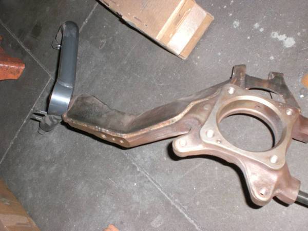

    You could use a set of these:
    These are fully boxed tig welded fj/taco spindles that sdhq did for the luxury prerunner FJ they are building

    That's really sweet! To run those I'd have to upgrade to heims on the steering linkage to work with the double-sheer setup. Far stronger than the stock rod ends.
    So far I've been fortunate enough to not break a tie rod end. Still, I always keep a spare in the truck for a quick repair if needed.
    The latest version of the TC spindle gussets look similar and have a piece that reinforces the steering arm on the spindle. As a short-term, cost effective option I'm going to get those for my spare spindles and see how everything looks.
