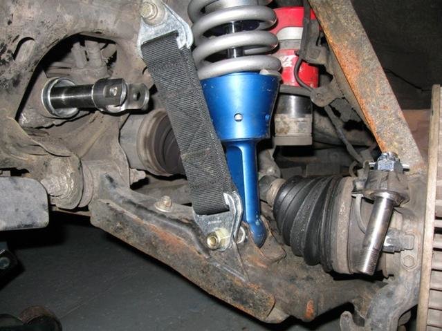

    My new parts arrived from All Pro. The bolt on the left is machined to work with the rack & pinion on my truck.
    As it fits in the kit:
    They also shipped me their long-travel rod ends (on the right) to avoid binding when pushing my suspension.
    The machining on this piece is amazing.
    And a silly thing here. Installation of this kit was justification to get a new BFW. :)

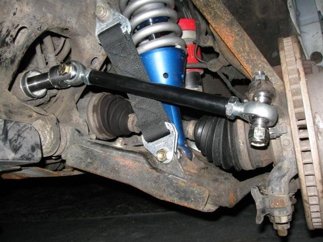

    Back on the truck, things came together quickly.
    Installed, minus the cotter pin at the wheel end. I'll install that after re-torquing everything.
    The passenger side came together quickly. Both sides can probably be done in about an hour.
    Now it's a matter of getting an alignment and I can get back to bashing on the truck again.

    Isn't there a rubber boot missing?

    Not on this kit. That boot is to keep dirt out of the pivot ball on the old linkage and isn't needed.
    Would probably be a good idea to cover that area regardless, but the stock boot can't be removed without destroying it.
