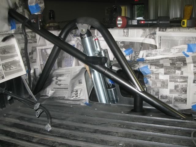

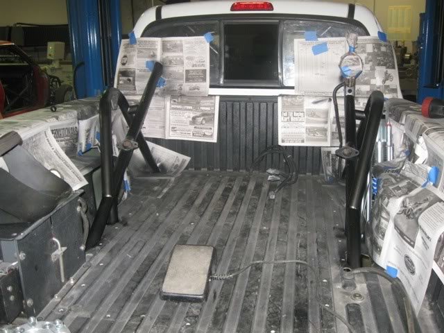

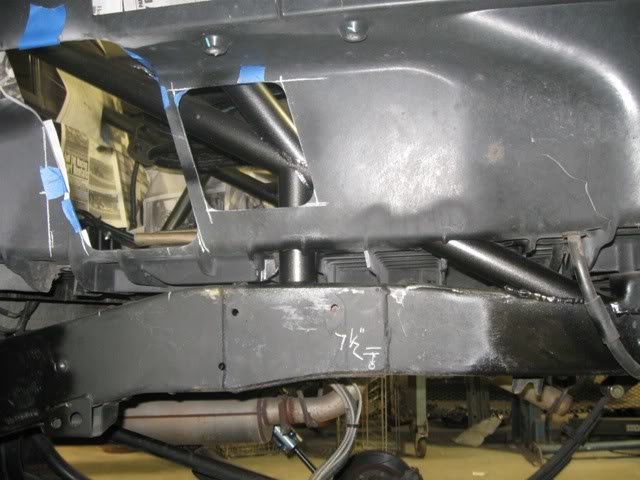

    The long-travel conversion is still underway.
    The new rear shocks required new upper shock mounts for both circumferential clearance and travel. The new upper hoops will be tied together when complete.
    SCORE felt that the downward bends in the rear support tubes would compromise the structural integrity of the cage and requested that things be redesigned. The updates involved cutting and welding a sleeved straight tube to the end of each rear support tube. The new shock hoops provide additional support by tying middle sections of the support tubes to the frame.

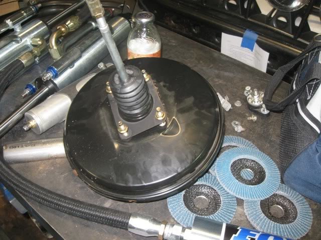

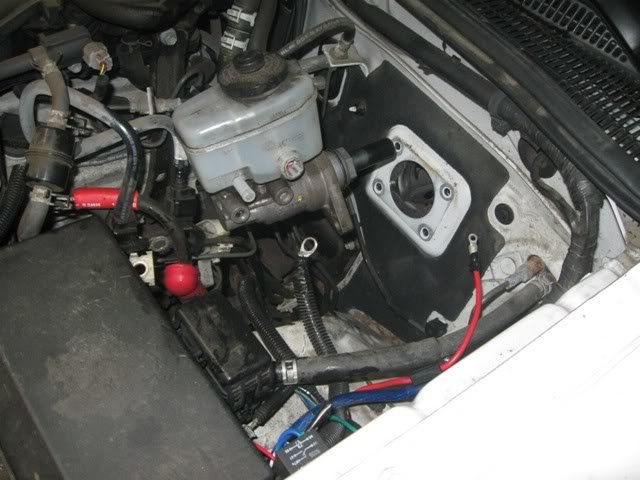

    The factory master cylinder, power brake booster, and ABS controller are removed to fit the soon-to-be-fabricated upper shock hoops for the secondary bypass shocks. This is a change that was on the to-do list to improve braking performance with the rear discs so the timing worked out well.
    Removing the booster with a rollcage made for some interesting inverted wrenching. For those interested, it's held in place by 4 nuts accessible from inside the cab. :)
