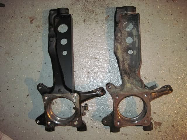

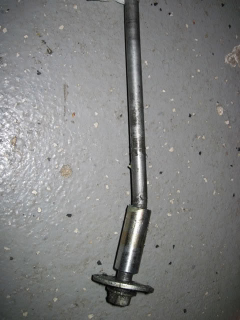

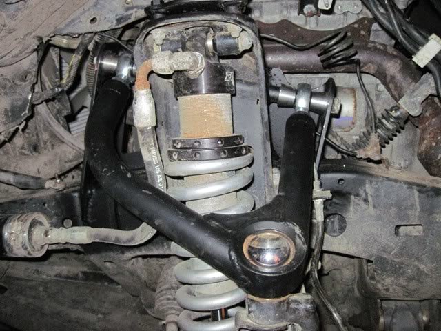

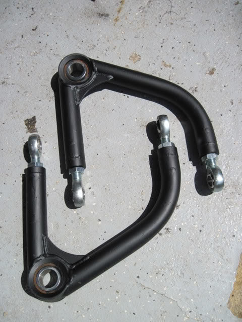

    The front end is being repaired and beefed up. I bent a spindle and an upper control arm mounting bolt last time I was out.
    Since that's the second UCA bolt I've bent, the mount for the UCAs is now double-sheer using Total Chaos' coil bucket gussets. They also gusset the coil buckets, obviously, which is a good thing since my passenger side coil bucket is already tweaked.
    I also had the Camburg LT UCAs modified with heim joints to give me more flexibility when aligning the front end.
    It's a shame to see the condition of the shocks on my truck after a single winter here in NJ. The roads are insanely oversalted and everything prematurely rots.
    Those shocks don't even have two thousand miles on them. The bypass shocks are just as bad. :(
    I'm envious of the guys in the desert who don't even have to paint their roll cages. Keeping ahead of rust is a constant battle around here.
