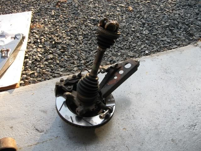

    What a weekend. I did pretty much everything backwards but still managed to make a lot of progress.
    This:
    Turned to this:
    With this set aside for disassembly:
    Then this happened:

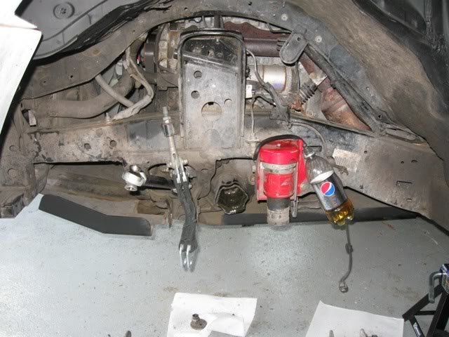

    Then I removed the outer part of the inner CV joint and realized that I forgot to remove the skidplates and drain the front differential. :annoyed:

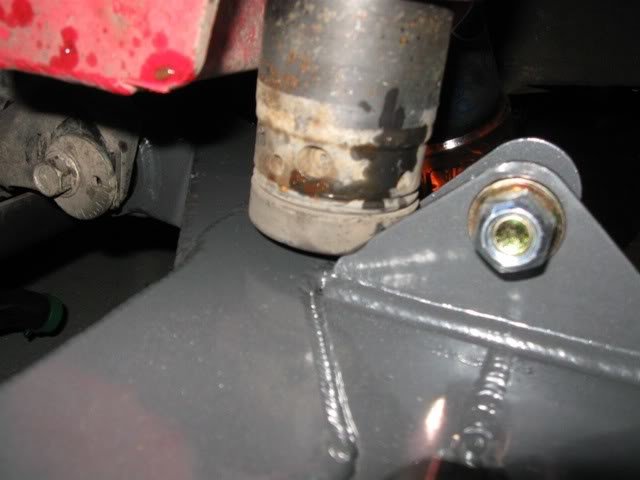

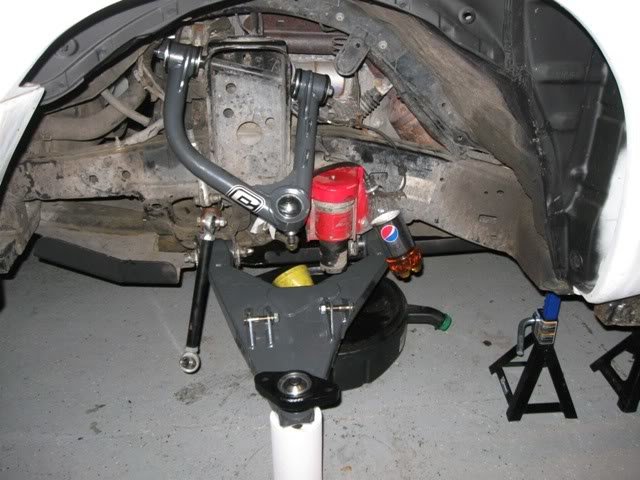

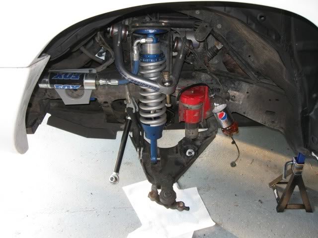

    While that was draining I installed the new control arms.

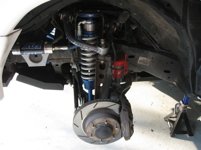

    Unfortunately the jounce shocks are going to have to be moved and/or replaced. They interfere with the lower mounts for the secondary shocks and will most likely hit the secondary shock bodies.

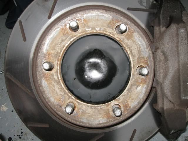

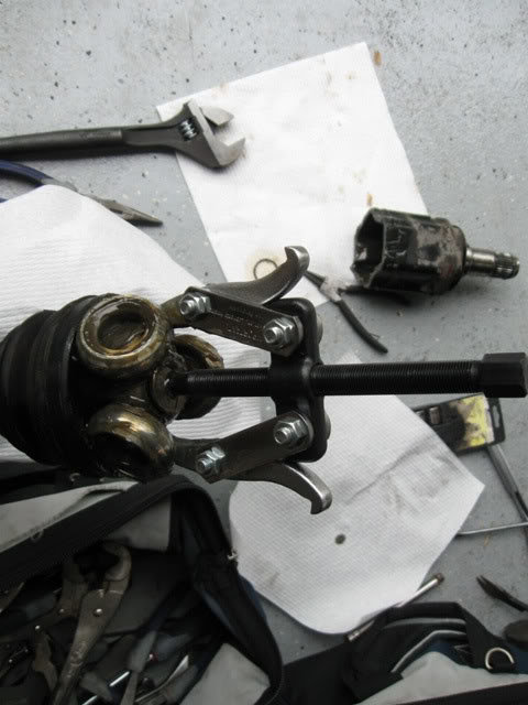

    Back to disassembling the 4x4 axles, the inner CV tripod comes off easily after removing a snap ring using a standard puller.

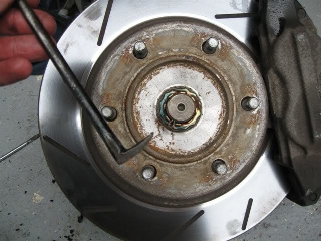

    To remove the axle shaft from the spindle, start by removing the metal dust cover. I used a small screwdriver and hammer to start the process.
    This little pry rod works wonders once there's enough space to fit it.

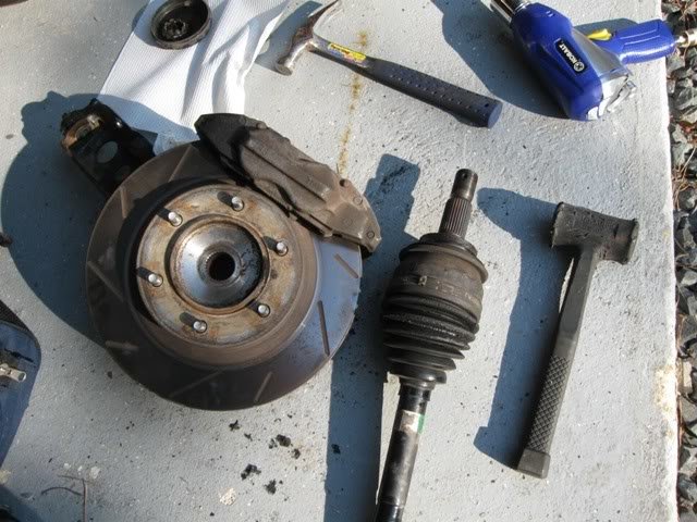

    After a dose of PB Blaster I used an impact wrench to remove the 35mm nut on the end of the axle shaft. A shot or two with a dead-blow hammer knocked the axle free. This, of course, was easier on the passenger side as I did it while it was still installed on the truck. :eek:

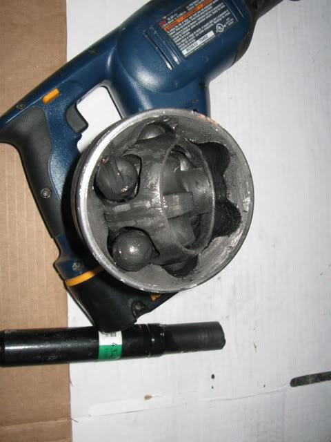

    Disassembly of the outer CV joints has been far from intuitive. Even the factory shop manual lists the outer assembly and axle shaft as a single unit. After banging, prying, pulling, etc., I finally decided to cut the shaft so I could rotate the joint assembly enough to remove the bearings and see how everything is assembled.
    I tried pressing the remains of the stub shaft out with no luck and that's where I stopped. I'm going to call Camburg tomorrow to get some insight on removing the stub shafts.
    On a 2wd truck this installation could easily be done in a day. The 4wd makes it a bit more complicated but it'll be worth it when it's all done. :)
