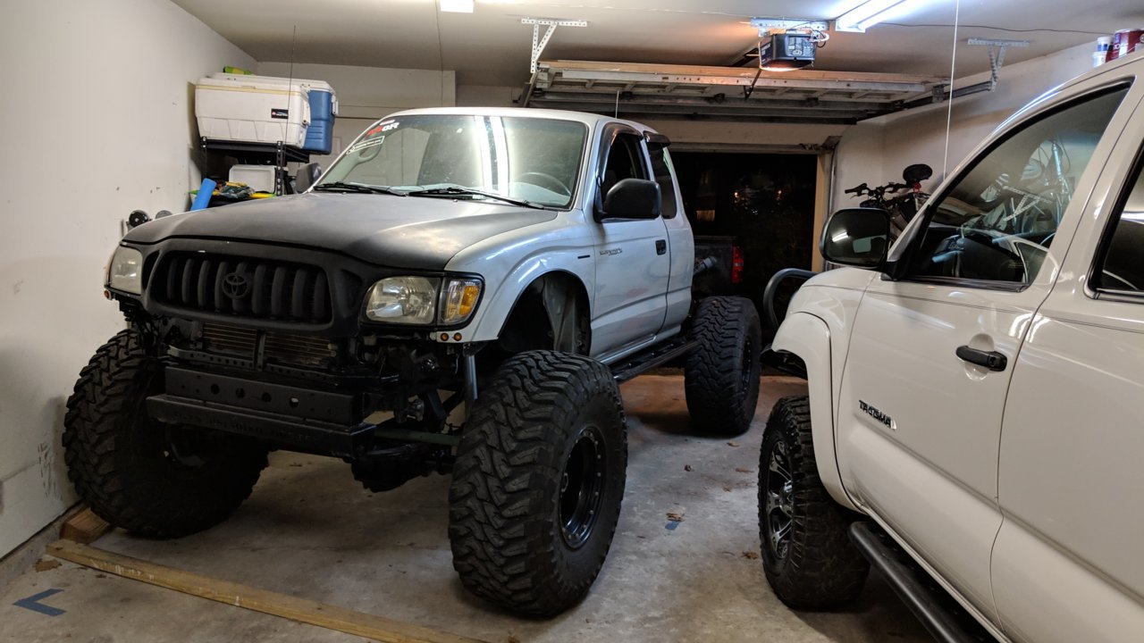

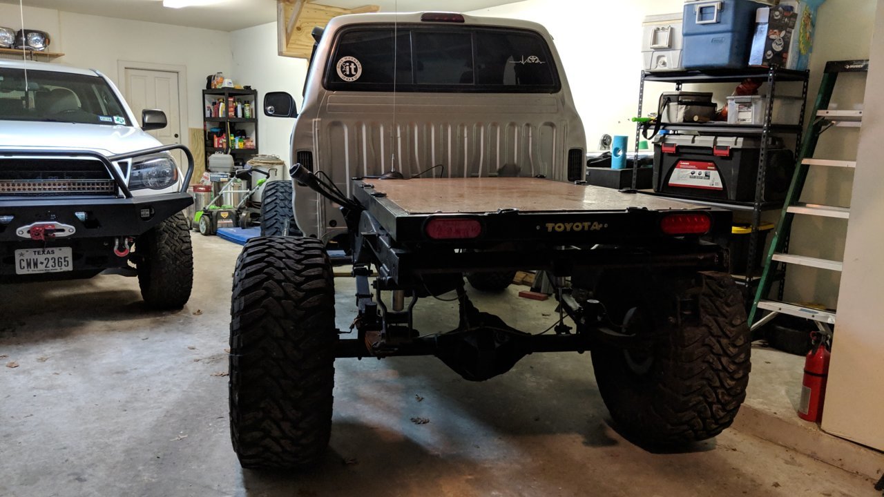

    Meet my new (to me) 2003 Tacoma SR5 Xtra cab:
    As she came 11/2018
    As she came 11/2018

    • Flatbed (custom)

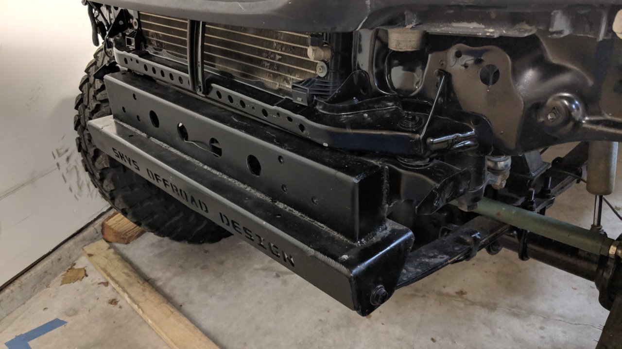

    1) Needs a front bumper and winch - not sure if the custom member welded onto the frame is compatible with the typical 1st gen mounting points? Will need to do some research here and may possibly need something custom fabbed. Note that there are no recovery points currently.

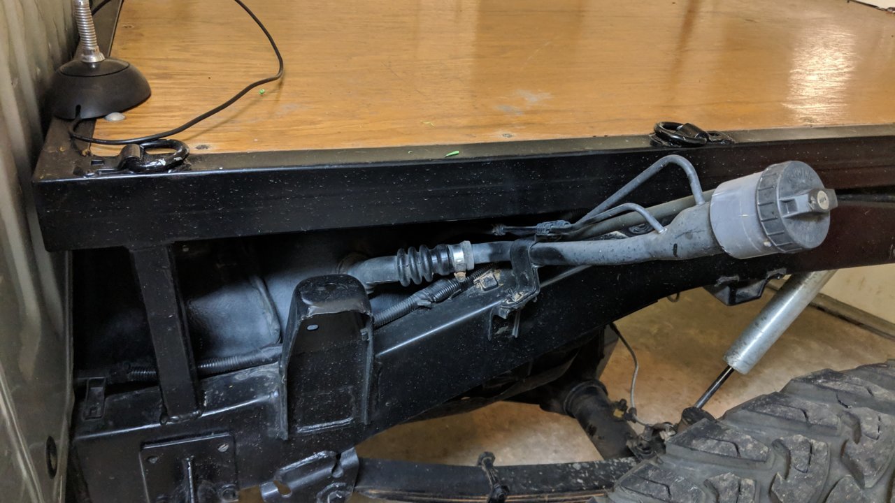

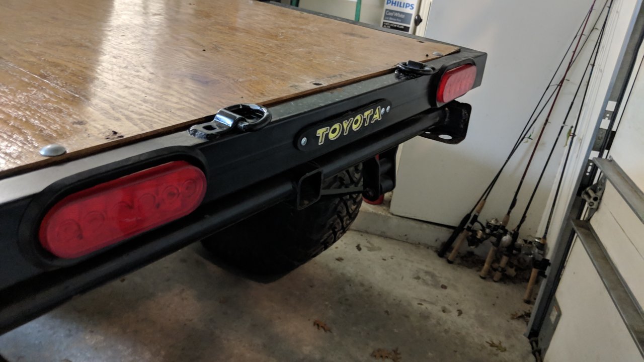

    2) Need rear recovery points added either to the flatbed (will require reinforcement) or add a heavy plate to the frame below. Some of the welding on the hitch is questionable as well, but it is so high it won't ever really be used anyways.

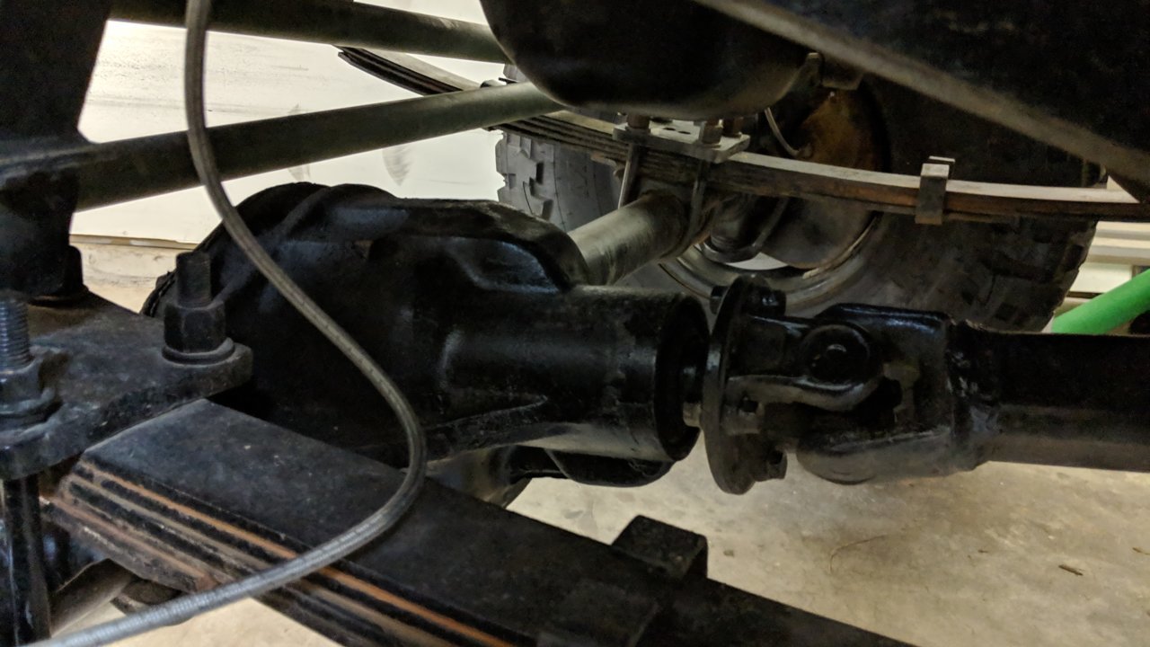

    3) Two things here a) install ARB air locker that came with the truck in the front axle and b) needs new springs or swap out for a 3-link setup. Current springs are about 1-2" from the bumps.
    4) Another two-for here a) move away from vulnerable factory tank and filler nozzle to a fuel cell and b) mount some kind of permanent CB antenna (current is just a magnet)

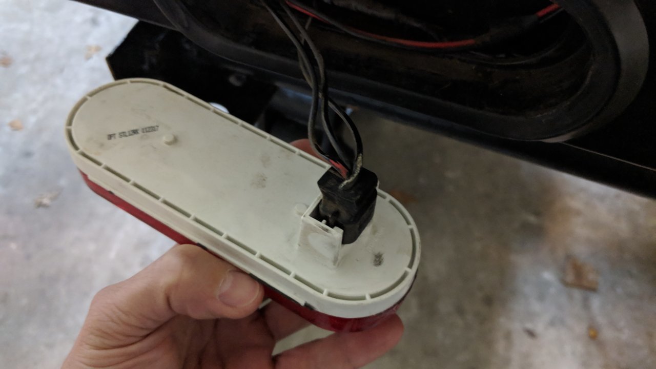

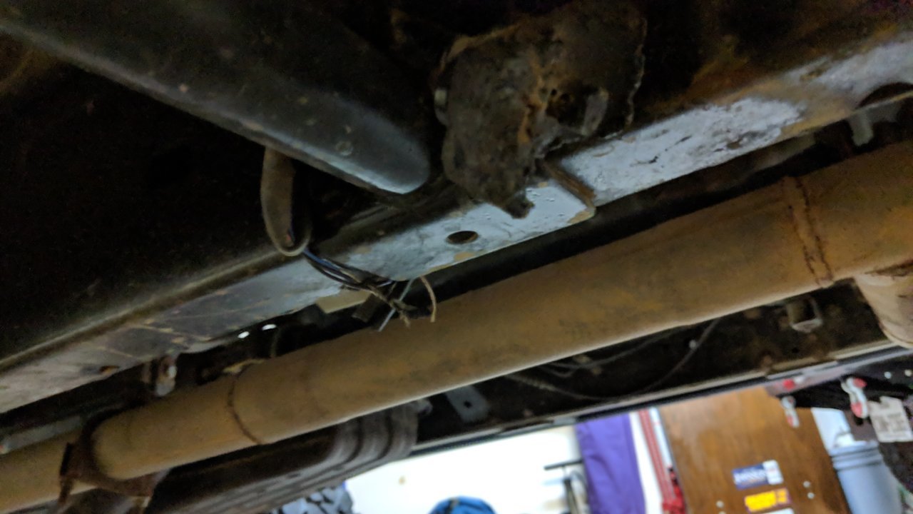

    5) Electrical system in general, truck needs a full inspection to remove/legitimize previous wiring jobs. Specifically a couple below I would like to remedy are pictured a) tail lights will eventually short out due to back of back clearance inside bed tube. b) Old oxygen sensor is still hanging out and wiring is frayed...there has to be a better way to do this, like unplug it or something. I would assume the tune got rid of the need for it.

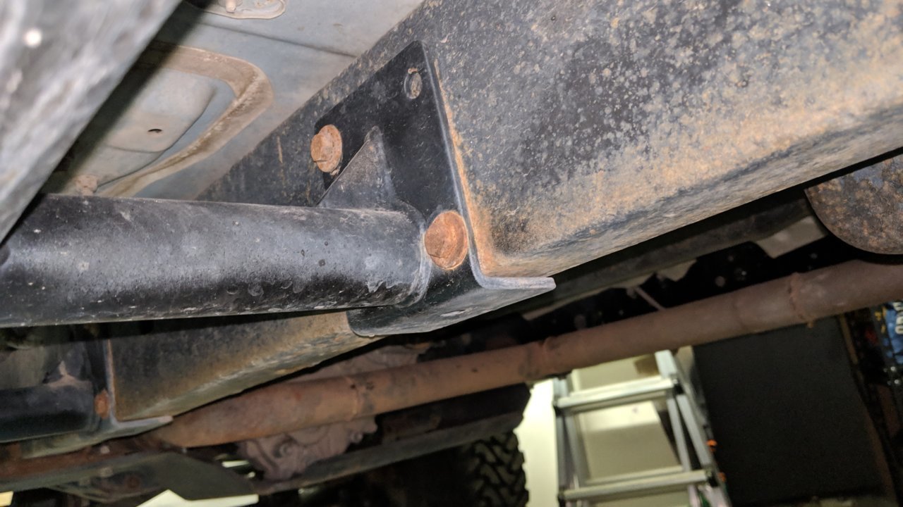

    6) Sliders are kinda bolted on currently, need to at the very least finish these or weld them on. Or exo-cage...

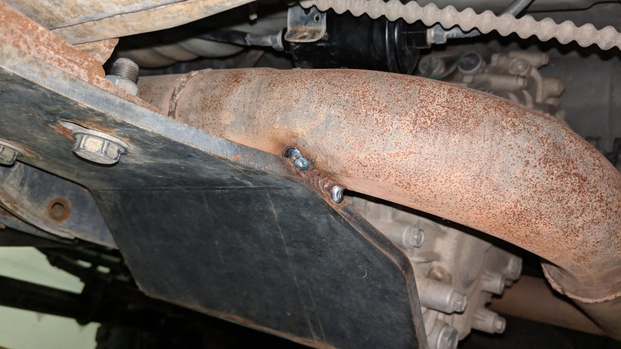

    7) Exhaust system is quite the amateur hour but could work for a while. T- is 90* and angles are hard, sizing is good though, certainly no real flow restriction. Also check out this sweet mount - I'm sure it wont tear itself off at all one day:

    I would just build a bumper out of tube off that front crossmember and use the tube as a recovery point. A winch plate and winch is also needed on there. Looks like a good start though, you are bypassing all the hard fab work!!

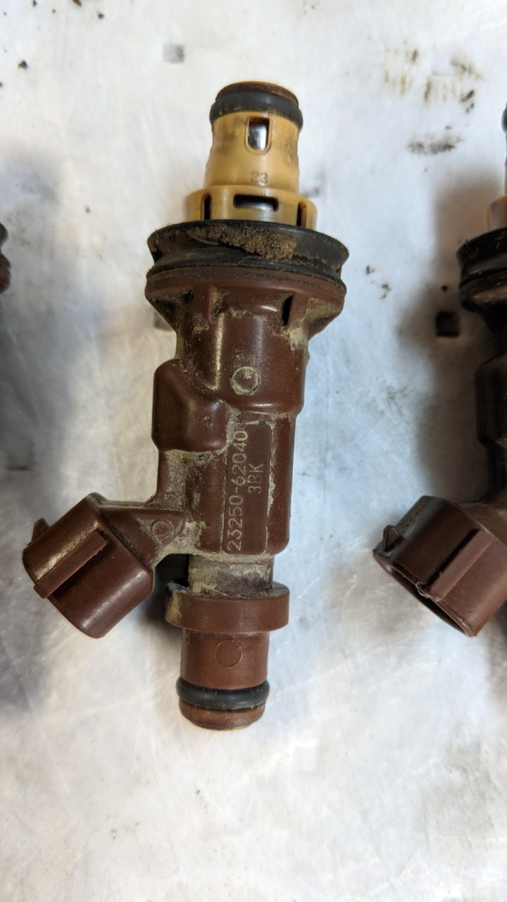

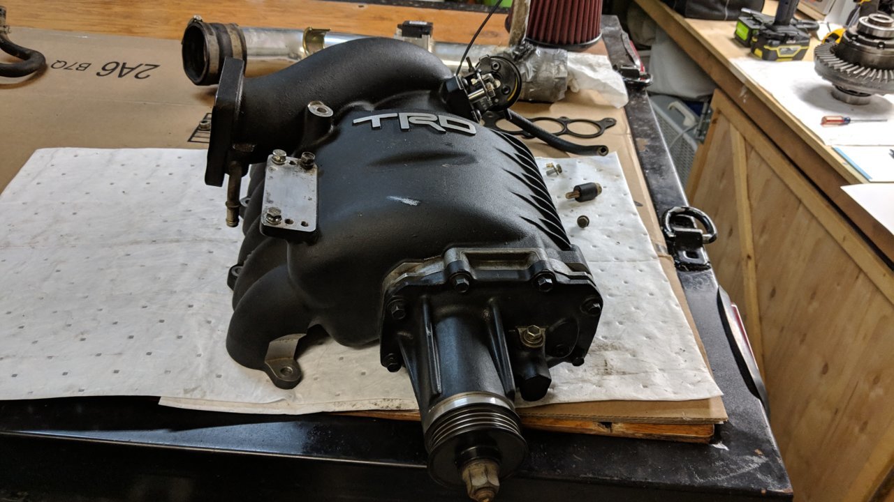

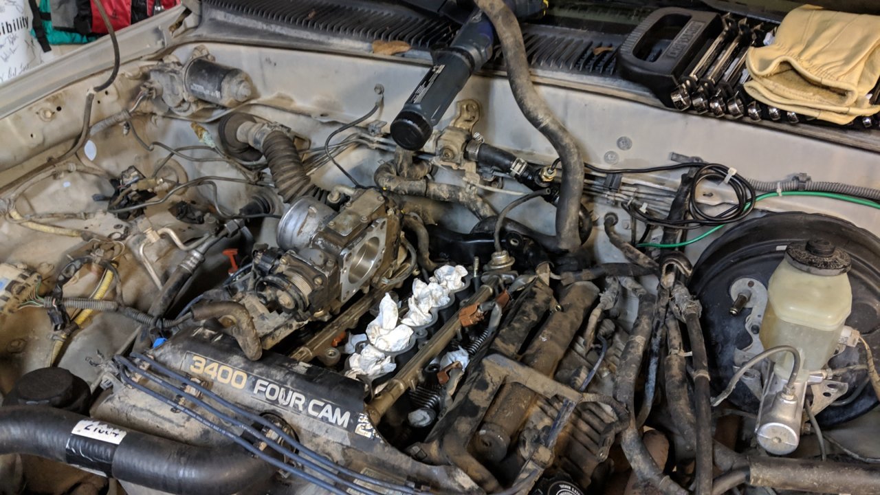

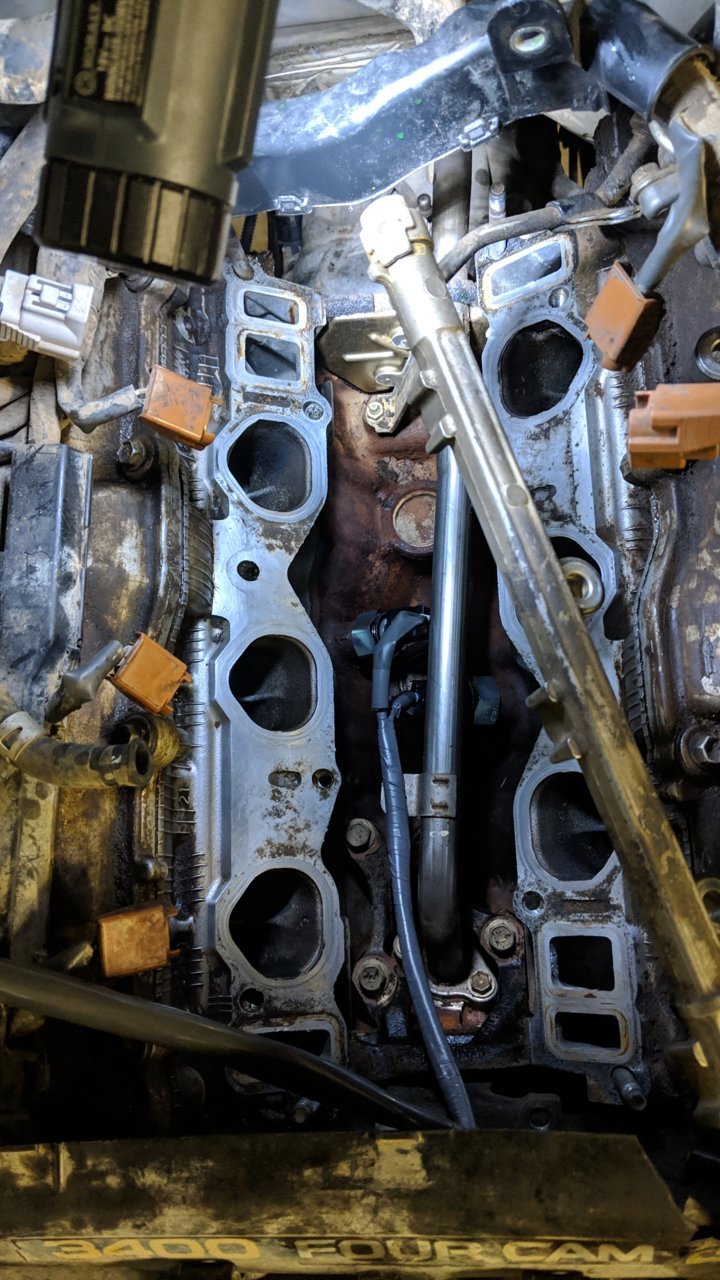

    Got down to work this past Sunday with a mission to replace the knock sensors with new OEM toyota sensors and wiring harness. Someone had already tried the tie the two together method so I got to reverse that as well. As with any project diving into the engine I forgot to order some of the needed parts...
    Got the TRD supercharger off and cleaned up - bearings feel good on it
    Eventually after much had wringing about taking the fuel injectors off, I finally took them off. Decided after a little research to keep the OEM ones and just get an injector seal kit, which should be in on Tuesday. I have since carefully masked, cleaned and removed the existing o-rings and grommets. They are ready for reinstall once the new seals are on.
    After removing the injectors and a couple coolant lines, it was pretty easy to lift the manifold out. I used the long bolt from the supercharger to help lift it out without damaging the surfaces. You can see the new knock sensors and wire installed here. While the heads and gasket surfaces still look really dirty...trust me they were way worse. Probably about 1/4" of oily mud/sand on top of the intake manifold. I am pretty certain this truck did some time as a mud truck.
    And here it is with the manifold reinstalled after being cleaned us as well.
    Holding there until the injector seals come in, then can finish up. Also I cut the heater hose in frustration/error so I have to splice that :anonymous:

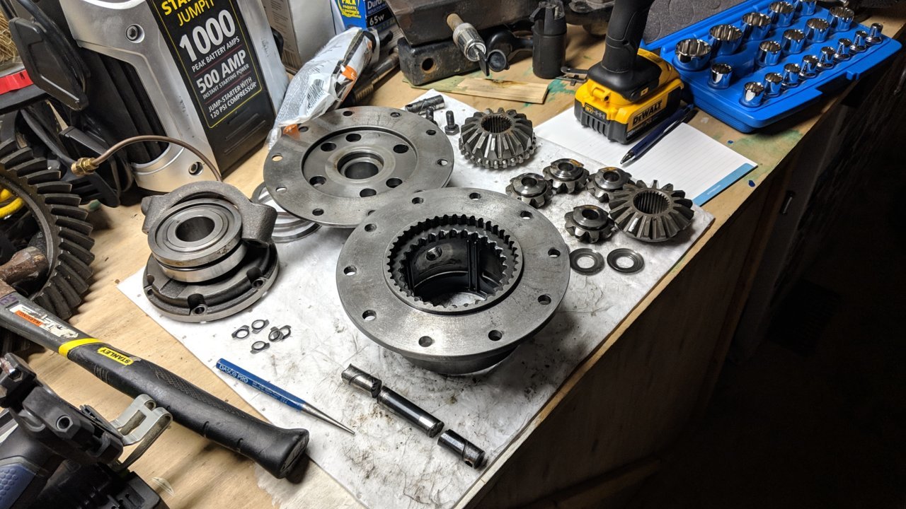

    I also got my spline drive sockets in so I busted down the Dana 44 ARB to take a look (it also needed grit cleaned out of it anyways). Very clearly it needs the long cross-shaft so got that on order.

    Since mine has that section welded on right below the normal bumper mounting point, my options were pretty limited. It seems to have the bolt pattern for the trail gear one so will see if that fits, if not it goes back to 4wp and something custom has to be made.
