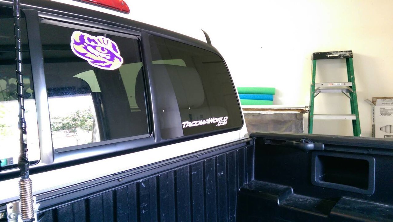

    Where did you ground your antenna? Mine is almost in the same location, but I need a better ground.

    It's grounded to the rail for ground plane as well as to the frame at the factory ground point above the shock mount.

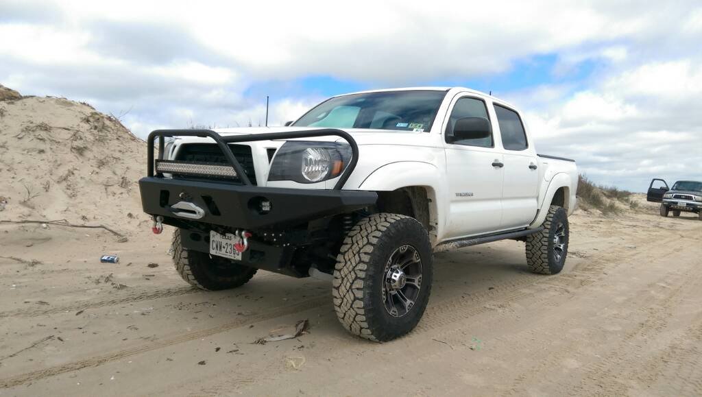

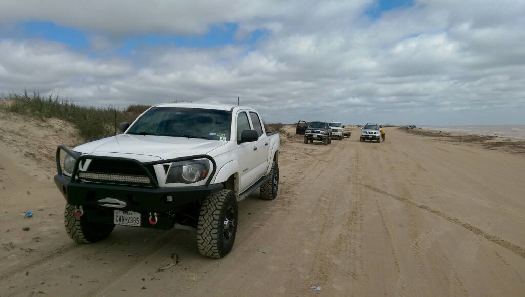

    Beach meet and run today at Bryan Beach. No good action shots yet, but I think some were taken. a9be5027c3eb86573ec592037a617fde_b5eef794dcfff0239b3e4ba0ea1eae72d9442847.jpg9ba2c49748d7a25dc76cbbd51875db37_d9e0f7dc17ec373311770efcb3e73b3528156ca6.jpg099d8daa0e0d108f6d9690679144fbd6_434573f9d374e129c2026bcb1c3e792904e1890b.jpg
