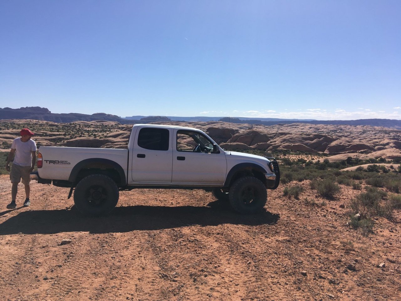

    here's a quick flex pick. I think its been 2 weeks since the lift was put on and the cv's are already slinging grease which I anticipated anyway but I was hoping they wouldn't since the weren't before
