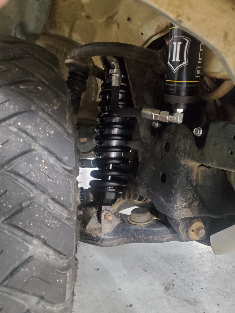

  2. Oct 26, 2024 at 7:31 PM
    #262
    mlcc
    mlcc [OP] Well-Known Member
    May 2, 2015
    #154429
    1,904
    Oregon
    2002 DC TRD/ 1995 4runner
    Mid travel, armour all around
    Put some Icons with 700lbs spring didnt have to adjust preload collar the ride height was exactly the same as the old bilsteins that just came off, and the bottom bushings on those were already wore out after 3 years or so.

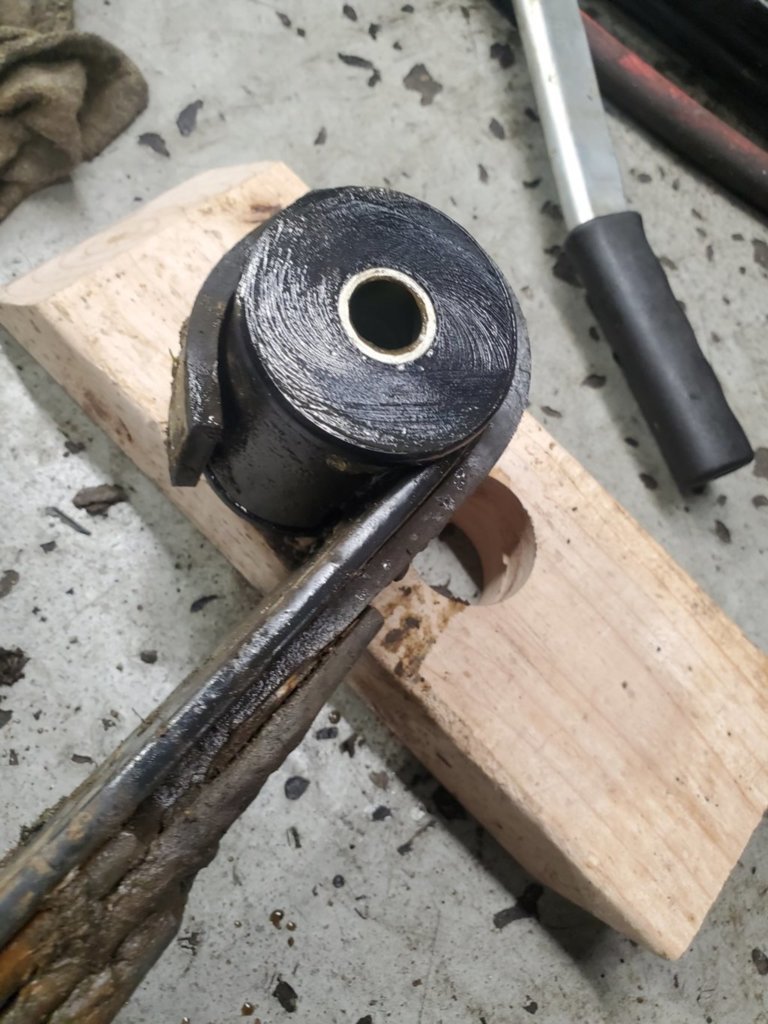

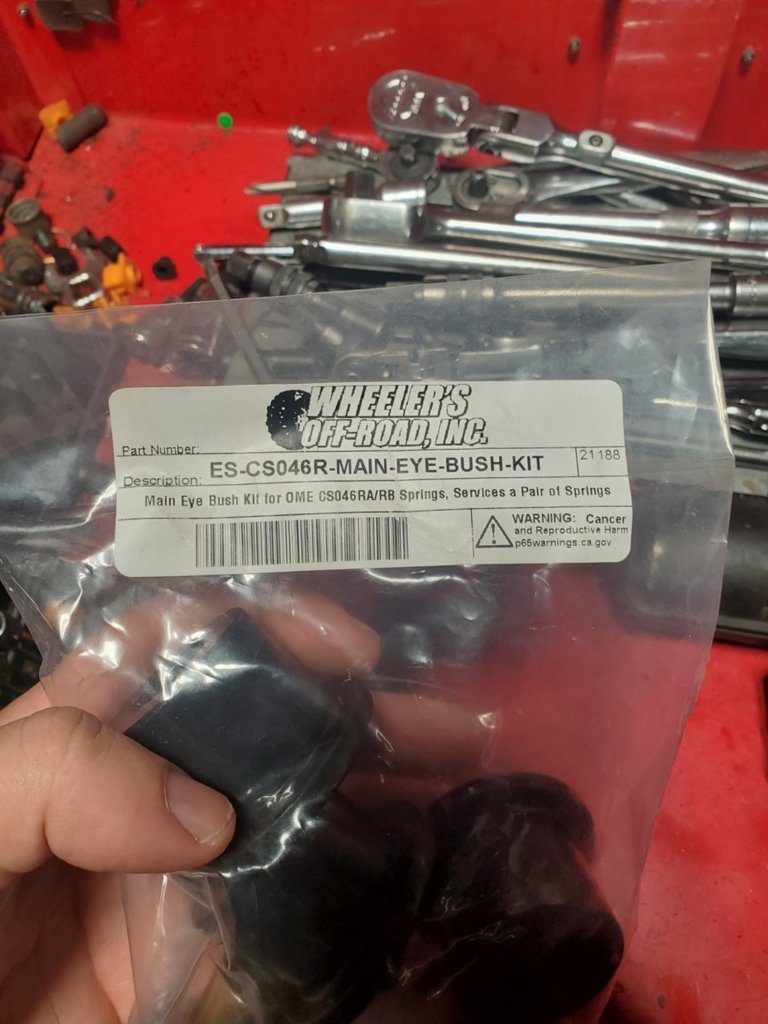

    Also putting this here for documentation purposes. Old man emu dakars leaf spring front bushing part numbers. Original bushing was rubber and was wore out making a bunch of noise. After much research found this and replaced the original bushing.

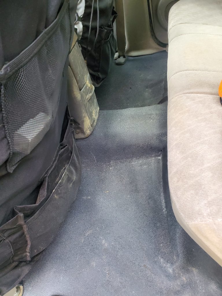

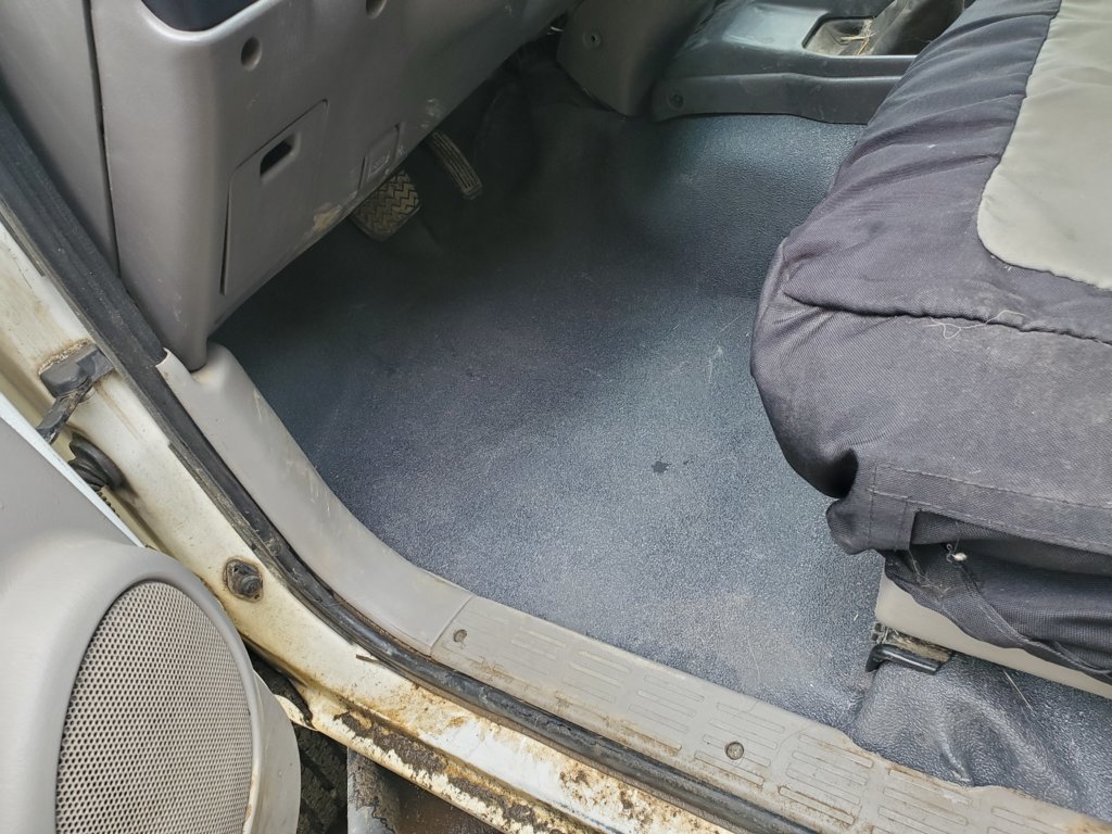

  4. Mar 30, 2025 at 5:47 PM
    #264
    mlcc
    May 2, 2015
    #154429
    1,904
    Oregon
    Replaced the carpet with vinyl. Ordered from autocarpet.com, now its not an exact fit and there are no holes for anything. Took some trimming and some heat gun action but its in.
