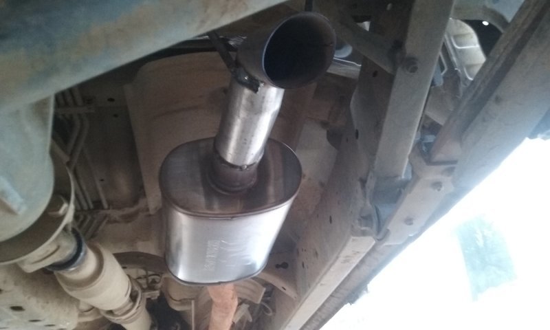

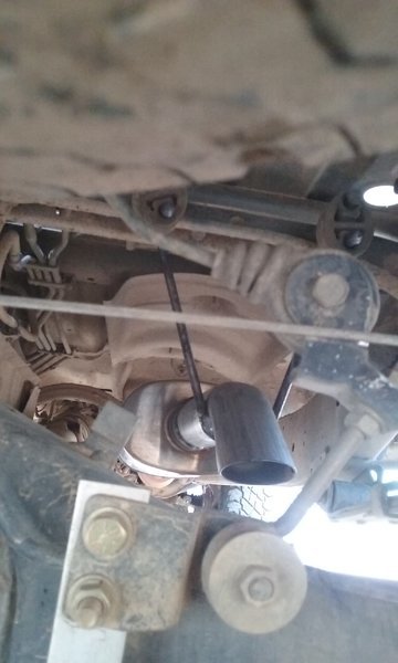

    Magnaflow muffler installed

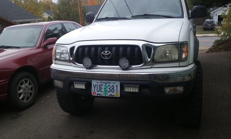

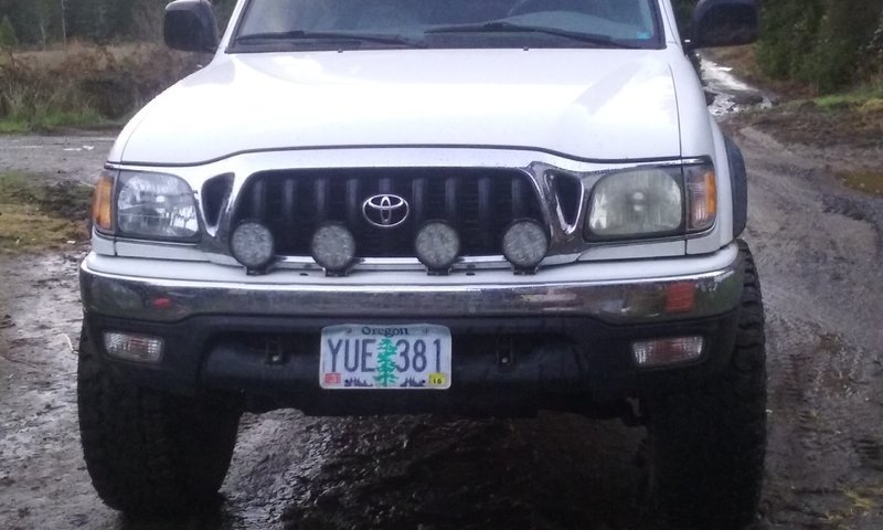

    Another pair of lights, these are round rough country 4in LED spot beams.

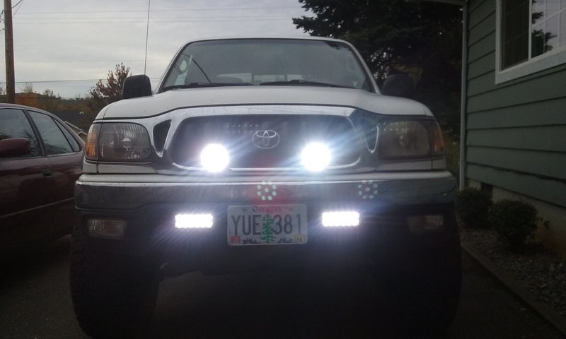

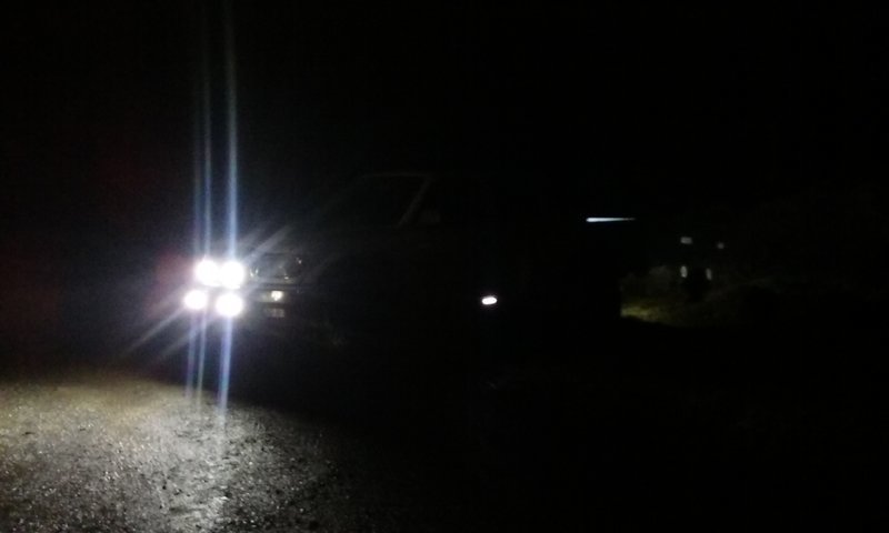

    Update: picking up material monday for bumper builds, removed rectangel LED lights and will run 4 of the round rough country lights, I already spliced and sodered two harnessestigether so these lights have one switch two relays and fuses. The rough country switch is ugly as fuck so ill be keeping my nice switch. I also attained a electric water pump from a prius and it can pump at a pretty good rate, so the thought hit me... I can have pressurized water at my truck when im camping, Freaking Awsome! now we can shower when camping!

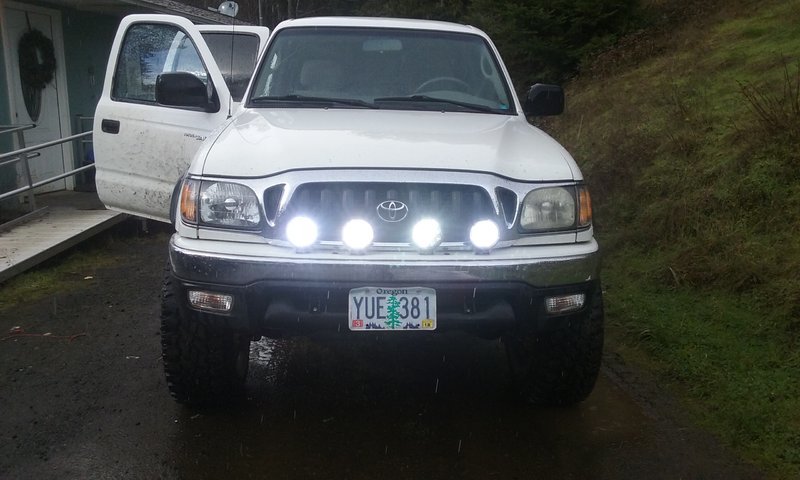

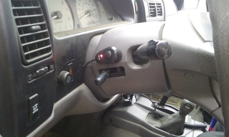

    New lights, got rid of the switch on the steering column and all 4 lights are on one switch in the center console.

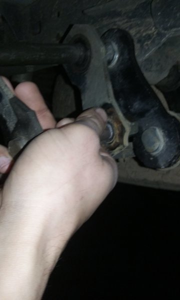

    Removed the chevy rear block and U bolts and used new toyota U bolts and replaced the stock shackles with some 2nd gen tundra shackles that are about an inch longer. I maintained the ride hieght achieved more travel and completey elimanted driveline vibes on take off and the drive shaft thump I was experiencing so im very pleased with that. And also ordered some OTRATTW switches in amber to match the stock color and also a kenwood radio that can also match the stock amber color, its going to be bitchin!!!

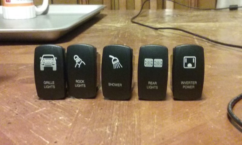

    Switches Bitches!!!
