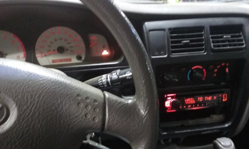

    Installed the radio but not the switches I ran out of time. The radio improved sound quality which I wasnt expecting

    But what about the check engine light

    Key on engine off

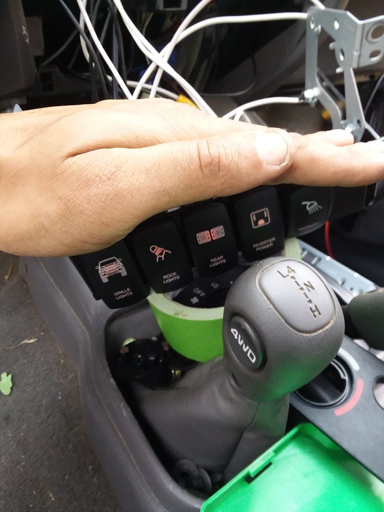

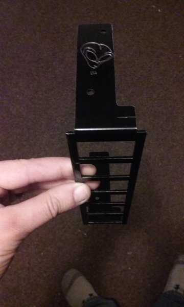

    This came in the mail now I can finally cover the hole and mount my switches

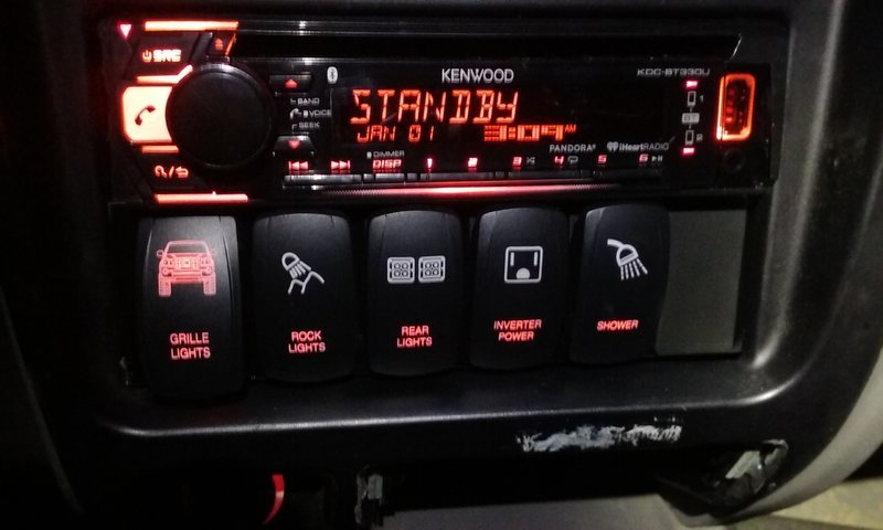

    Installed but the only switches that are hooked up to stuff are the rock lights and grille light switch. The next thing on the list is to make the shower electrical circuit and get a power inverter.

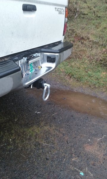

    Recovery ring

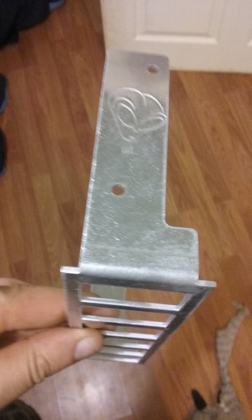

    Do you have a part number for the shock mount/ubolt plate. I heard that the earlier pickups were reversed from the tacomas. Is that where you got it?

    Yes the pickups are reversed, I sourced mine from someone on Craigslist parting out a 92 pickup.

    Probably the 4wd 6.5 bed as thats what most of them were. I got both left and right, I cut the left one and welded it to the frame practically OEM.

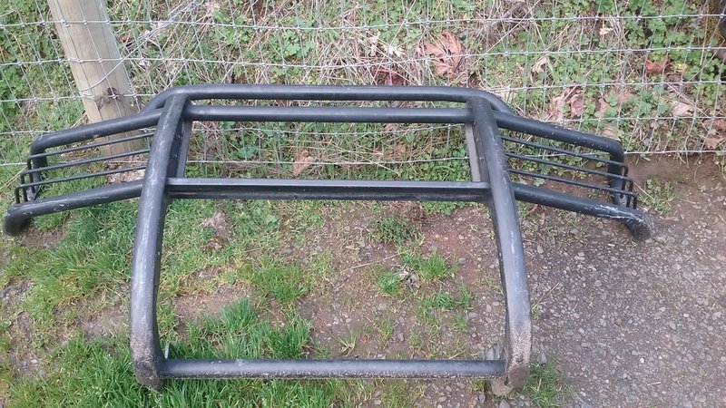

    Aries Brush guard and trail gear rock sliders

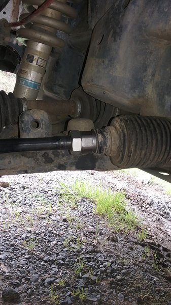

    Just replaced left inner tie rod now i have no sloppy steering and a straight steering wheel again. The new moog inner tie rod came with this massive 30mm nut.

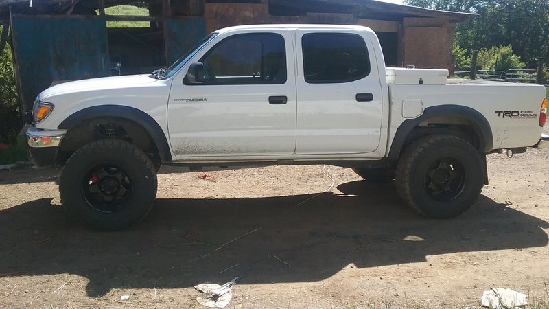

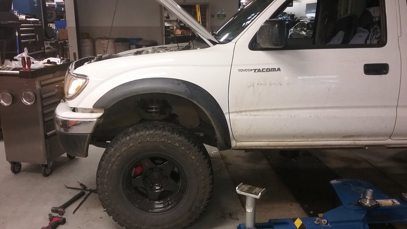

    Installed daystar 1in body lift. Will post more pics tomorrow.

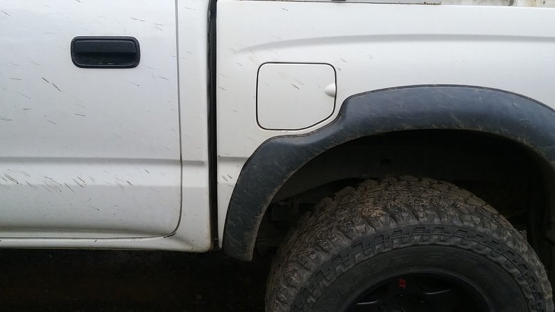

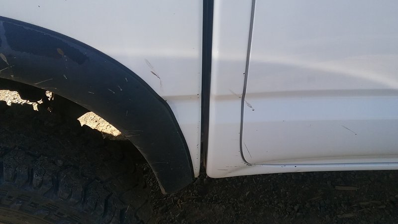

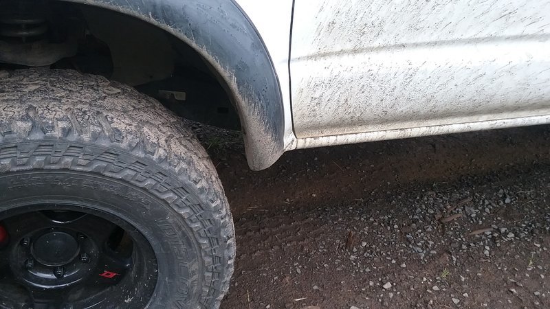

    Well the daystar 1in body lift is now completely installed, but I will say this the instructions are not 100% accurate neither is the hardware, but it fixed alot more then I thought it would, I no longer have anymore squeaks which is amazing, body roll is drastically reduced, and the tires no longer rub and I mean at all. Theres a picture of following daystars instructions you can see the body lines dont match up and then theres mlcc's way with the body lines matching up.

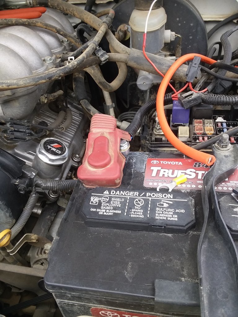

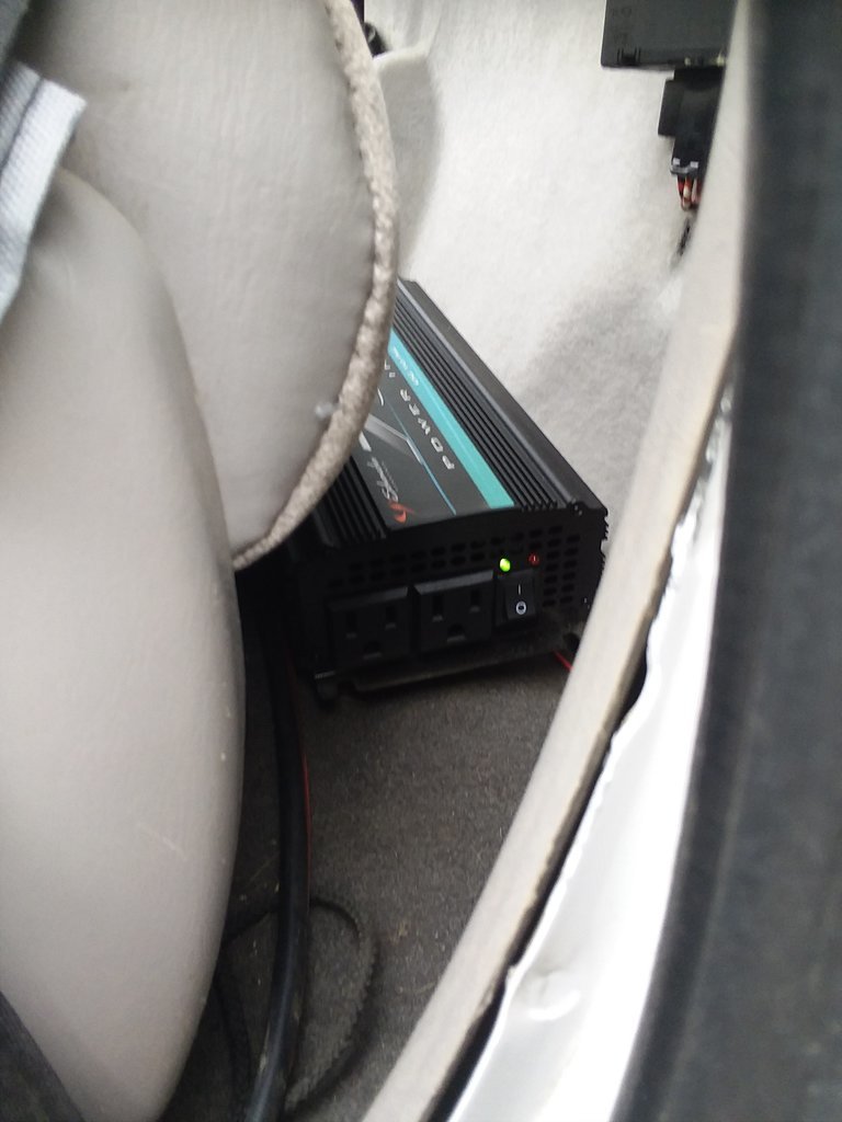

    Just installed a power inverter behind the rear seat its hooked up to a relay and switch on the dash plus finishing up a bunch of other electrical stuff.

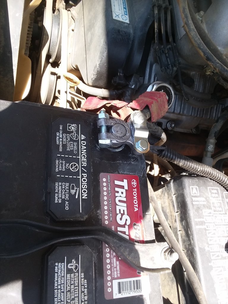

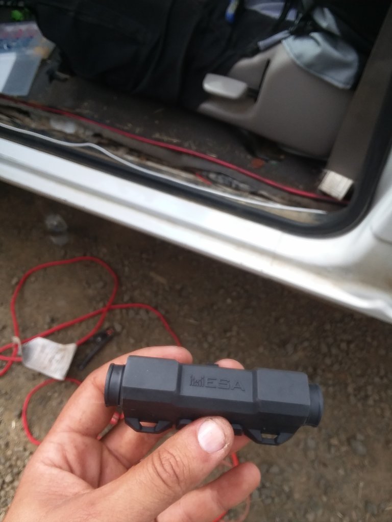

  20. Aug 6, 2017 at 8:45 AM
    #100
    mlcc
    mlcc [OP] Well-Known Member
    May 2, 2015
    #154429
    1,911
    Oregon
    2002 DC TRD/ 1995 4runner
    Mid travel, armour all around
    And the 70 amp fuse holder, another beer and I can still use the rubber thing that goes over the positive terminal
