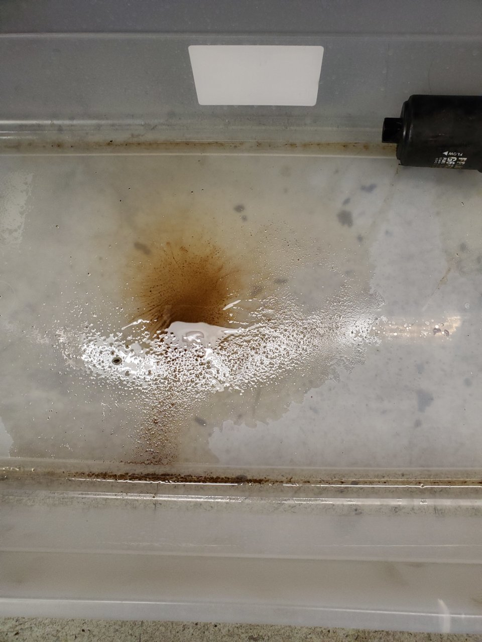

    So this came out of the fuel filter. It definitely has improved drivablebilty and cruising speed. I expect to have to do it again or replace the fuel pump if the tank looks anything like this.

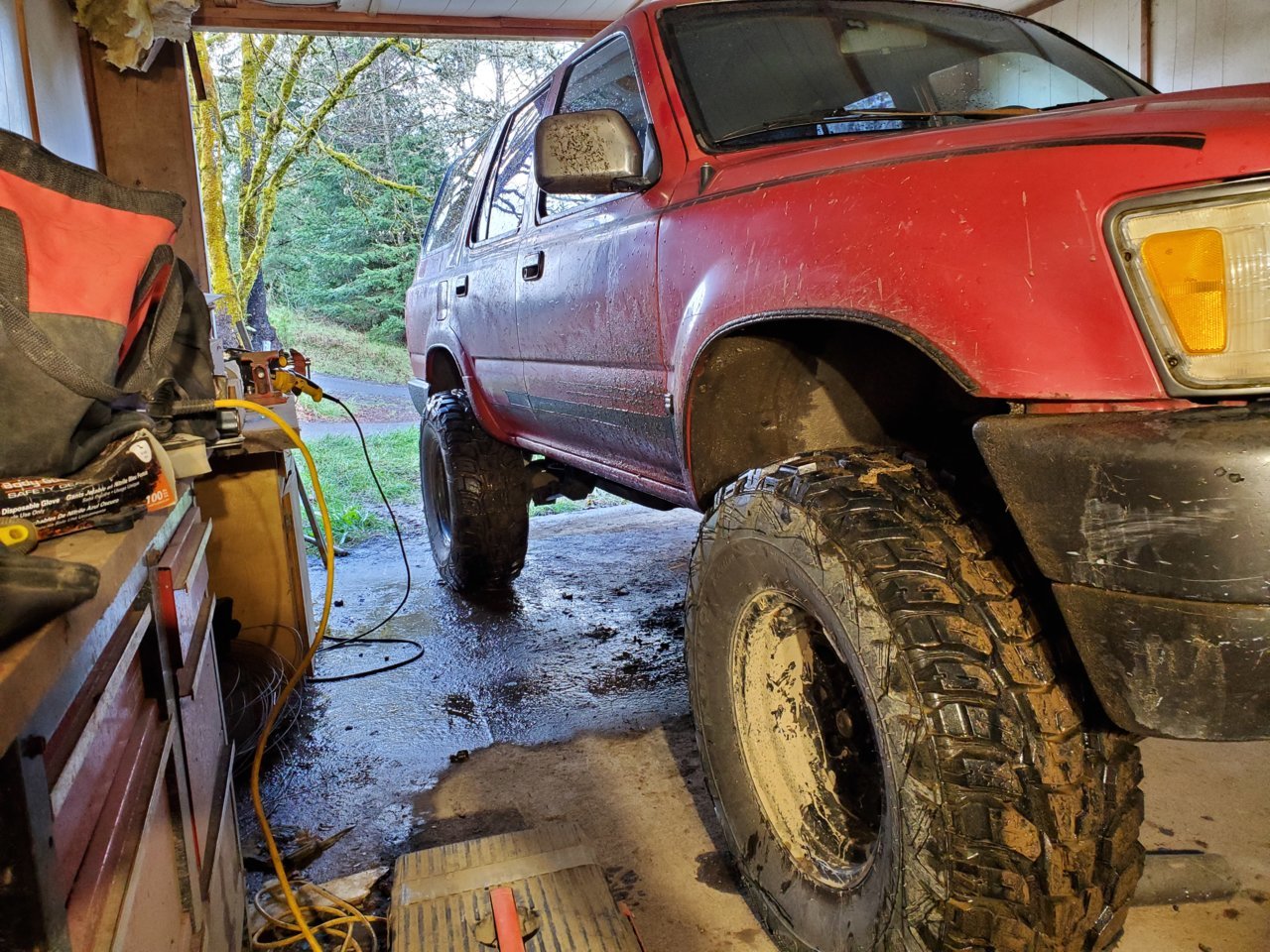

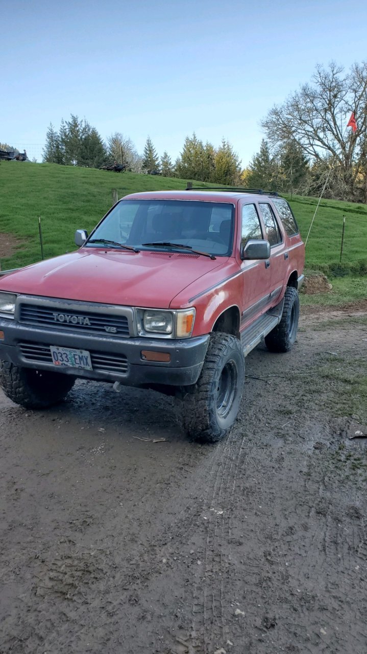

    Just a pic of it putting around.

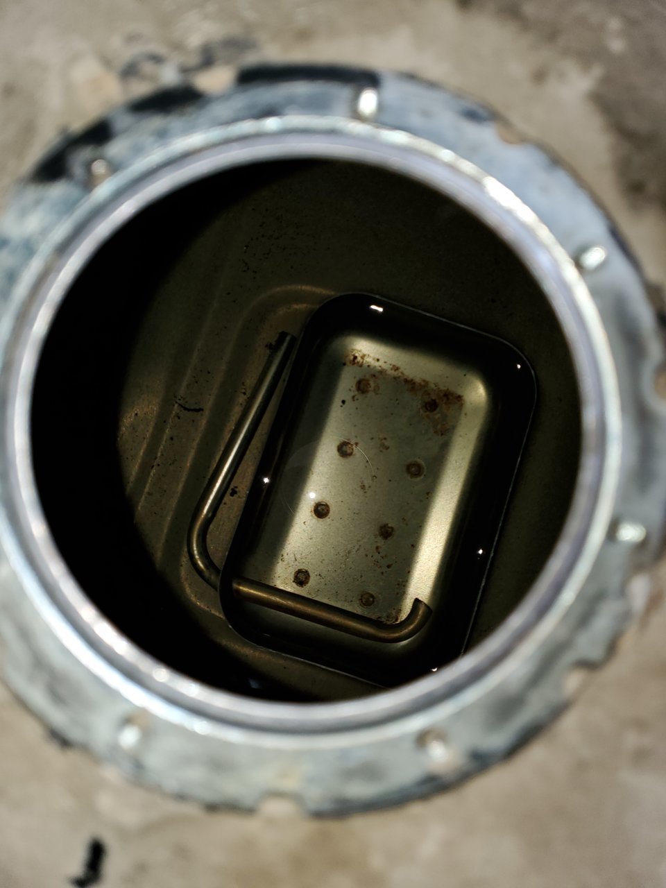

    Finally got around to dropping the fuel tank and it was relatively clean so some dirt did drop in the tank when i removed it so thats what you see floating in there some I guess ill just get a new fuel pump and see what happens.

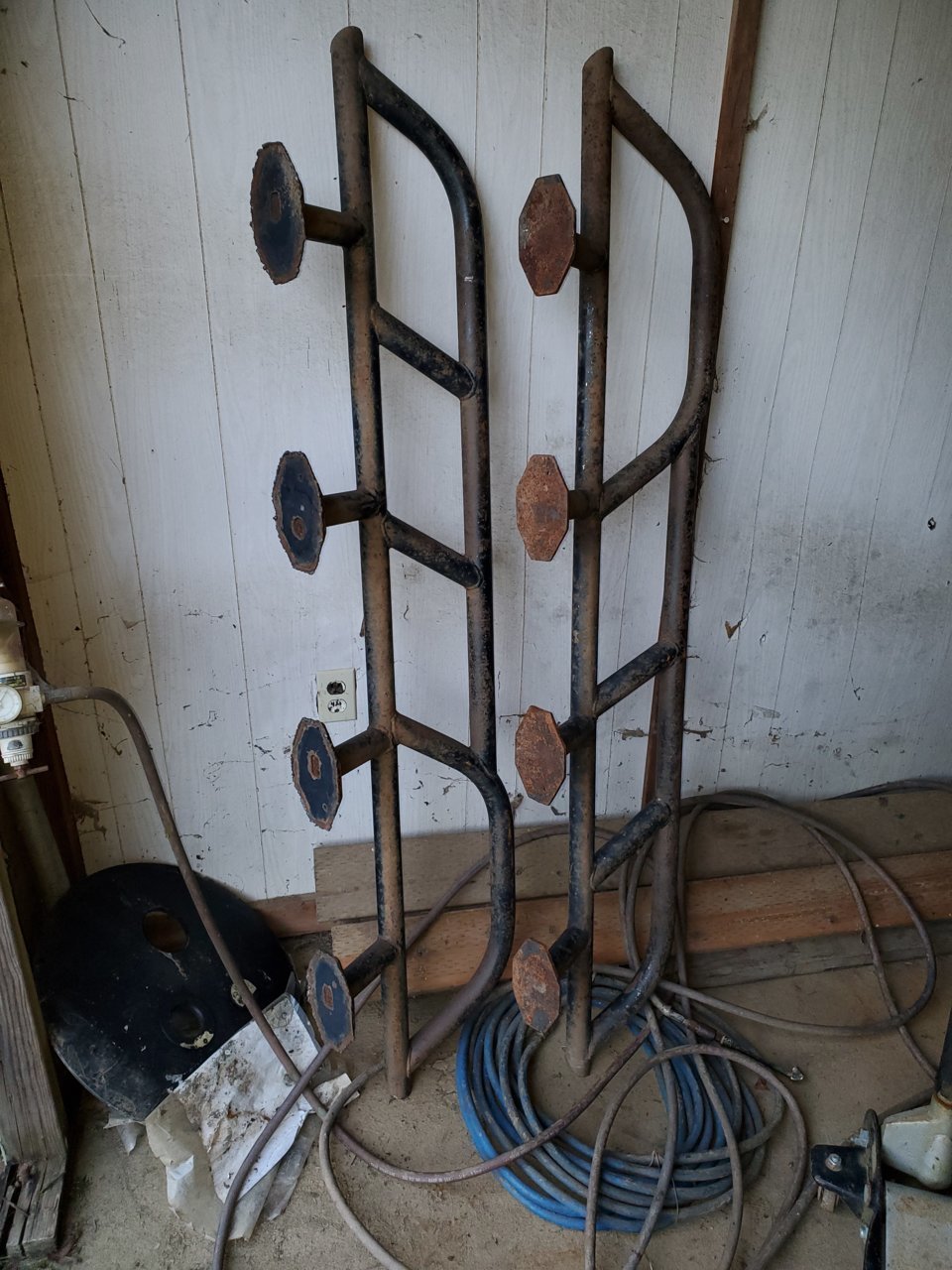

    No more running boards
    Edit: and to make life interesting they were held on by 7mm 8mm 10mm 12mm 13mm and 14mm bolts.

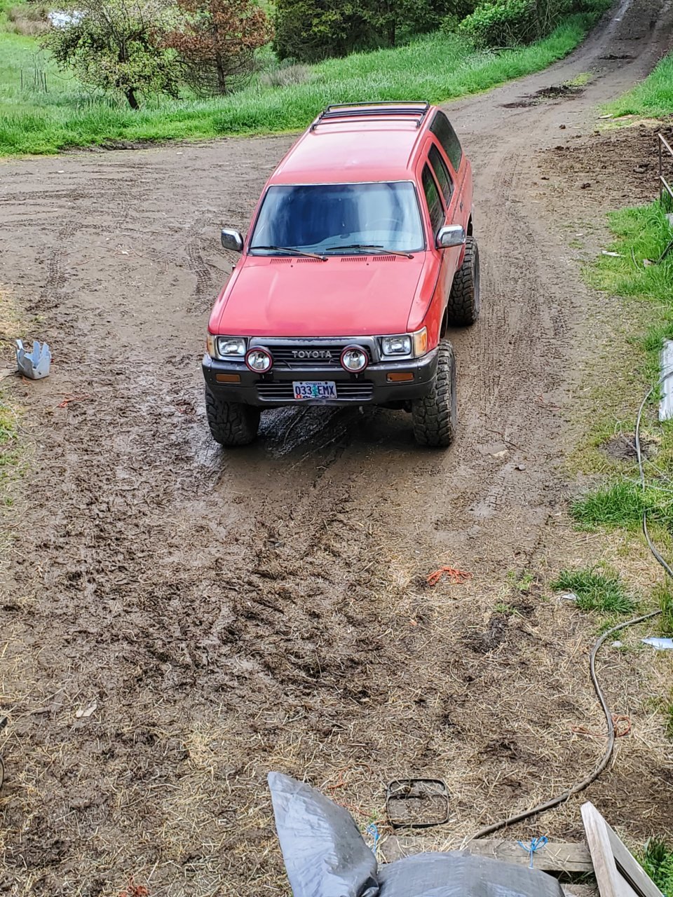

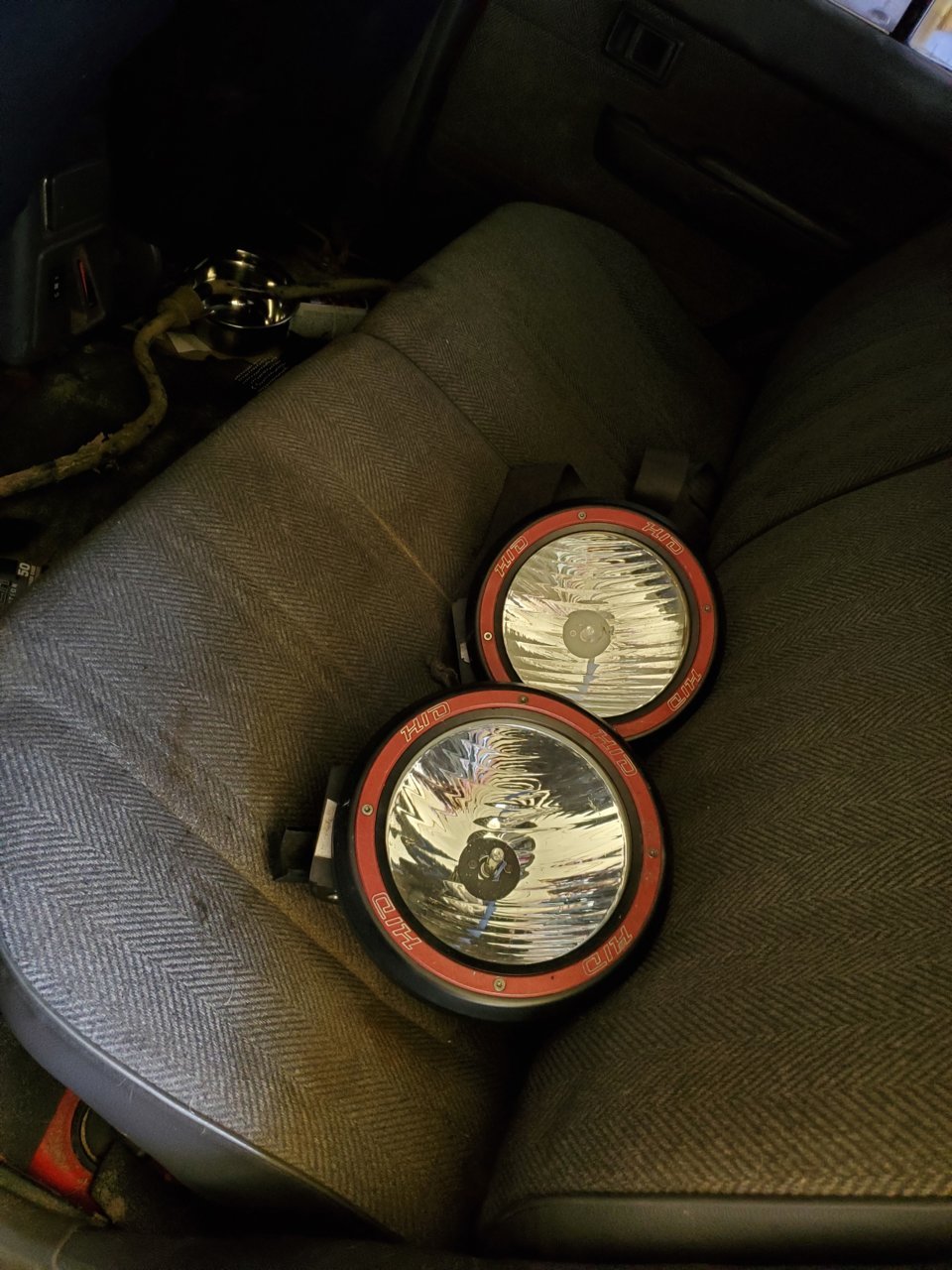

    and I got some bright HID offroad lights.

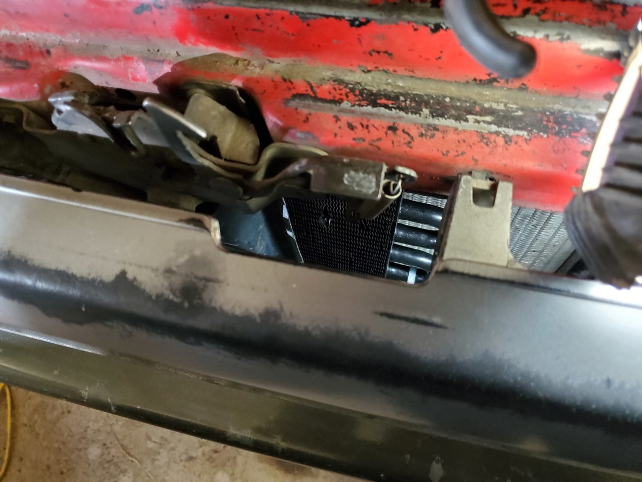

    Test drove the 4runner for hours today and it didnt set an AT oil temp light on and according to my temp gun the tranny maintained a good temperature the whole time. But the radiator does have some spots that are considerably colder indicating it has some cloged spots so im going to replace the radiator and get a fan shroud.

    Mid travel, armour all around
    plus I put on the lights and wired them in.
