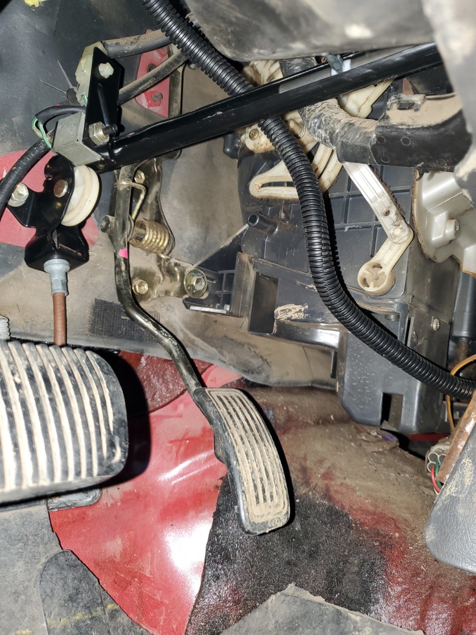

    i ended up having to replace the whole parking brake assembly so now its working and the brake warning light is no longer on the dash. I also replaced the trans oil temp sensor and that fixed that warning light, so now im down to only one warning light, the chech engine light.

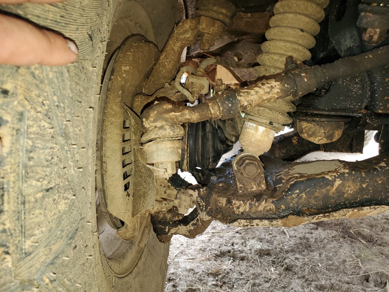

    Had some fun the weekend at the dunes and in the woods but the front suspension got knocked out of alignment and the right cv axle broke.

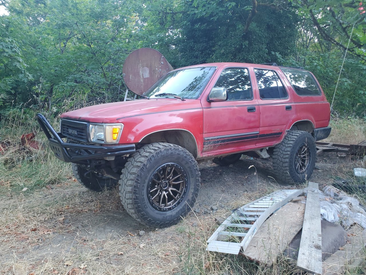

    Got everything fixed and squared away. Also finally the allpro bumper came

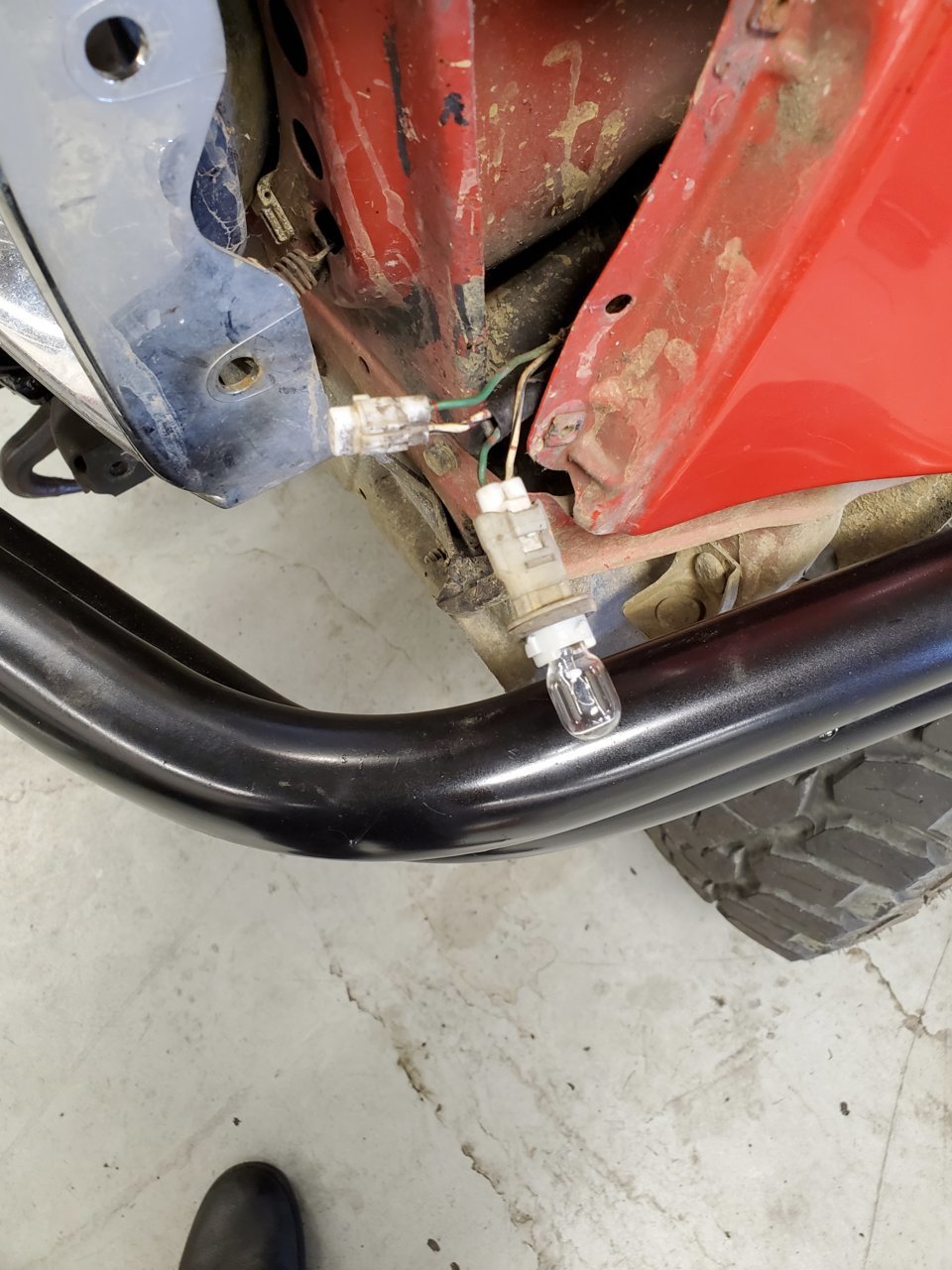

    Moved the 12v wire from the turn signal connector to the marker bulb connector and put in a bigger peanut bulb and now the marker light is a turn signal.

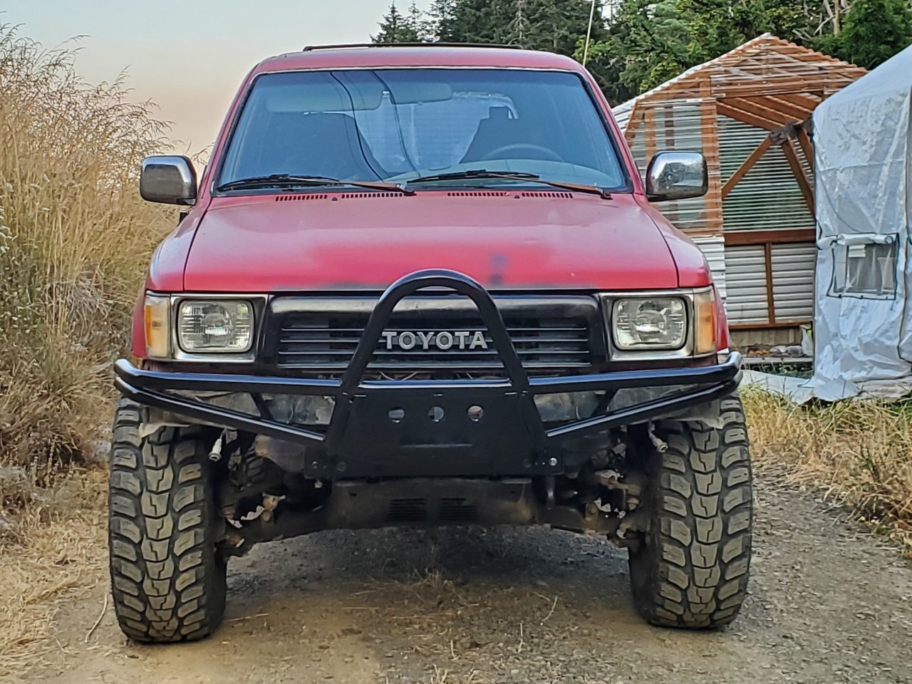

    35s

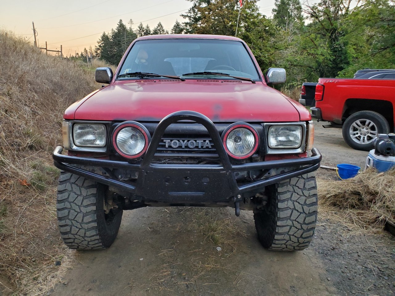

  6. Sep 28, 2020 at 7:47 PM
    #46
    mlcc
    mlcc [OP] Well-Known Member
    May 2, 2015
    #154429
    1,911
    Oregon
    2002 DC TRD/ 1995 4runner
    Mid travel, armour all around
    Welded some tabs on the bumper and got the lights mounted.

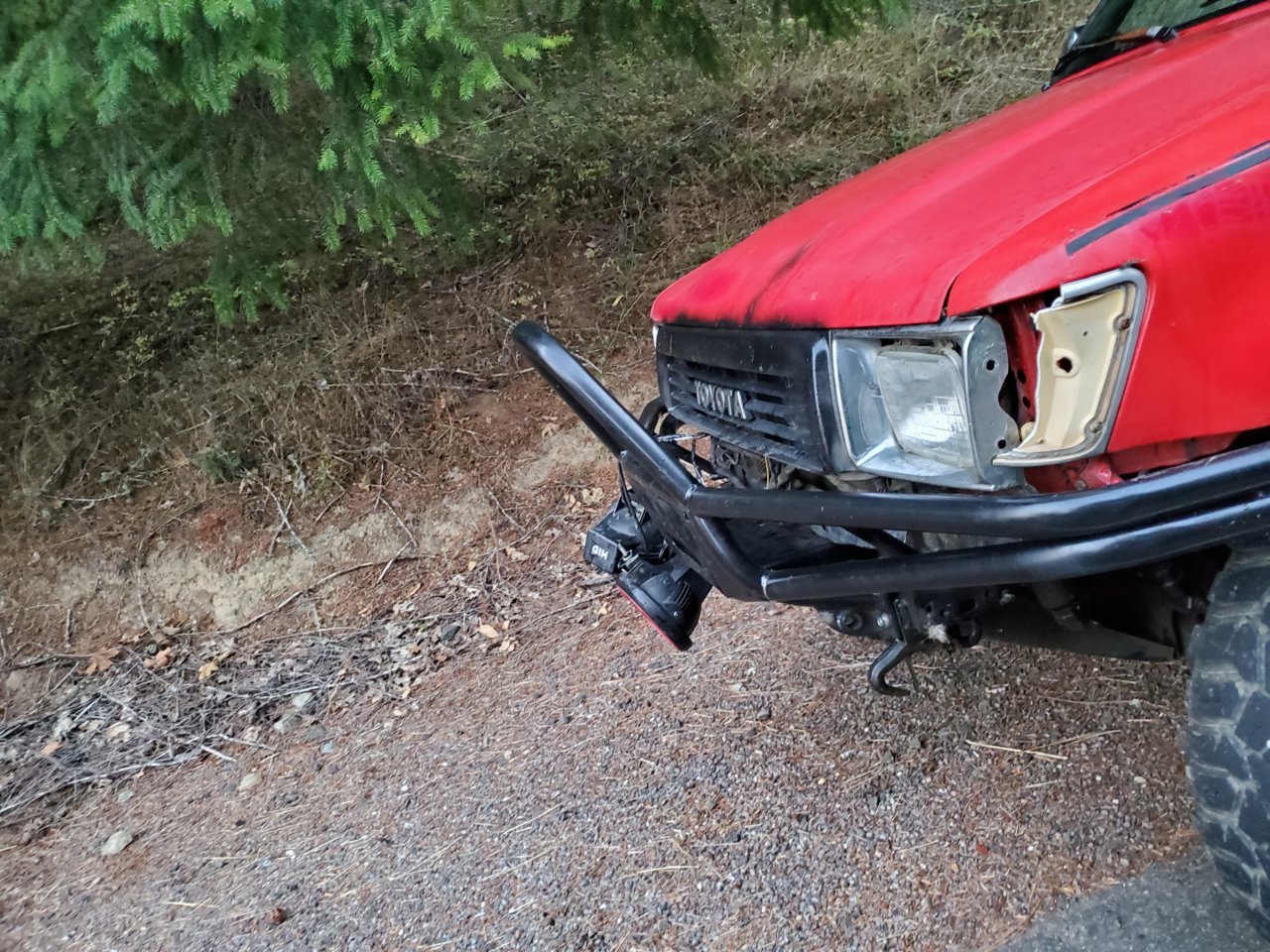

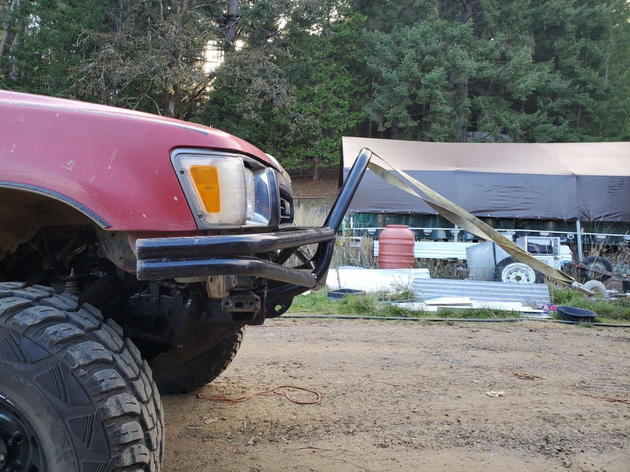

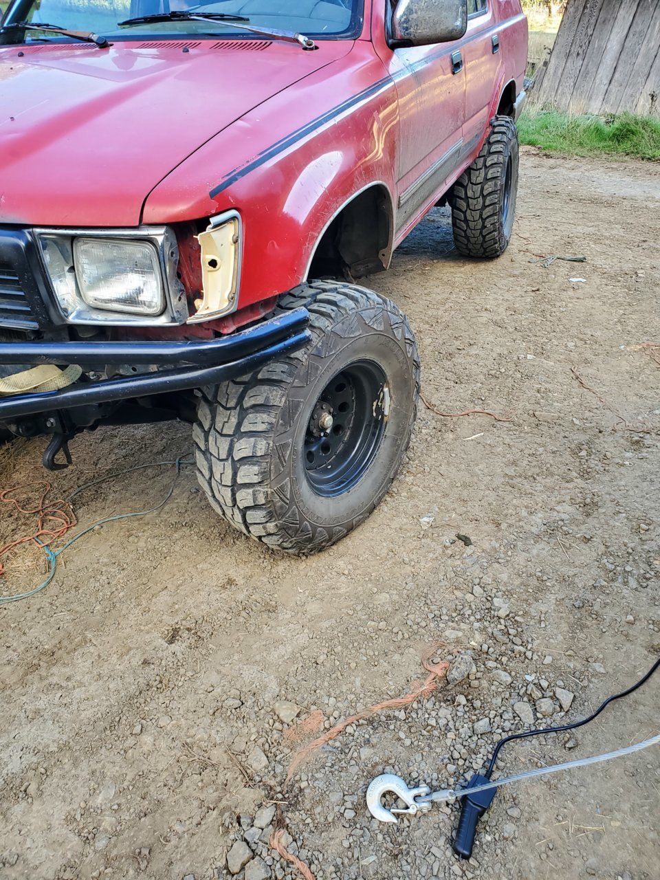

    Well this morning I hit a deer going 65mph... I cant have nice thing's. It bent and cracked a weld on the bumper but should be easy enought to fix. It also knocked the LF suspension out of alignment. I aligned it and it turned out good now I just need to fix the rest.

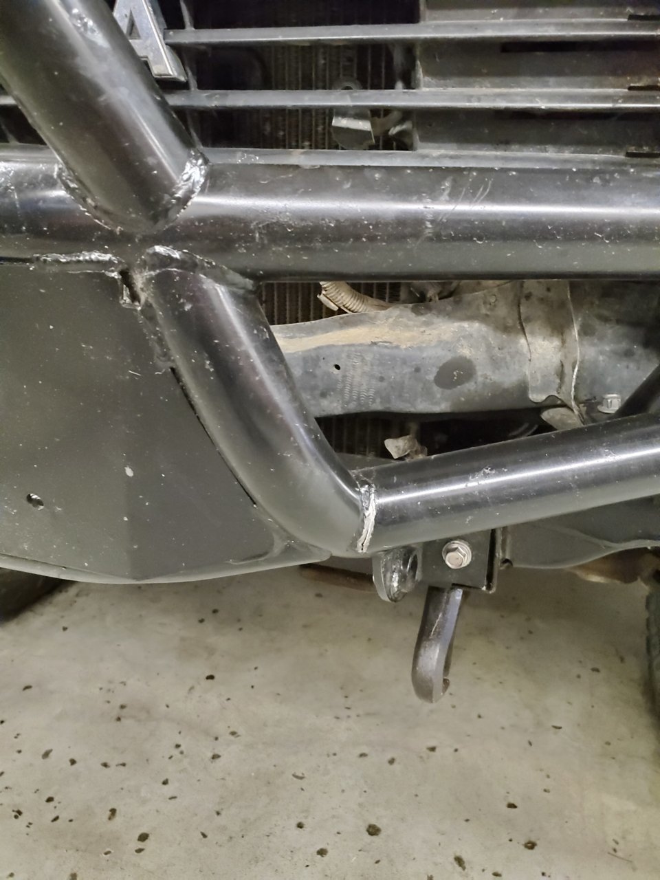

    Pulled the 4runner bumper straight with the tacoma winch and Im pretty happy with how it came out.

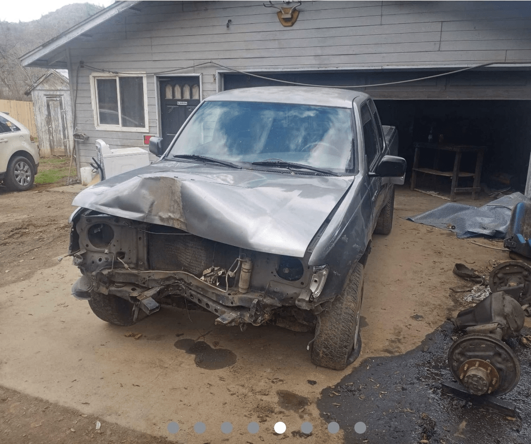

    Brought home a wrecked T100 as a donor for a 3.4 swap

    Pics of the donor

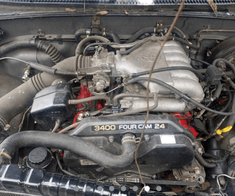

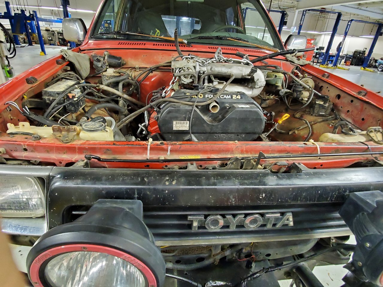

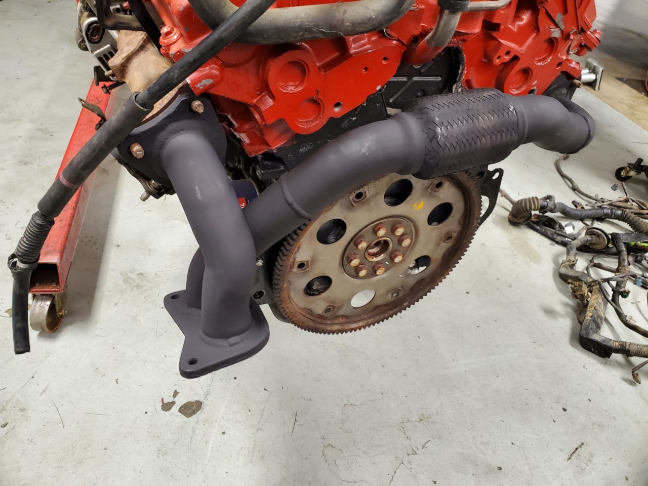

    Engine is in and a quick pic of the custom cross over pipe from toy only swaps

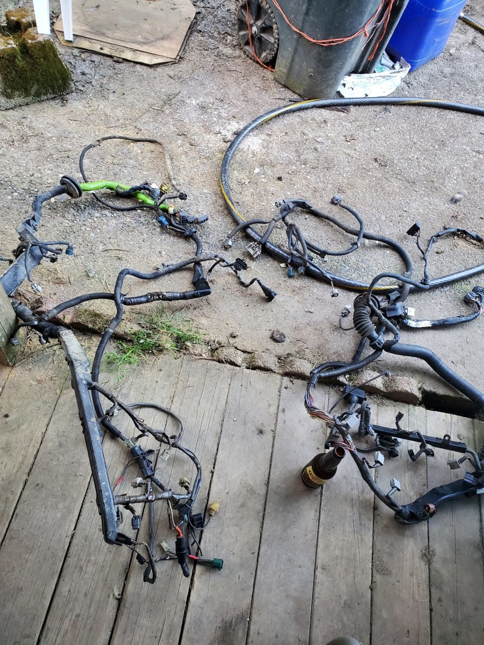

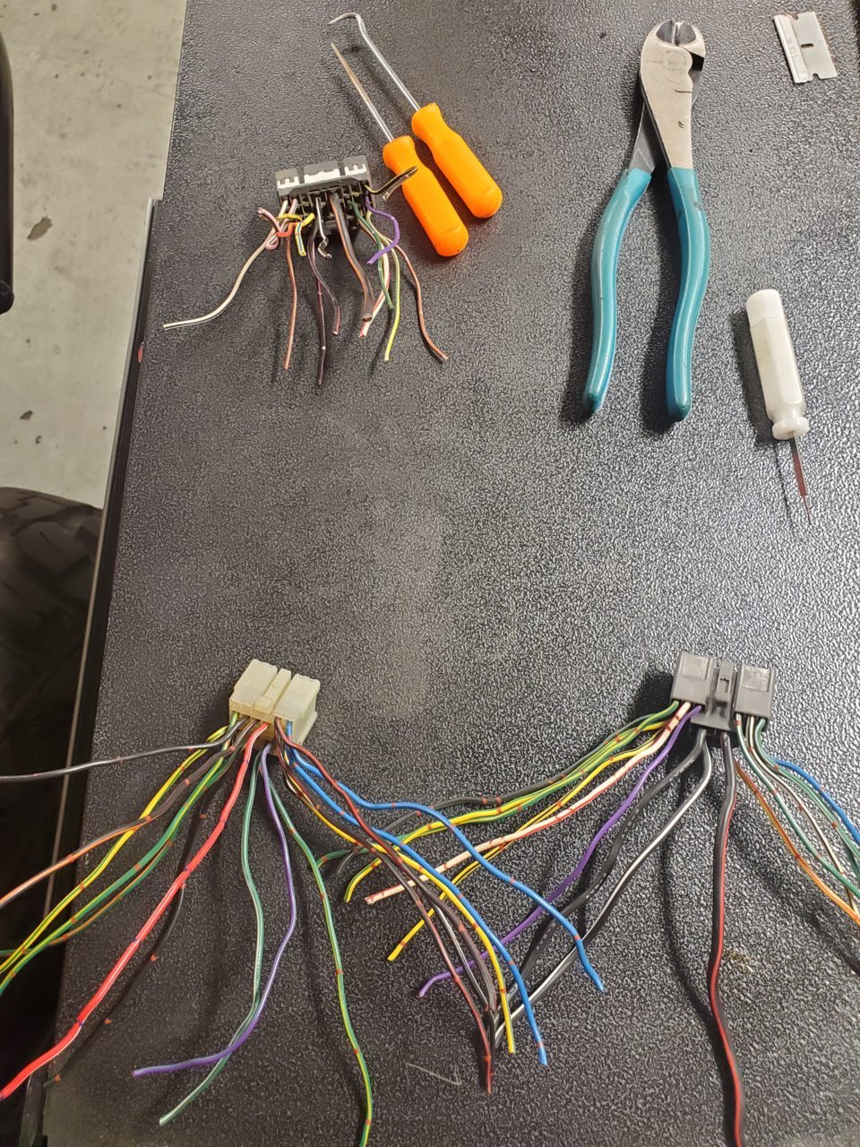

    Wiring time.

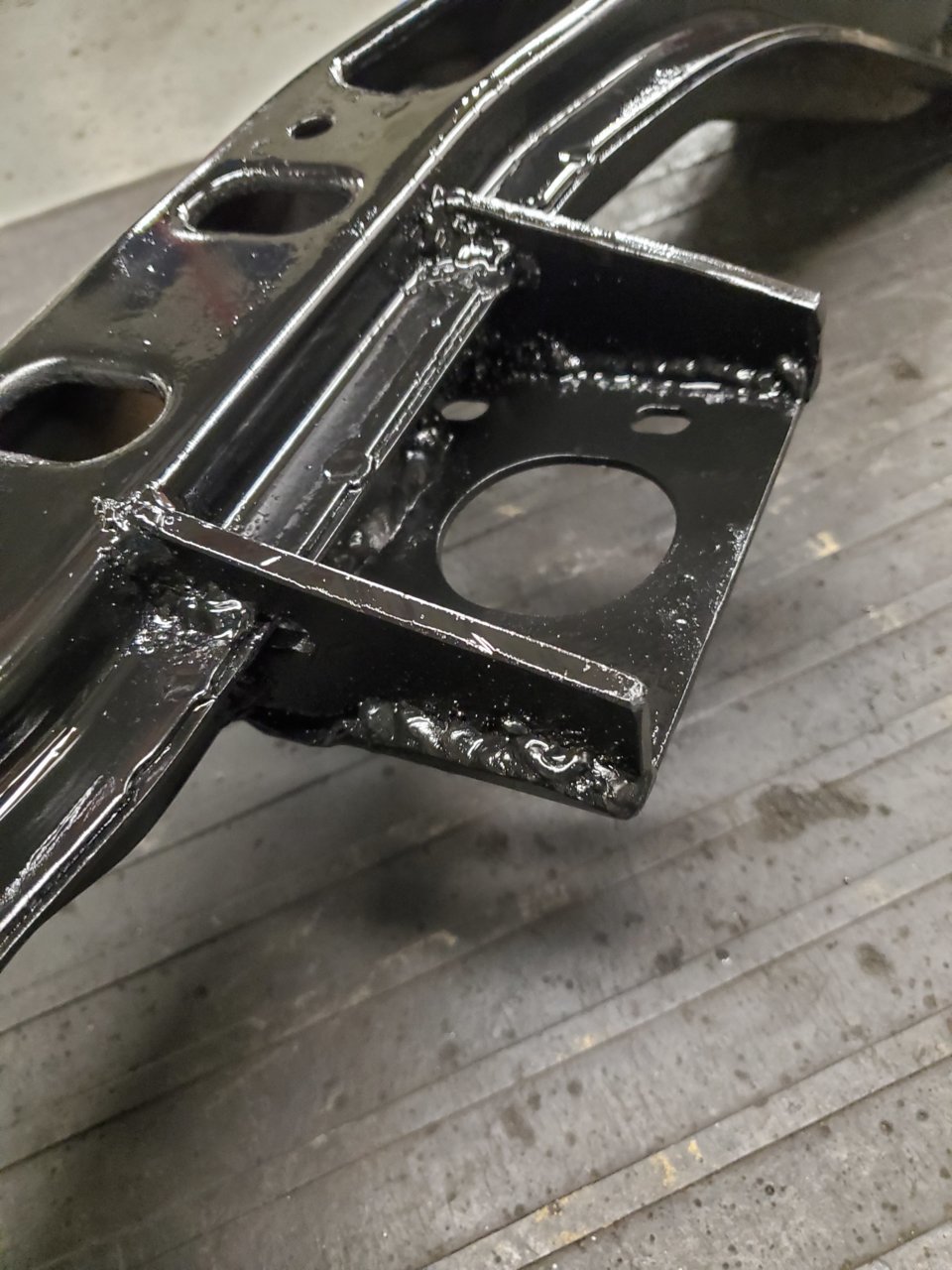

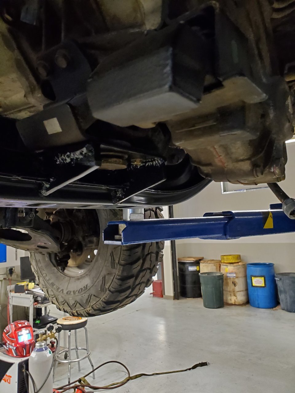

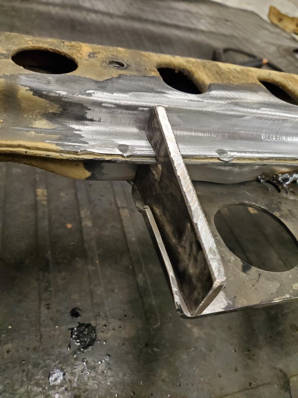

    Made some progress today welded up the cross member. Cut of the mount from the T100 crossmember used some scrap metal I had laying in the yard and welded it to the 4runner crossmember. And ended up cleaning up the whole crossmember and repainted the whole thing.

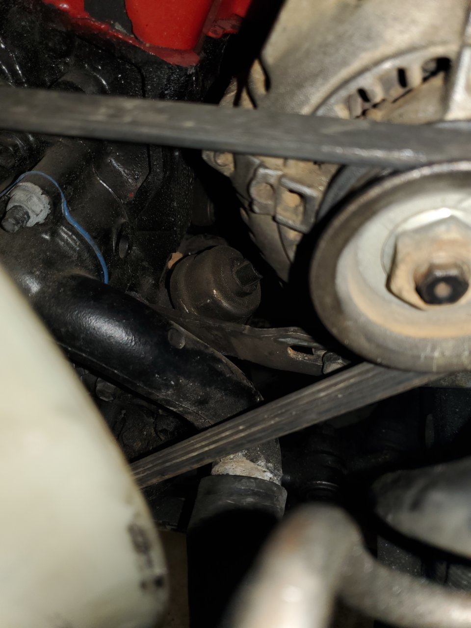

    Made some progress today, installed the 3vz alternator using the 5vz bracket, new radiator installed and hoses, fan, installed the battery/ starter harness. Installed starter and 3vz brackets that bolt the bottom of the block to bell housing.

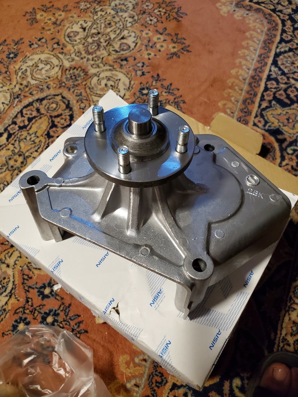

    Had to order a new fan pulley bracket due to the old one being bent from the t100 crash. So ponied up some dollars to order a new aisin one.

    Finishing up ecm wiring
