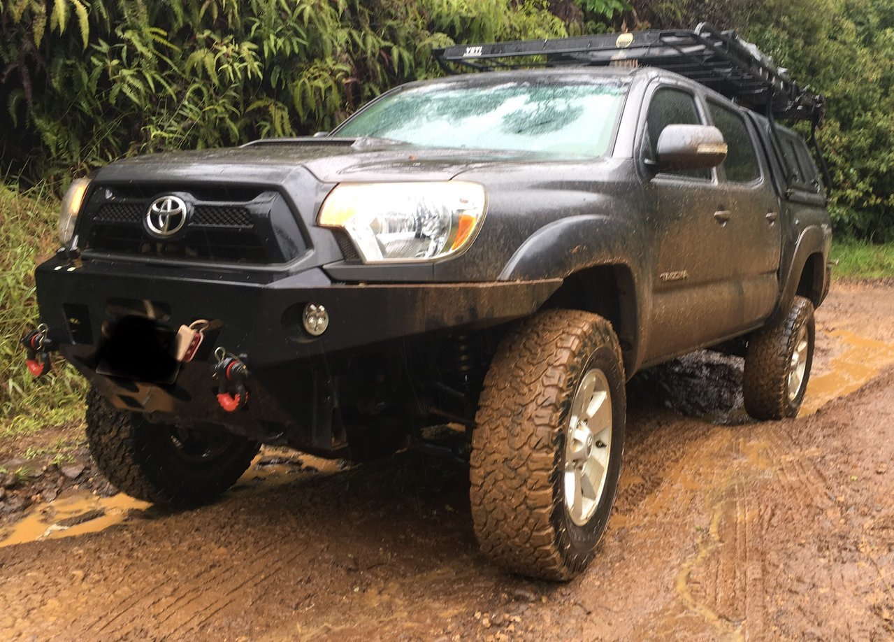

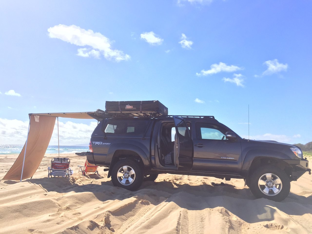

    This is my first shot at this...so...first day.
    2015 Toyota Tacoma Sport 4x4 DCSB 6 speed with TRD quick shifter
    To now.
    Summary of Mods:
    Interior:
    - Husky Weatherproof Floormats
    - LED Dome/Map lights
    - GTMAT sound deadener insulation at doors and back of cab
    - Wet Okole seat covers
    Electronics:
    - Kicker 6.5" door speakers
    - Kicker 8" woofer
    - Rockford Fosgate R600X5 amp
    - Direct Electronics 535T window one touch (second one, need to remove)
    - 4lo Yellow wire mod
    - OGE Dual batteries (Optima D31 yellowtops with one in the bed)
    - Pelfreybilt fuse panel with Blue Sea 6 circuit fuse block (x 2)
    - Xantrex 1000W inverter
    - Scangauge II
    - Baja Designs Squadron fog lights
    - Anytime Fog Light mod
    - Anytime backup camera mod
    Exterior:
    - Snugtop Cab Hi shell with driver side windoor
    - Custom contractor rack with lights and shovel mount
    - Custom bed shelf and chair holders
    - Custom bed drawers
    - Total Chaos bed stiffeners
    - Tepui Kukenam Ruggedized with lights
    - ARB ARB3110 4' Awning
    - Rear differential breather mod
    - Front and rear extended SS brake lines
    - 4runner brake caliper/powerstop rotor and pad upgrade
    Armor:
    - Relentless Fabrication Stealth front bumper
    - Pelfreybilt rear bumper with swing out gate and custom padlock
    - Custom aluminum Yeti 35 box on gate
    - Pelfreybilt gas tank skid
    Air:
    - ARB dual CKMTA12 compressor
    - Aluminum 3 gallon tank
    Water:
    - Frontrunner 10 gallon bed tank
    - Johnson Pumps Aqua Jet 2.9
    - Duda Energy heat exchanger
    Wheels & Tires:
    - BFG K02s 275/70/R17
    - SCS Ray 10 matte jet black
    Suspension:
    - Icon 2.5 extended travel coilovers with 700 lb springs
    - Icon UCA's
    - Icon 2.5 rear shocks with remote reservoir
    - OME Dakar CS047R
    - Dakar D29XL extra leaf
    - Firestone Ride Rite air bags
    - All-pro flip with Total Chaos brackets
    - Total Chaos spindle gussets by @glorifiedwelder
    Recovery:
    - 30k lb tow strap
    - ARB shackles
    - MAXSA traction mats
    - Staun tire deflators
    I think that's it for now.

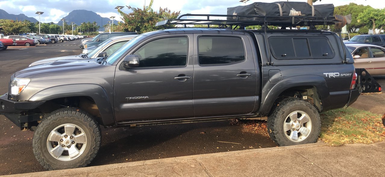

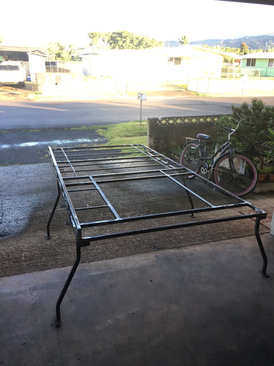

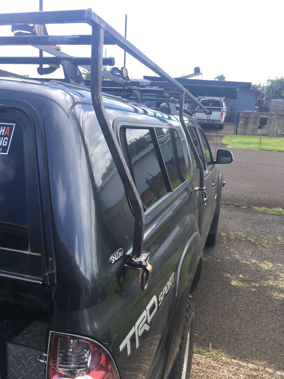

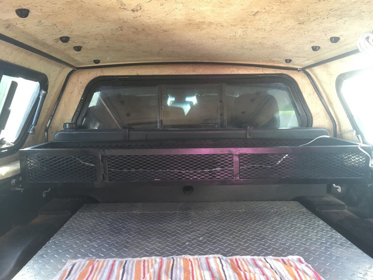

    I'm interested in the rack myself. How does it attach so it's strong enough to support the rtt and gear? Very nice set up I've been considering something like this to go over my best top

    Looks real nice, any better pictures of how the topper is notched for the contractor rack?

    5BEAEBC9-485E-42A5-8D0F-8AF4BF3D28AD.jpg 78CE25CC-1688-423E-9ABA-91C003C63C78.jpg
    I thought I had pictures of the brackets, but I can’t find them. I’ll take some pictures for y’all.
    MarX and Stig like this.
  10. Nov 23, 2017 at 8:17 PM
    dbrfan
    dbrfan [OP] Well-Known Member
    Oct 15, 2015
    #166754
    97
    2015 DCSB 4x4 6SPD
    The snugtop came with the roof bars, so I combined my rack to work with it. I clamp to those bars for lateral movement and the legs support the weight. I used 1” tubing, which I think would work without the bars, but probably would have gone with 1-1/4”or 1-1/2” tubing without.

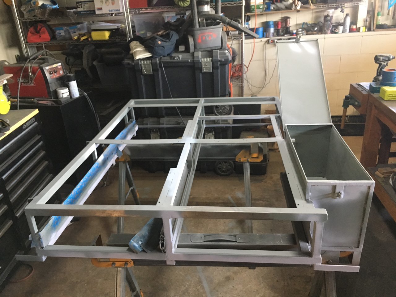

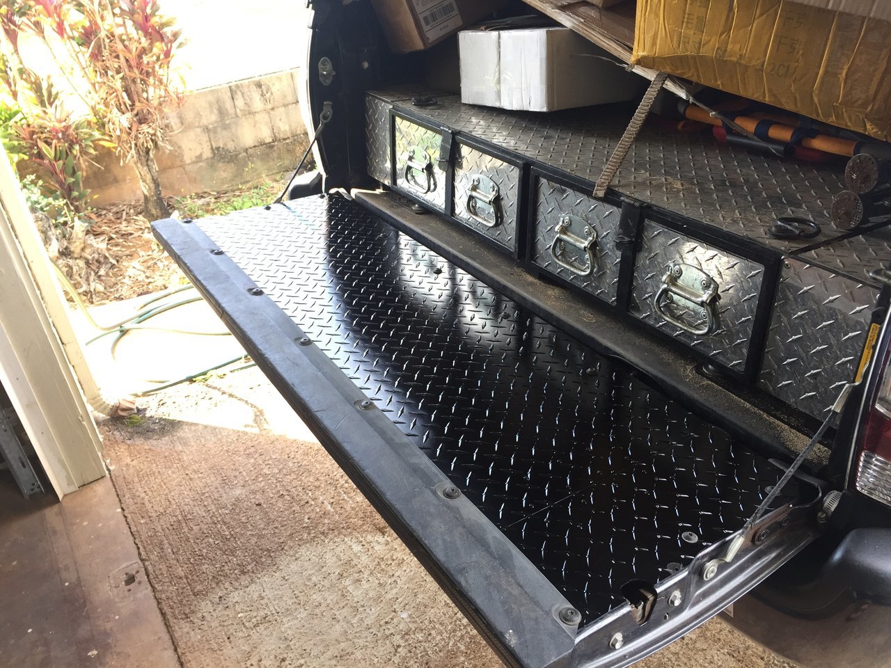

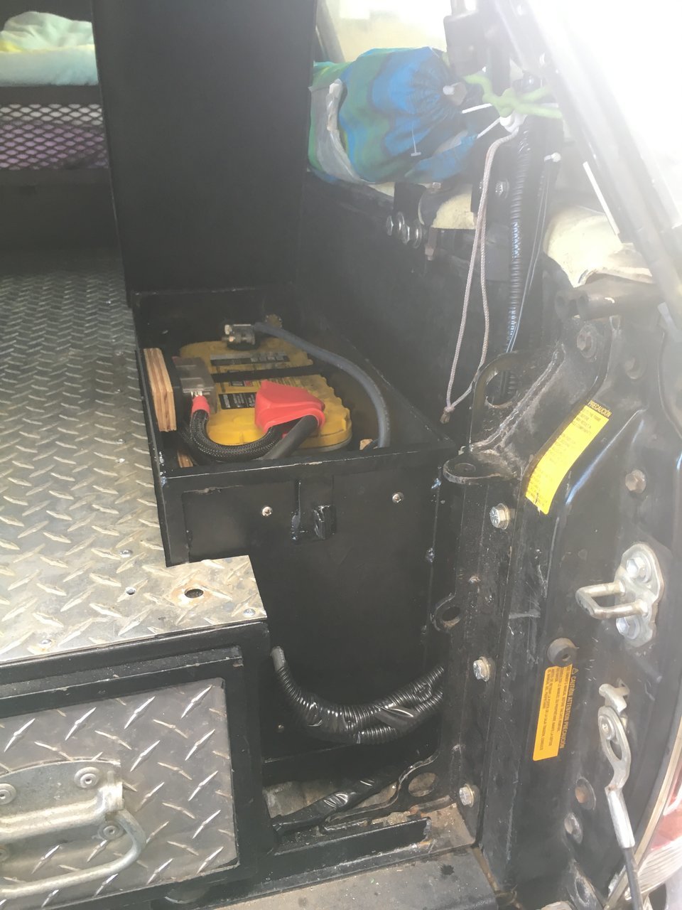

    Bed drawer box

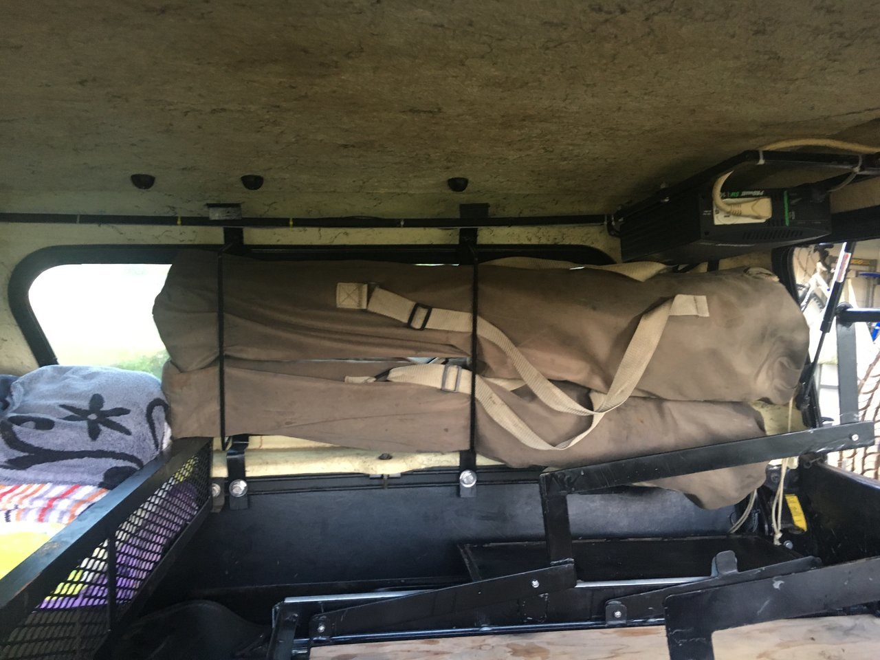

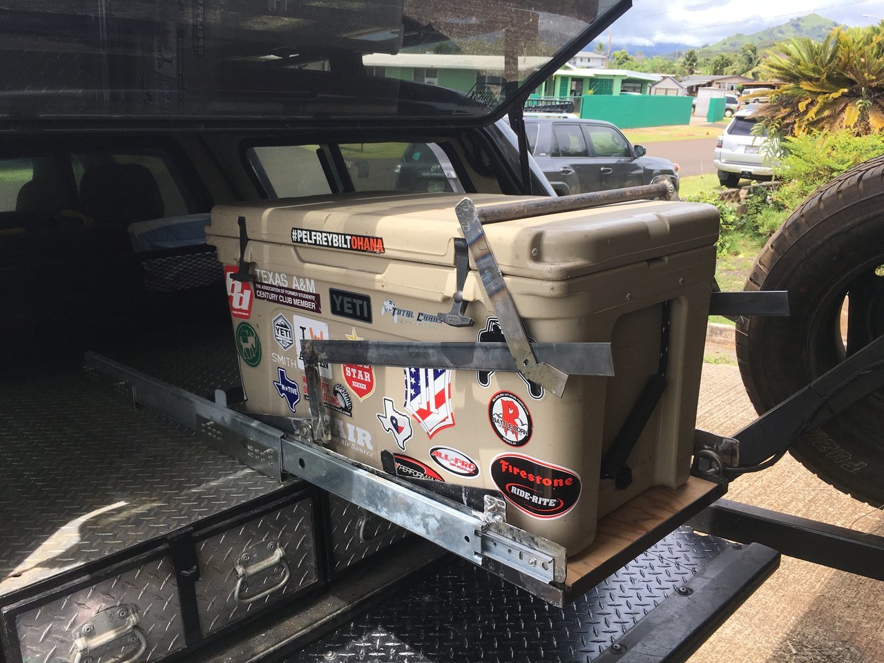

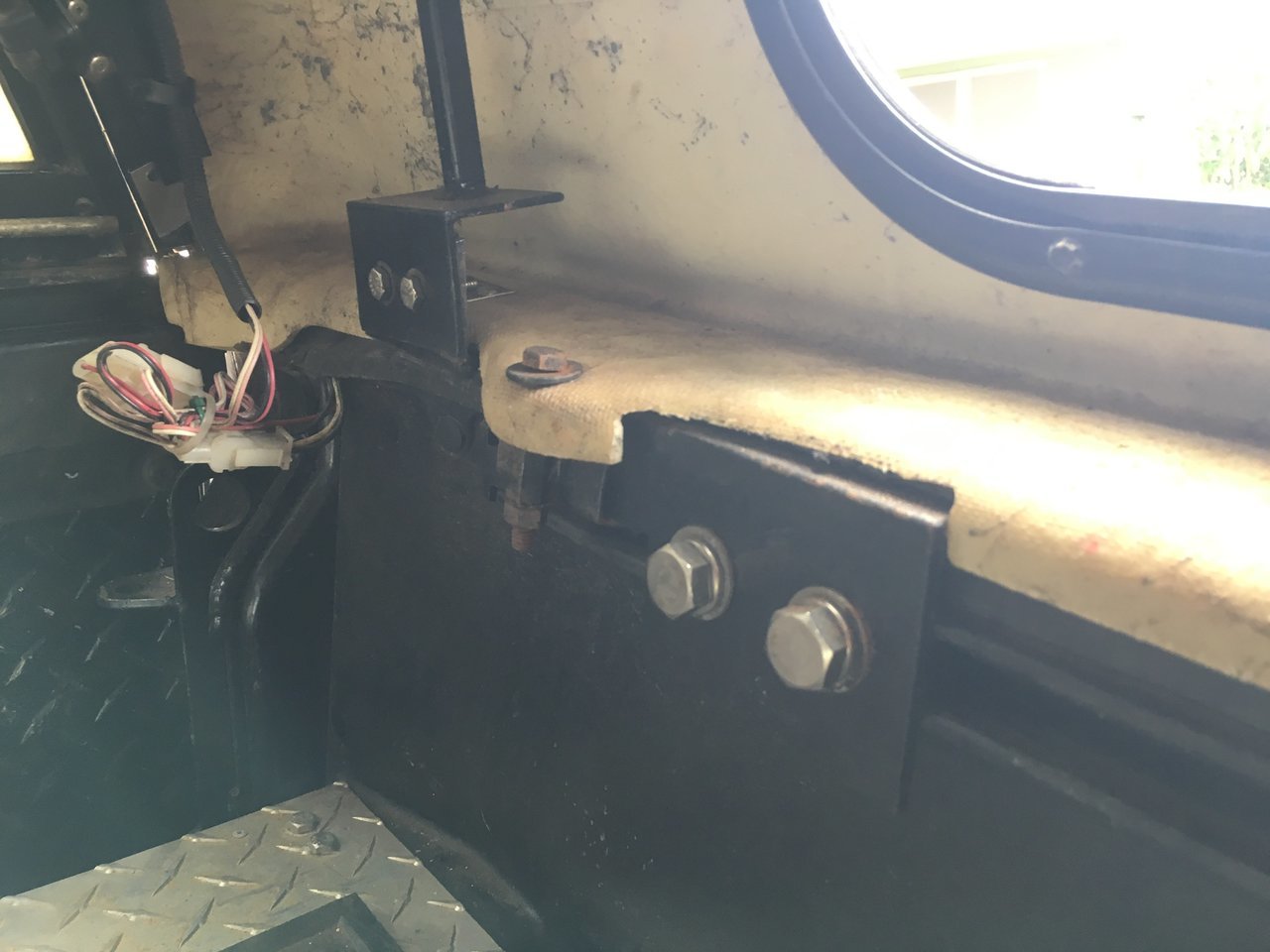

    Here’s a picture of one of the brackets in the rear....I thought I had pics of them before install. I’ll have to see if I have any sketches of them. They are really Frankenstein brackets.
