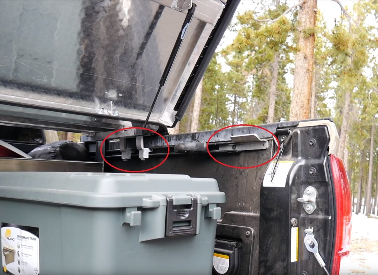

    Has anyone installed these with a Diamondback truck cover? I read the clearance spec on the website (63" between brackets and 6" vertical height from the bed rail), so I think they *should* work, but it would be great to see a pic or two with the Diamondback? Thanks!

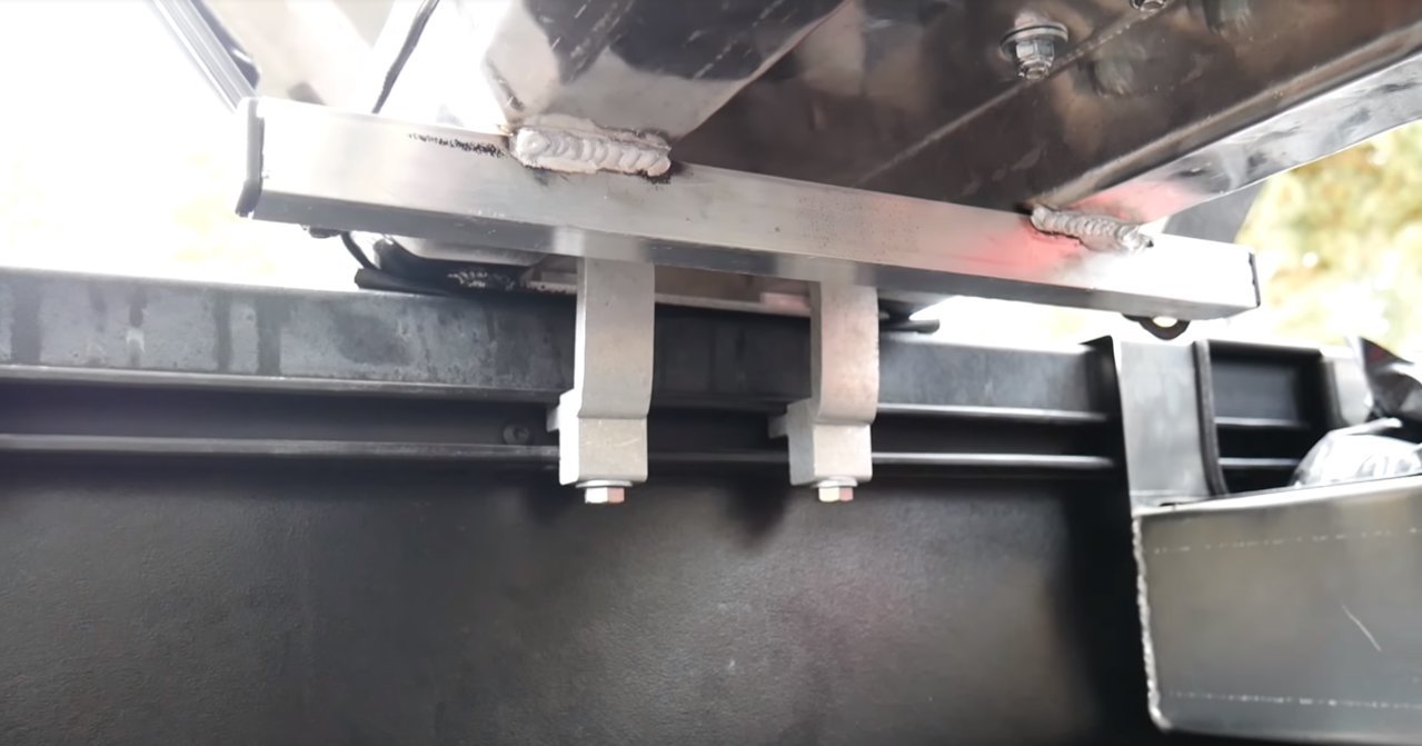

    Id really need to see this cover mounted on the truck from the underside, specifically how they are bolted on to the truck.

    Hi Joe!
    Here are some pics of how they mount. Basically there are 3 pieces: The front panel, the center cross brace and the rear panel. The front panel has metal rods that insert into the stock bed rail itself at the very front. The center cross brace has two clamps per side that clamp the center brace to the bed rail. And the rear panel requires an "extension" that screws into the rear-most part of the stock bed rail and allow those metal rods to lock down. Hopefully the pics explain what I'm talking about, but essentially, the very front most part of the bed rail....the center part of the bed rail....and the rear most part of the bed rail are being used by this cover:

    Ours should work

    FYI, confirmed to work with the Diamondback Truck Cover:
