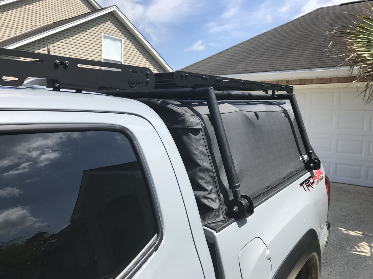

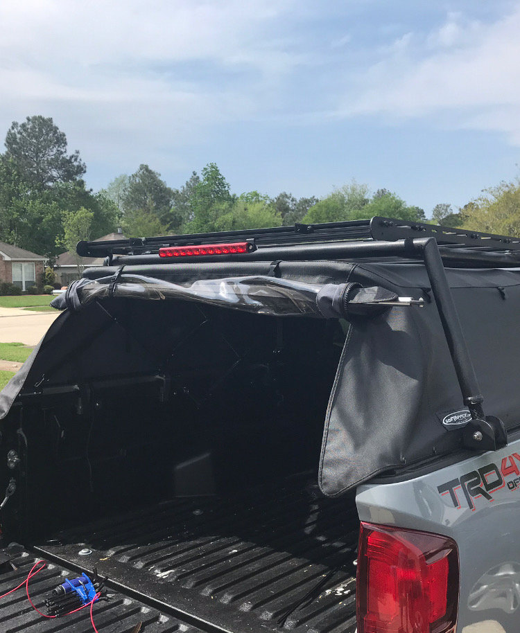

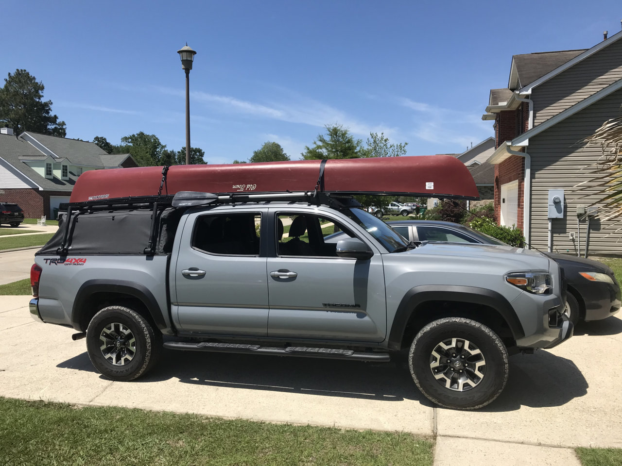

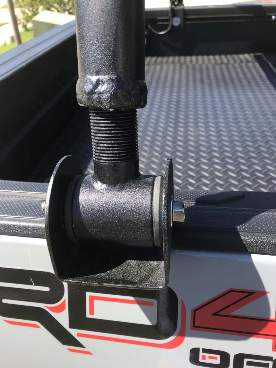

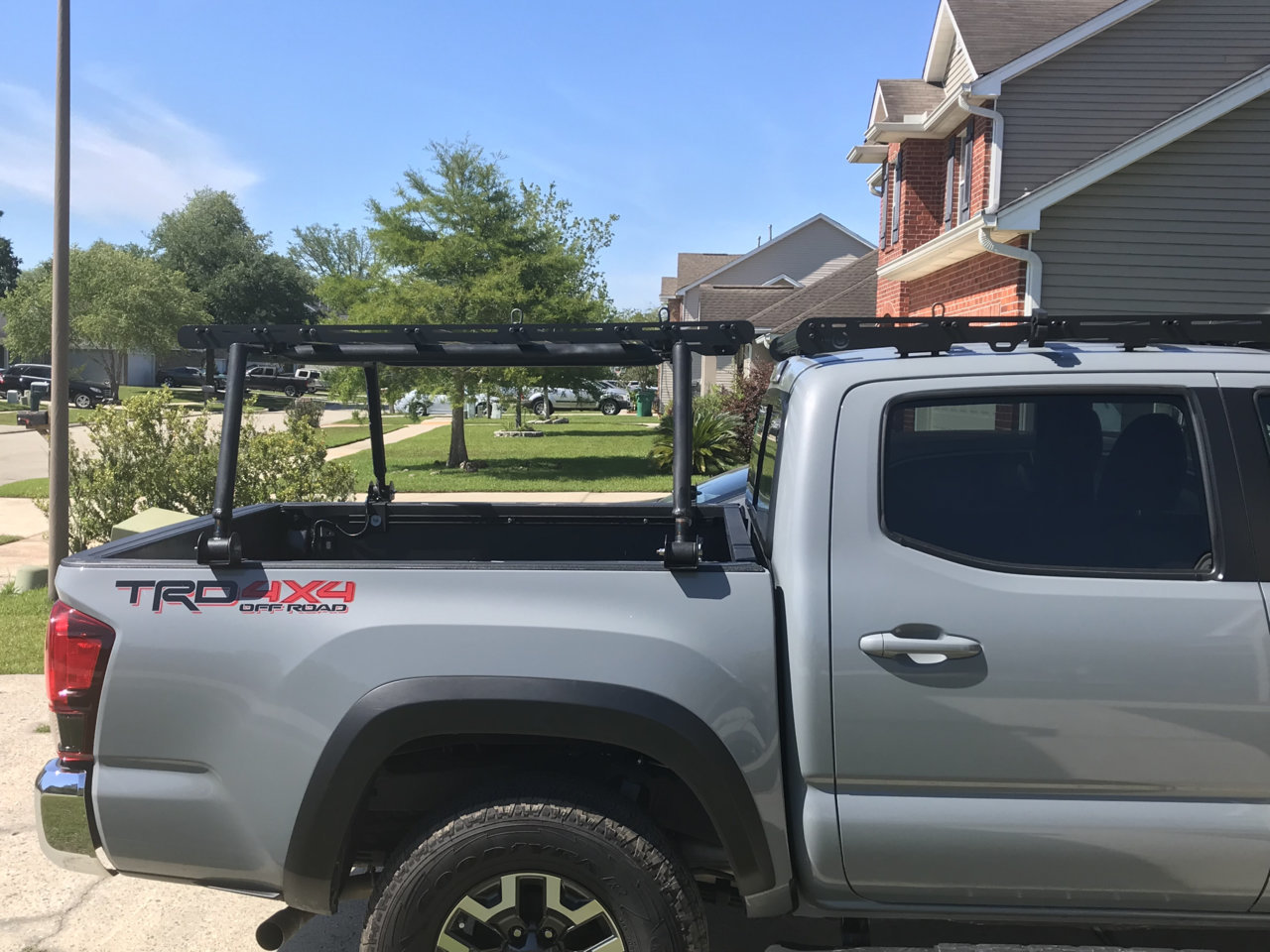

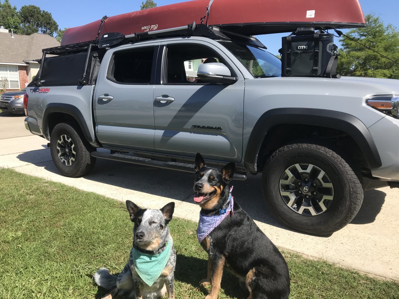

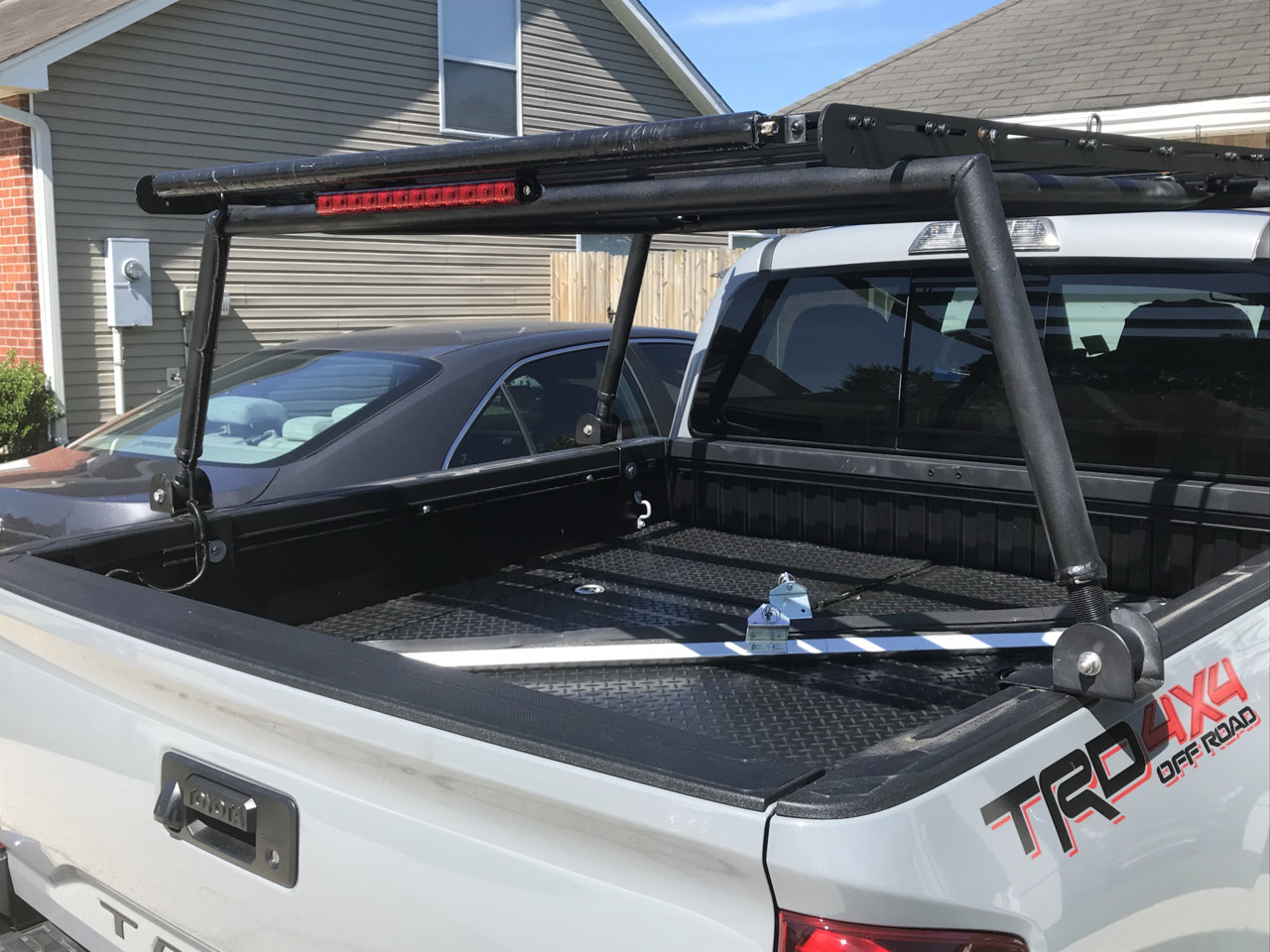

    Sure, here you go:
    I spray-painted it with black powder coat myself, after a coat of primer. I probably could have done a better job on that, but I was impatient.. The bushing allow for the varied-height to match it up perfectly with the existing bed rack I have. I added a third brake light from Amazon, and a conveyor roller bar primed and painted, with duct tape for the abuse I'll generate with my canoe. It works PERFECTLY for my uses as of yet. The roller bar was about $60 all-told, about half what rhino rack charges for a similar (and shoddier by some reviews) concept. Bonus pic of the dogs this past weekend.

    that looks like a quality rack :thumbsup:

    What diameter tubing did they use?
  7. May 2, 2020 at 1:19 PM
    #27
    captain_beefheart14
    captain_beefheart14 Well-Known Member
    Oct 16, 2019
    #308160
    268
    2019 Cement Off Road
    Prinsu racks, cab and top, light bar, rear and side roof rack lights, ARE Camper shell, blackout, TRD Grille, Anytime front and rear cameras, Truck bed box (DIY) Bilstein 5100 front, OME 2885 Coils, Ikon Stage 2 Rear AAL
    1.25"

    Man, this looks sweet ! I'm definitely interested in a set up like this. Does the machine shop think about mass producing these racks or was it a one off?

    Thanks! I told him other people would be interested, but he hinted it's not really worth his time. He does custom jobs for offshore rigs, and what not. But, I can forward the cad and sketchup files I have for it to you. You could probably find a local shop that could do this, no problem.
    If I had it to do over again, I might would curve the bars instead of having them angle. Just a personal preference. And, if you find the right shop, you could save on the Prinsu Top Rack cost by having them machine the slots and everything for you that's welded to the rack, similar to how the mobtown rack is all one piece. Then you just buy the cross bars from TNUTS or Prinsu themselves, I'll bet you could be all in save the crossbars for under $650.

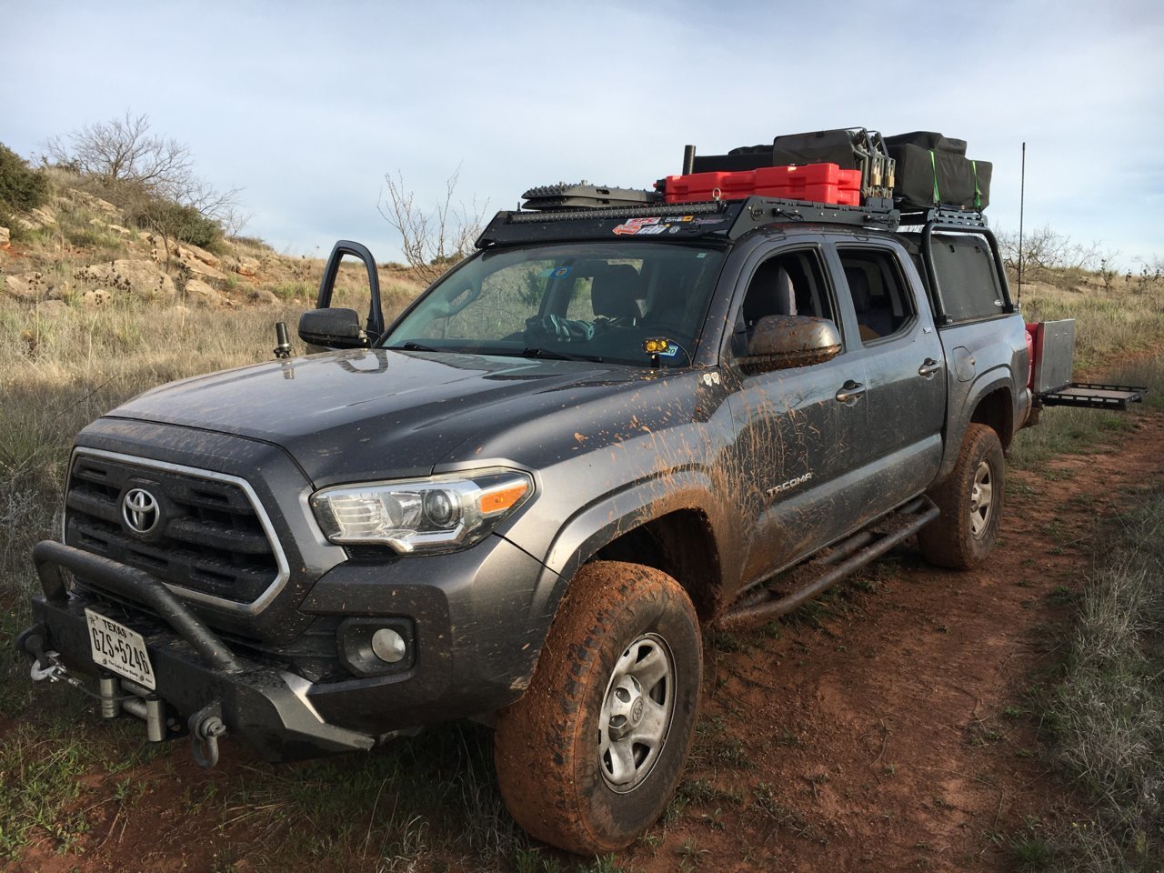

    https://www.expeditionportal.com/fo...e-canopy-bed-rack-for-a-2nd-gen-tacoma.65226/
    https://www.yotatech.com/forums/f2/racks-go-around-camper-shell-256889/
    Here's a link to the info in Dallas, but FWIW, I emailed and called this vendor a time or two when I still lived in Austin, and never heard a peep. But that Frontrunner Rack on top of the custom rack is what originally gave me the bug for this idea years ago.

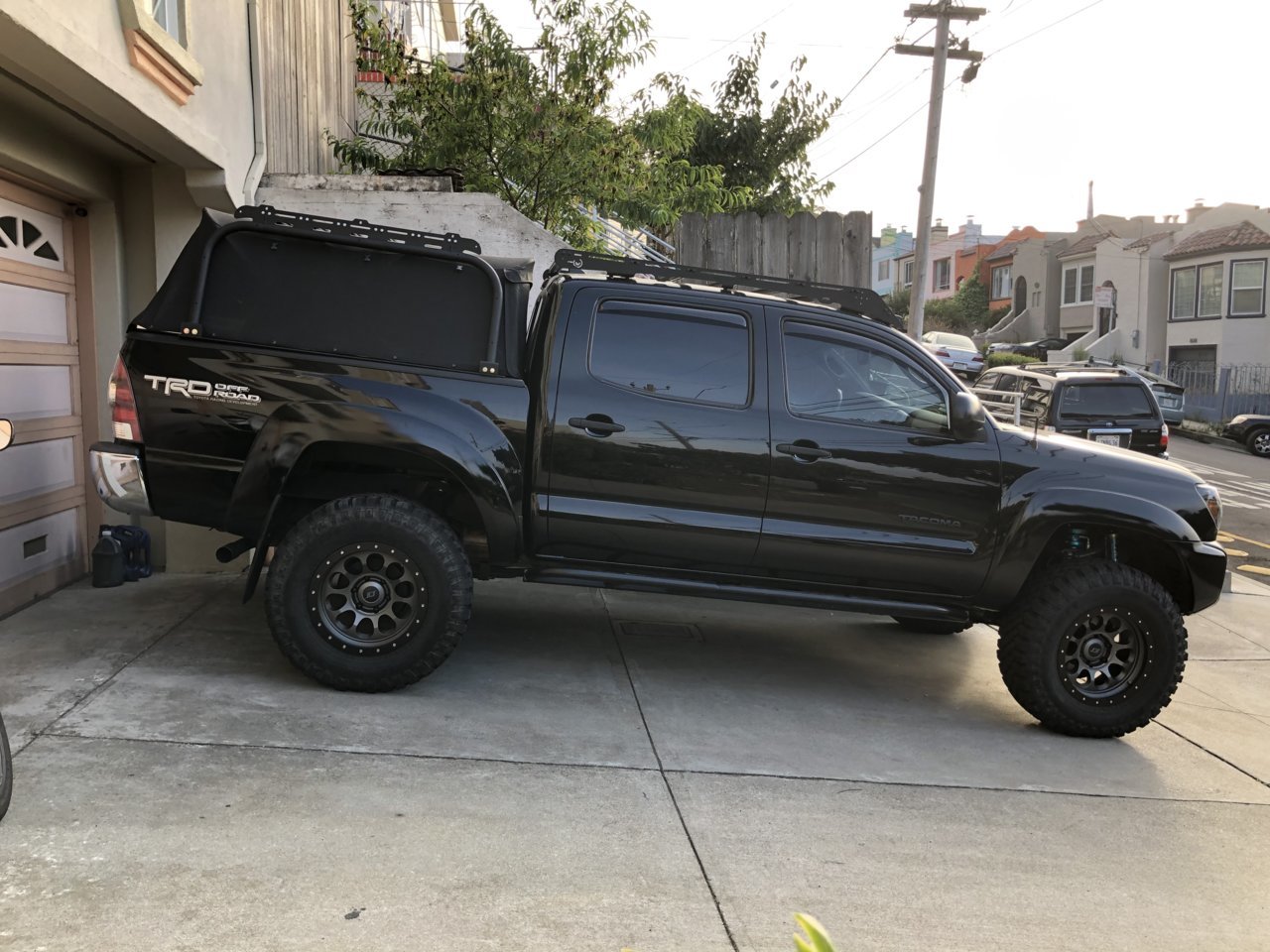

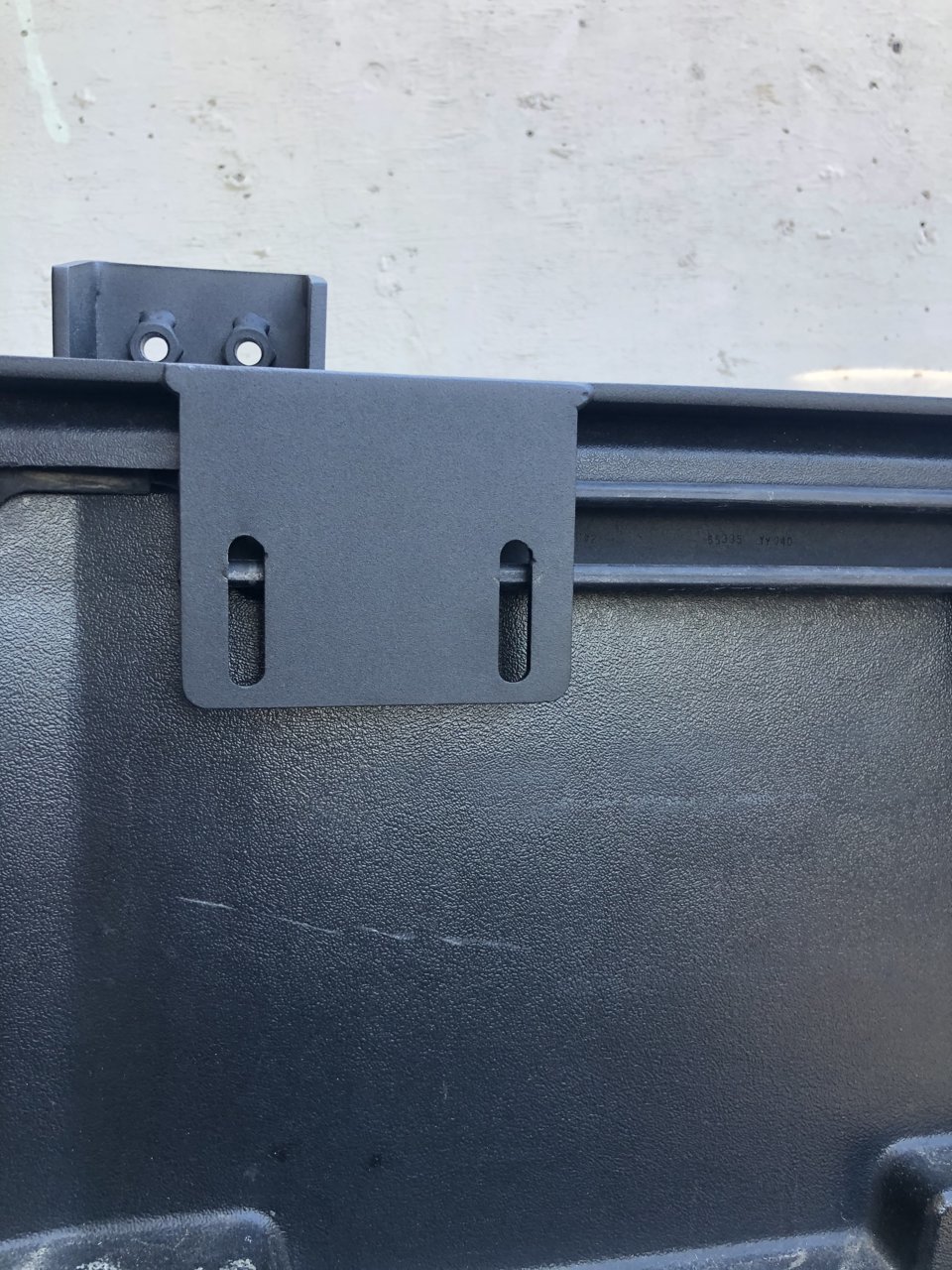

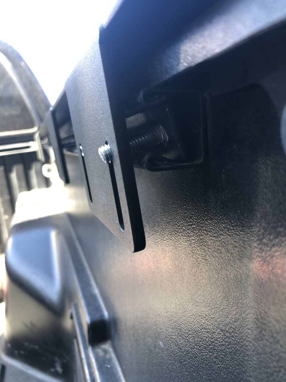

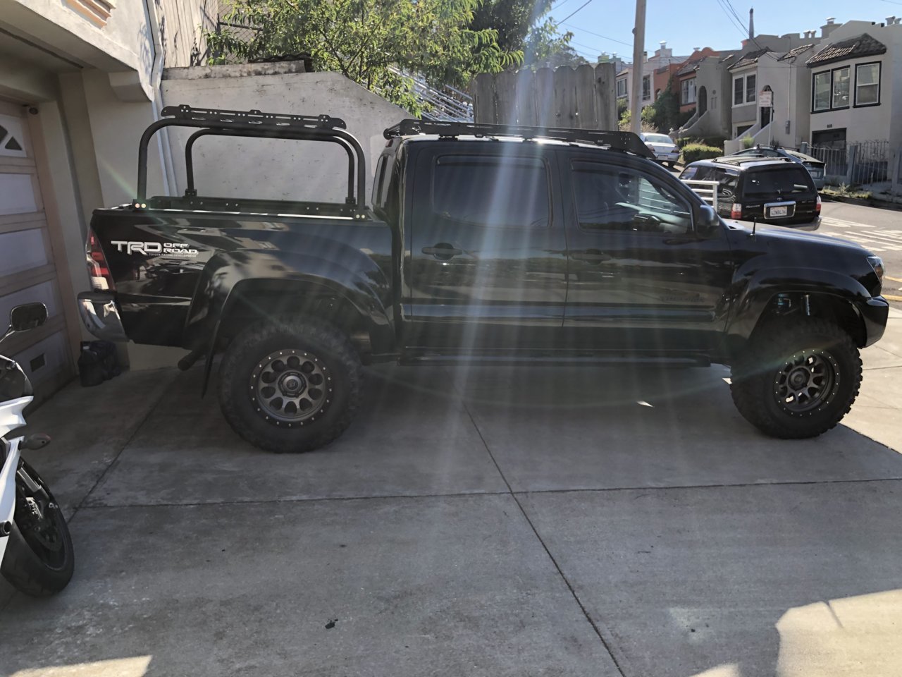

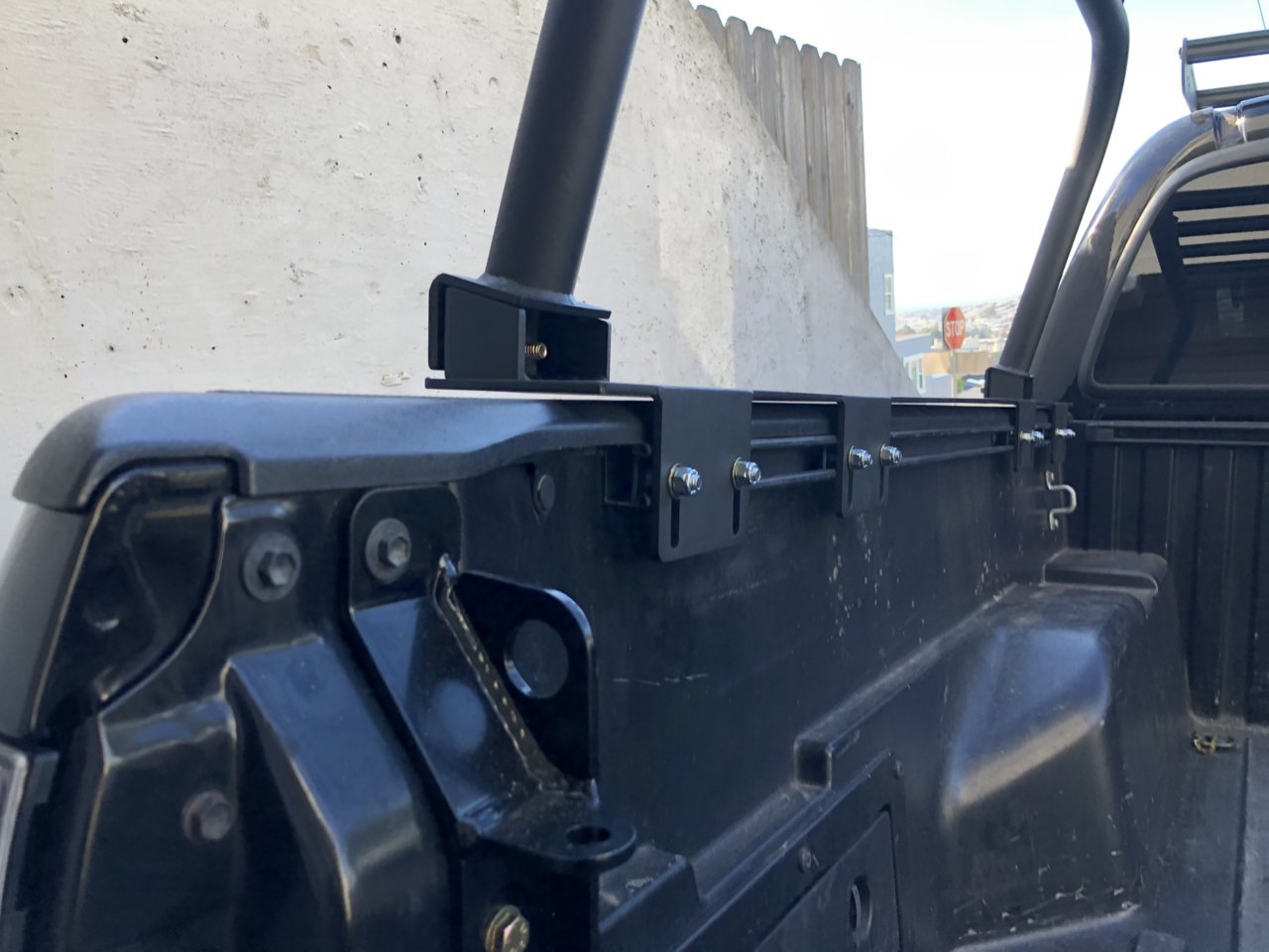

    Finally got my mobtown bed rack today. Took almost 6 months of patiently waiting. I installed it right away to see how it fits. Anyways, they thought they fixed all the issues with this rack... BUT NO. I am having the same issue with the mounting holes not lining up my bed tracks. This time on a 2nd gen tacoma. SMH. The rack is not sitting flat on the bed side and there’s a fat gap in between. Now all the weight and load is directly sitting on the tracks. Decided to put my softtopper see if it fits. Initially I was worried about fitment issues because I have the older style softtopper that is taller in height. Well I just verified it fits. Not looking forward to taking everything down and drilling out 16 holes... fuck me

    Dude that sucks, I am glad I went with another company....seems pretty crappy they can’t fix a simple issue and are letting people spend hard earn money just to go home and have to fix it.

    You do not need to drill 16 holes. I can send a replacement bases. I’m just now seeing your email. It came in after we were closed. After looking in to the issue, it appears as though your parts were made incorrectly. It is not an issue with the design or slots, it was a manufacturing error. The fabricator that positioned the tabs off of the top plate positioned them incorrectly as far as up and down which threw the whole thing off.

    this is exactly what I was wanting to do, as far as running the quick connects with their rack. Can you tell me the specifics on what you had to drill? Thanks!
