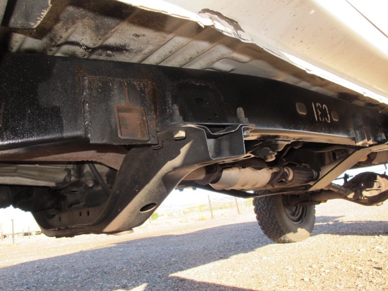

    FWIW, my Mobtown sliders flex pretty good, too. But I'm not surprised, expected them to be more giving than weld-on and added to the fact that the Taco frame is flexible, the bolt-on flexes more and the long arms creating a large moment. So far they've worked fine for sliders and if I need to jack up with a Hi-Lift I'll jam a block of wood between the slider and pinch seam to cushion a little.
    In the mini truck world a cat named Roger Brown, who is pretty highly regarded, actually makes his sliders to intentionally flex into the pinch seam. The seam is actually very strong and his intention is to spread the force that will inevitable happen over it, so he puts the intermediate rail directly under it.
    http://www.4crawler.com/4x4/ForSale/RockSliderZ.shtml
    I tried to avoid this flexing with the set on my '91, didn't put a middle beam, just long arms using square pipe and they were well gusseted. They flexed into the rockers eventually anyway. I knew full well what I was getting into and the reason I chose bolt-on was the ability to re-finish them periodically because the ones I welded on the the frame rusted and had to be cut off.
    You can see the dents in the pinch seam and barely make out the little bit of an indent in the rocker above it.

    Part of it is for the strength. If you space it just right the movement of everything, say 1/4" or whatever, means that last few hundred pounds is all the pinch seam has to deal with and it can do that. Since the way the cab sits on the the frame of mini trucks means there's not really enough room for the arms to go straight out doing this lets you maximize clearance without a body lift or angling the arms down much. You can see how I tried to deal with it with the scab plates welded to lower the tie points so the arms would be straight. Didn't work, but that was the theory anyway.

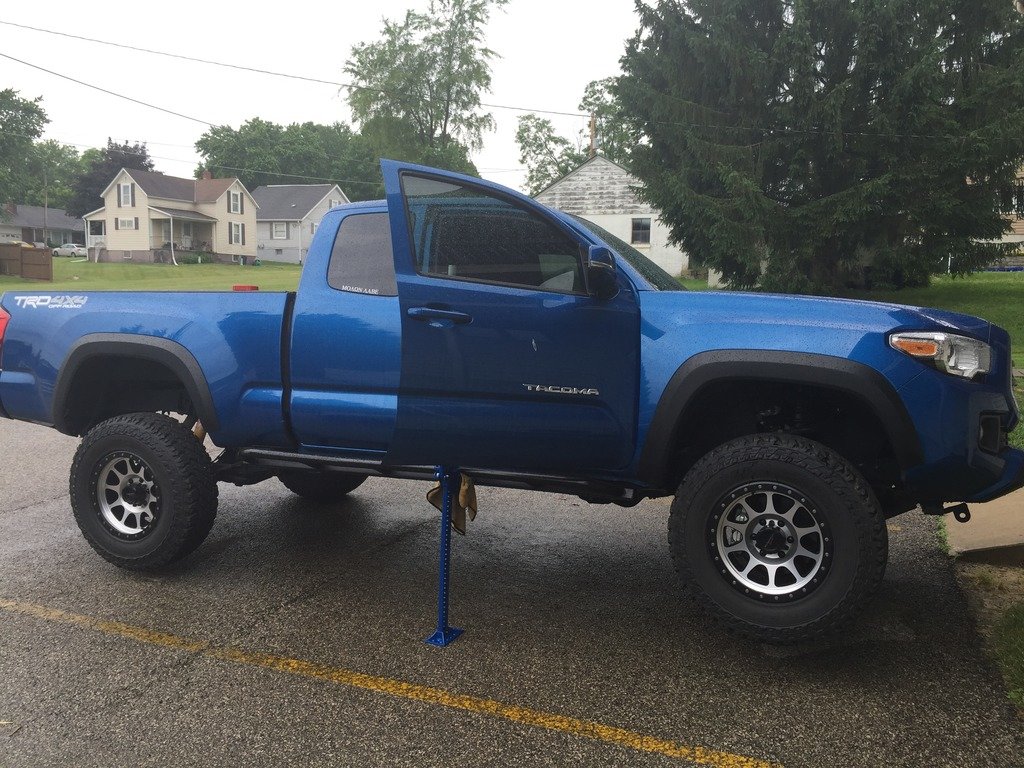

    I didn't read past the first page. But Mobtown sliders are stout, especially when correctly installed. This is the whole side of my truck off the ground, slider didn't move 1/8"
