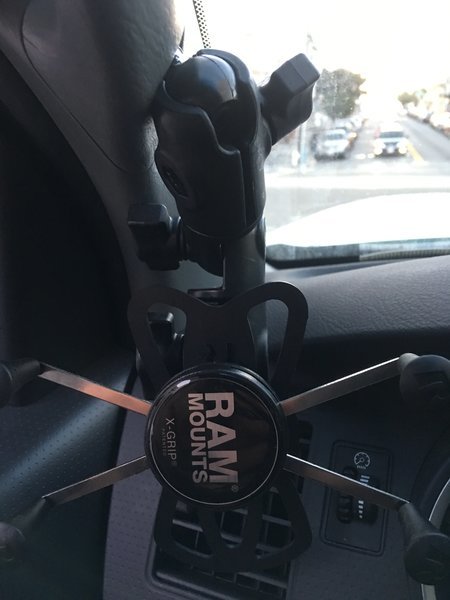

    sytfu510
    sytfu510 Instagram: tacoma510
    Aug 27, 2011
    #62453
    4,868
    Alex
    Bay Area
    06 DBL Cab Long Bed TRD Sport
    Dirt Designs LT kit front and 3 link kit rear SCS Wheels BAMF rack, bumper ,sliders
    G.T.[OP], docloco, scott96929 and 4 others like this.

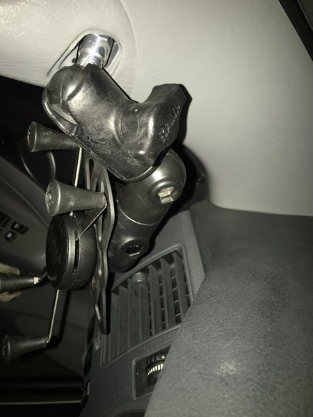

    BarNee
    BarNee Active Member
    Oct 21, 2012
    #89452
    41
    Barney
    N. Louisiana (Shreveport)
    12 PreRunner MGM
    running boards, Bed Extender, Elect. Pop-n-Lock, Fogs, CC, Int. Wipers, LED's, aftermarket tails, CodeAlarm 1151PRO, Dia. Plate Sill Protectors, Jumper's LEDs, Devil Horns.
    Added one to the truck
    User a 60mm bolt and 2 nesting spacers slightly cut down. Going to mod the cover to put it back on. Used a wire-in power supply in the headliner area to run the Garmin Nuvi 50 with a specific holster by RAM. Very sturdy.
    T@co_Pr3runn3r and G.T.[OP] like this.

    which arm did you use?

    the short arm, same one he posted in the first post. Although I didnt have a long enough bolt to space out the ball yet, have to do it later.

    I just got my 60 mm bolt at fastenal plus a little 12 mm nut to fill the space between the thread and bottom of mount. (50cent)

    So you used an M6x60mm bolt?
