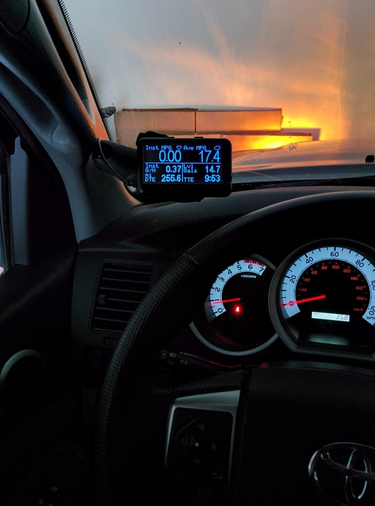

    I did this mod with my ultraguage so hope you like it. I used the RAM MOUNT: RAM-B-347U
    and a Scosche surface magic mount. I didn't read the directions very well and up using one 6mm nut with a plastic insert and a regular 6mm nut. Two 6mm nuts with an insert are too long and will not fit so learn from my mistake. I wanted to be able to detach my ultraguage and think the magic works perfectly with this. I did realize after the purchase that the RAM MOUNT: RAP-B-201U is actually plastic so will see how that holds up. Pretty easy mod and does not get in the way when I am driving.

    Looks good. There is a metal version of that mount arm but the heavy duty poly mounts hold up very well and tends to be slightly less expensive.
    I'll be updating the thread soon once I get this little guy in hand and some free time at home to be able to take the lower dash apart so I can wire it in and run the long phone charging cables I bought to the A-pillar mounts - one on each side - to keep the cab free of loose cables.

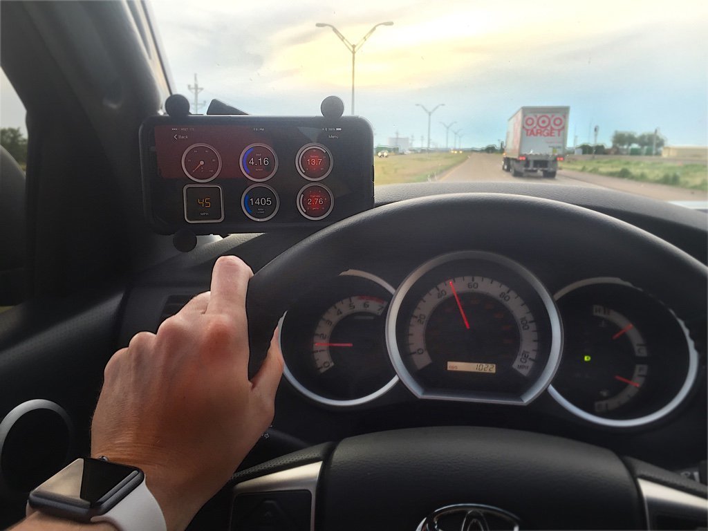

    This is such a great idea. Thanks for posting. I set mine up today and I love it.

    Looks great. What app is that running on your phone?

    It's called OBD Fusion. It's streaming the info from the "Automatic Link" (Gen 2). I'm still not sure if I like the "Automatic Link". It doesn't read the fuel level on my Taco and so it doesn't report my mpg's correctly. That was one of the biggest features and it's really expensive for something that doesn't work right. Most of the stuff you can see live on OBD Fusion is stuff that you can already see on the dash anyways like speed, RPM's, Engine Temp etc.
    It seemed like a good idea but after just taking a long road trip, it wasn't that helpful. Still love the placement of the phone though. It was perfect when I needed Nav.
