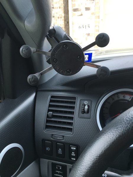

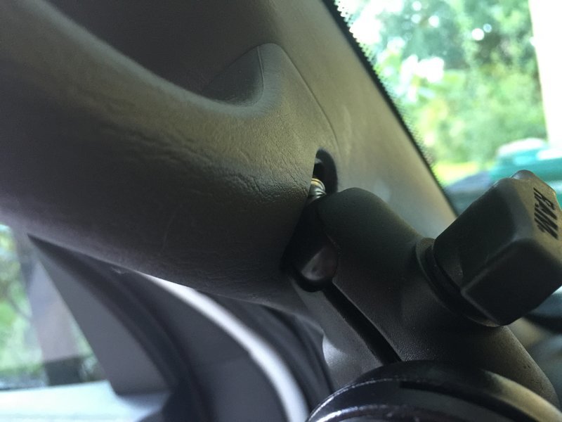

    Got my A-Pillar mod completed and Techdeck XTreme installed!
    I went with a M6-1.0 x 60mm bolt and stacked nylon spacers to get the ball a little further out. I was using a 50mm at first, but it seemed to limit my position options. I'm probably going to go with the articulating arm as well vs. the super shorty. I got the bolt and spacers from my local Ace Hardware store.

    Still need to run my external antenna wire and fab up or buy a driver's side fender lip mount. The CBi looks really nice, but it's $40 plus shipping.....

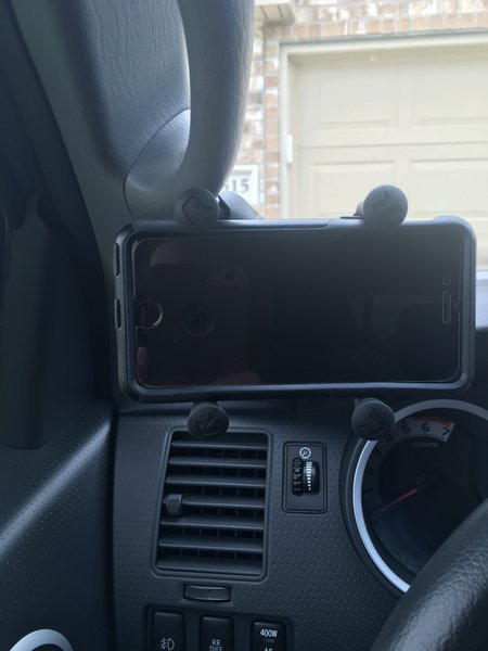

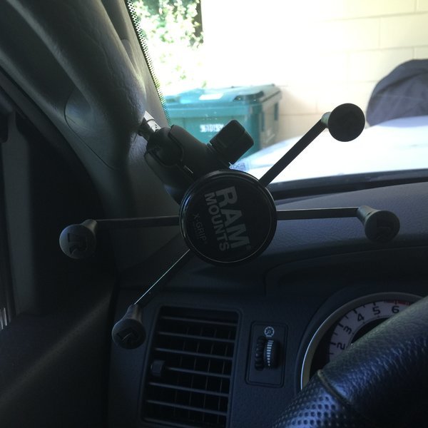

    So I tried to grab the 6mm 50mm bolt after work today at lowes since all my ram parts had come in the mail today. Lowes biggest cap screw was 1", ugh, figured I'd hit ace hardware by my house instead. Longest ace had was 45mm so I figured I'd try it. Put it all together (1" arm) and it works, but I definitely need a longer bolt. I wanted my phone (iPhone 6 plus) to be vertical rather than horizontal and I still need the ball to stick out a hair more to do that. Onto a different hardware store tomorrow after work!

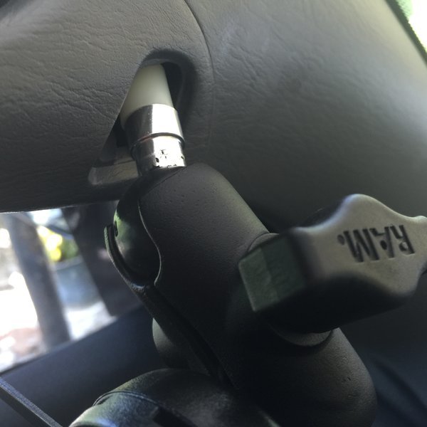

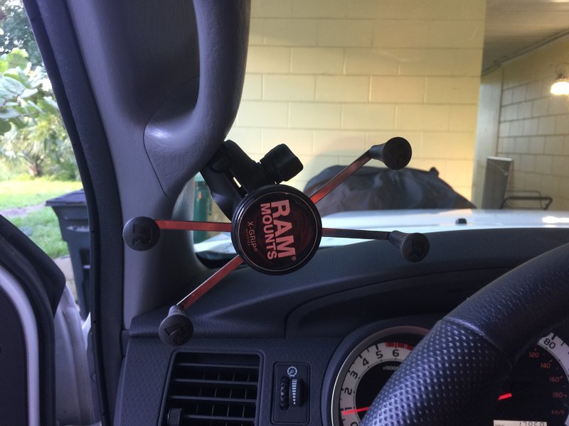

    Got a normal 60mm bolt and nylon spacer plus lock washer and nut today. Much better!
