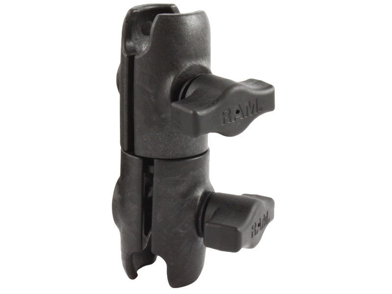

    I have found the same thing on the tech deck. I have 2 articulating one's (double socket swivel arm) and replaced one today and ordered the parts to replace the other Saturday when the parts get here. And I'll complete this mod then too.
    Using
    Ram Mount Double 1-Inch Ball Adapter
    and combinations of the 2" and 3" short arms can do anything the swivel arm can if not more, without the vibrations.

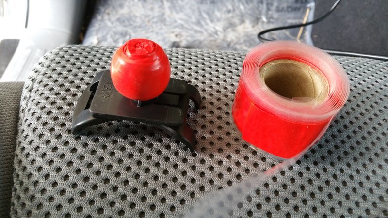

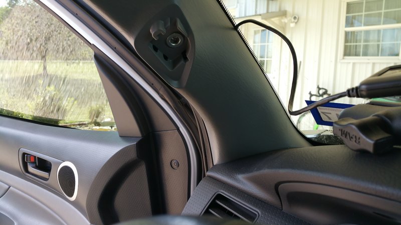

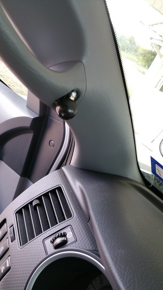

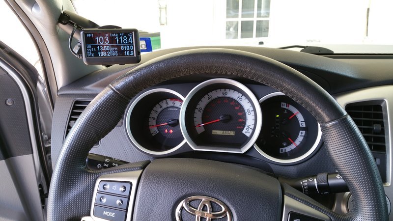

    Finally got around to doing the ram mount pillar mod today. I've wanted to do this ever since I got the Ultragauge. Got tired of it sitting in the cup holder. 3M tape doesn't hold up well in the humid Central Texas summer heat.
    Used the Ram Mount Motorcycle Handlebar ball with the M6 bolt. Standard procedure. Went with the basic double socket Ram Mount.
    However, I wanted to use the mount that came with the Ultragauge but the swivel ball is a smaller diameter than the standard Ram Mount. Fix...I used some silicone Rescue Tape I had in the shop. (mine was red )
    This stuff worked great to build the swivel up to match the Ram Mount size.
    Trimmed it up and ran wires behind A-Pillar, down the door behind weather strip, and zip-tied excess wire underneath dash.
    Clean.
    Thanks for everyone's posts on this. Nice mod indeed. Probably end up doing one on the passenger side as well!
