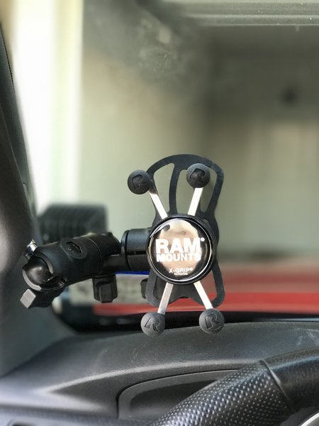

    Finally got my truck back so I got mine installed :D

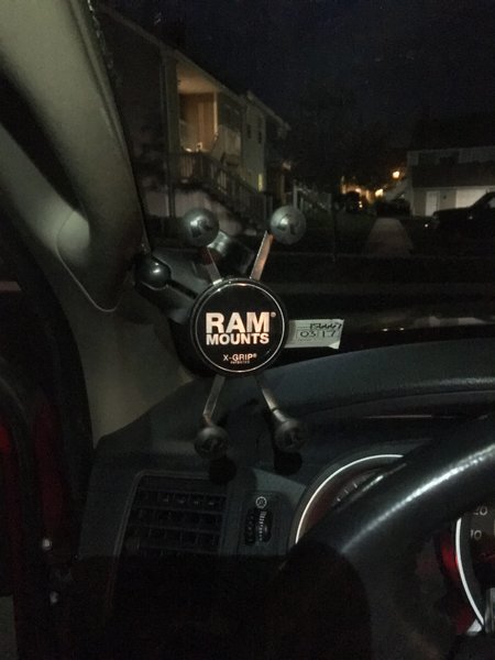

    Did this mod in the dark in 5 min. It's a must.

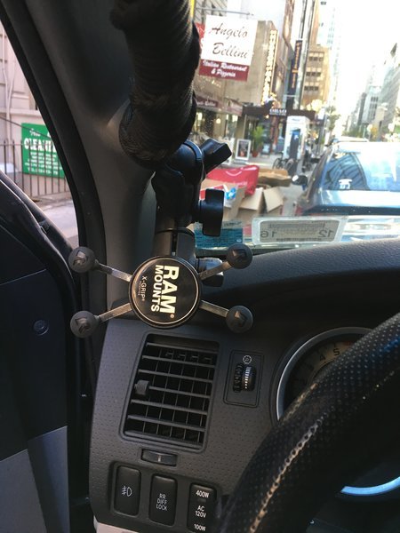

    I did this a few months ago and realized I never posted anything.

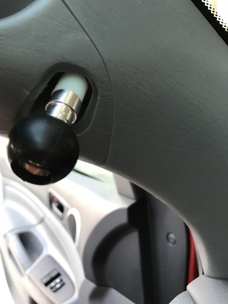

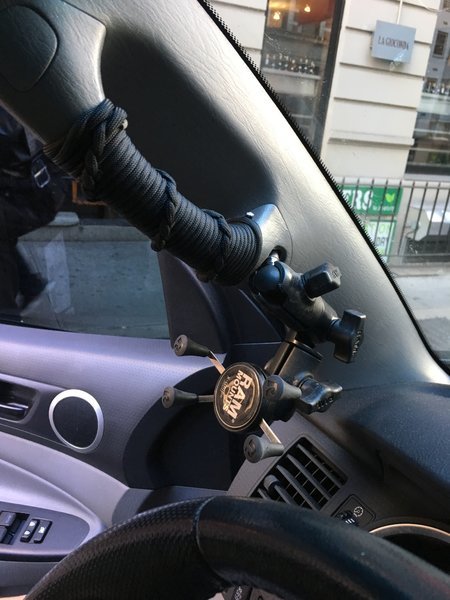

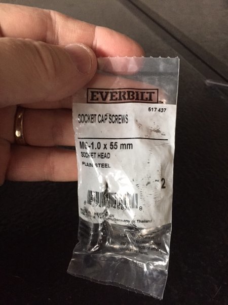

    Finally scraped everything together for this...thanks OP, worked like a charm...
    Found this fairly quickly at Home Depot, it's the Hex (Allen) type bolt (55mm works for me). Also found the 1/2" Nylon spacer in the same drawers at HD. Manage to route a 6' lightning cable from the stereo, inside the dash, and up the pillar to protrude along with the mount.
