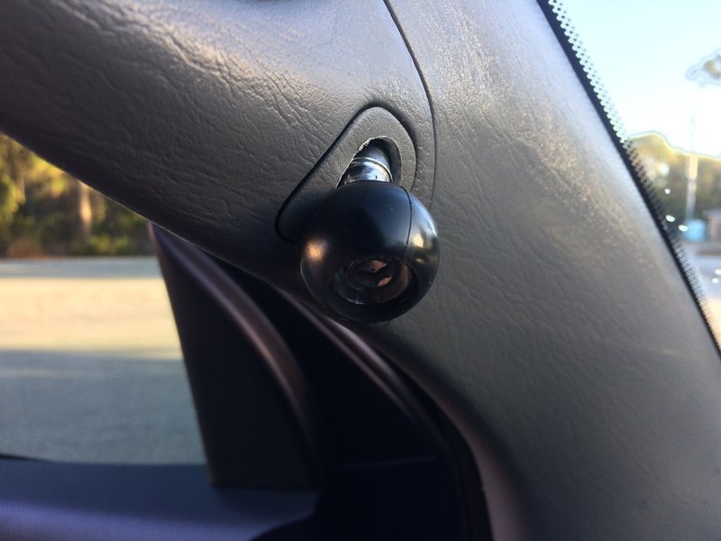

  5. Jan 13, 2017 at 5:43 AM
    #345
    Soul Surfer
    Soul Surfer Jimi Was Last Seen: Roam in’ Around…
    Aug 10, 2015
    #161457
    16,898
    Jimi
    West Central Florida Coast
    •TRD OR Tacoma•

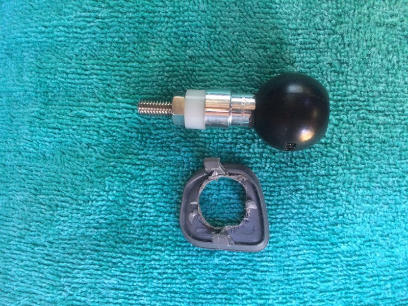

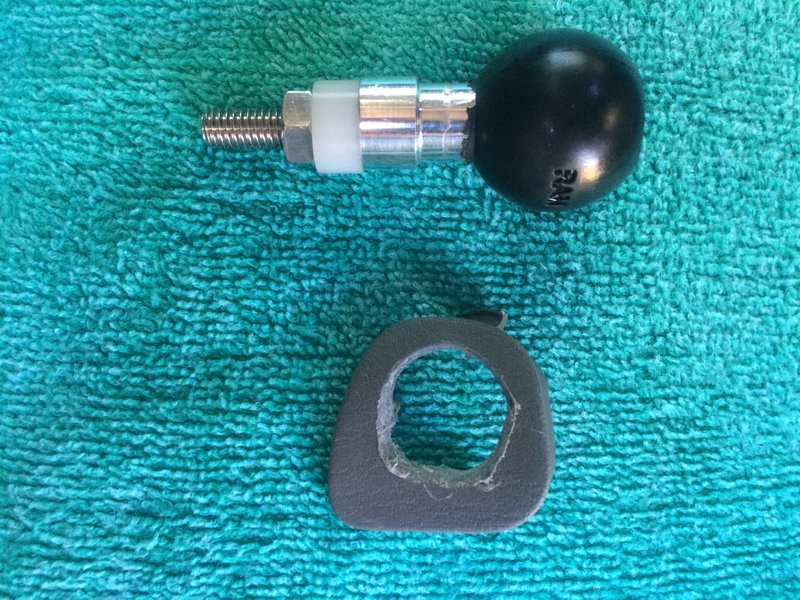

    Mounted the 1" Ball. also drilled and filed the Pillar assist bolt cover Tab, and reinstalled It. Waiting on the Gadget Cradle! :thumbsup:

    127,315

    Im pretty sure the bolt size is M6
    The Ram Ball Mount was designed for and M8
    BUT
    The Toyota bolt is M6
  8. Jan 13, 2017 at 5:50 AM
    #348
    Soul Surfer
    Aug 10, 2015
    #161457
    16,898
    Jimi
    •TRD OR Tacoma•
    :hattip: It's tedious, but It came out decent. I picked up a extra one from the dealer for a back up, but was able to make it work. I have that part# back at the house. I can post it later if anyone needs one. Thanks Chad! :cheers:

    I will take that part number please!! going to emulate what you did and see how it comes out!
    Soul Surfer[QUOTED] likes this.
  10. Jan 13, 2017 at 5:56 AM
    #350
    Soul Surfer
    Aug 10, 2015
    #161457
    16,898
    Jimi
    •TRD OR Tacoma•
    I'll get that to you tonight. It's for the gray interior. Yeah just carefully drill the hole on a slight angle, and then use a chain saw file to keep adjusting the opening. It took about 5 tries. Also you need to make sure the ball has enough clearance! :thumbsup:

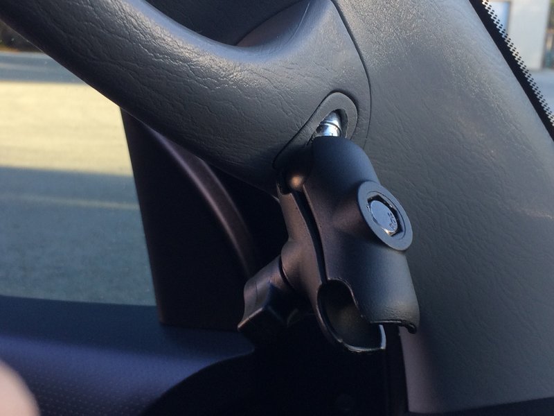

  11. Jan 13, 2017 at 6:02 AM
    #351
    Soul Surfer
    Aug 10, 2015
    #161457
    16,898
    Jimi
    •TRD OR Tacoma•
    This is how it looks.

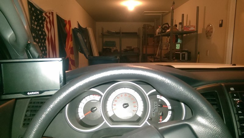

  12. Jan 13, 2017 at 11:42 AM
    #352
    doghair
    doghair Well-Known Member
    Jun 7, 2013
    #105780
    340
    Phoenix
    2013 Single Cab 4x4
    Figure I'd toss this here for prosperity.

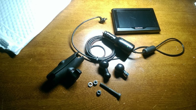

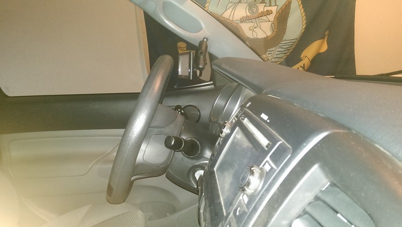

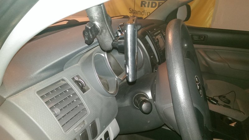

    Got a new Garmin since my old one died a horrible death from too many Phoenix summers. I decided to bypass the x-mount since I don't care about mounting my phone. So away we go.
    New Garmin 57 LM
    Arkon 17mm to 25mm ball adapter
    Ram motorcycle ball and 6" socket arm
    M6x50 and nuts/washers
    For this I put one nut on after the ball and three split washers, this is a good distance for me. I also subdued the base with a little flat black.
    The cig plug power cable easily tucks over the column, it's not in the way so I doubt I'll run power. I can unmount this, pull the cord out and toss the whole mess in the glove box in seconds.
    Pretty much perfection for what I wanted.

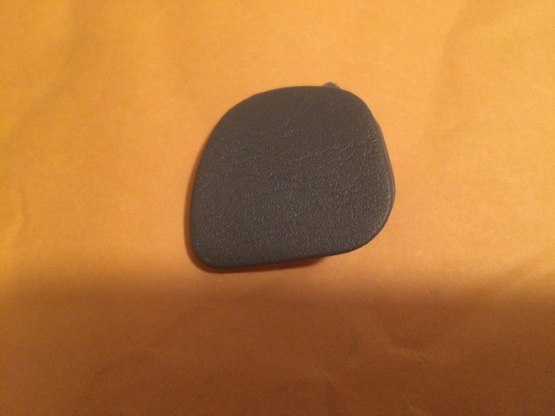

    Here's the Part# Chad.
    74617-04050-B0 L1 Pillar Plug , Assi.
