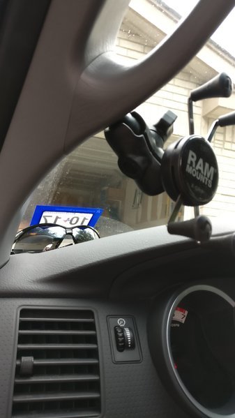

    Done and done! I ordered everything from Amazon, including the M6, which was not available at any of my local shops....
    0de14da3-8e5c-49b7-a368-6b4036051afd_zps_b623e406fd649dc63ee159c313f0a99378aab429.jpg
    I decided that I wanted my iPhone cable easily accessible and moveable, so I used some cable clips to hold it where I want to be. I feel like this won't be a permanent solution, but it's better than just draping it over my steering wheel!
    6fc1a961-ba12-46d5-a77b-f18f1e841811_zps_826f70ca9373ea94936cbc5e83abef1ddf735e89.jpg
    Thanks, OP! I absolutely love this!

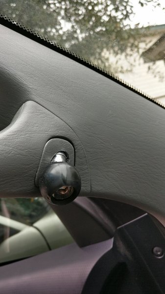

    I had to change out the iPhone Cable that runs to the back of my H/U today so I went ahead and drilled the bolt cover to give the install a finished look.

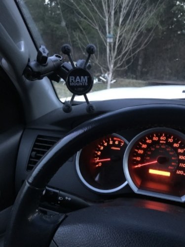

    This mod is great. I used a small nylon spacer and a slightly longer bolt to get the ball a little further out of the recess. This allows for a better range of motion for the short arm I used.
    I wanted to make sure there was plenty of room for gloves - so far I have had no issues with clearance. I can even control the unit with my finger while my hand is still on the wheel.
    This is for my garmin montana, which I also use on my motos - the hot shoe is wired up through a fuse tap. Right now it's tapped into my brake light circuit, but I think I'll connect it to my aux power circuit. The unit automatically powers down or up when the circuit is activated/deactivated. I ran the wire through the weather stripping. Super pro, solid, and clean install and very happy. Thanks OP.
