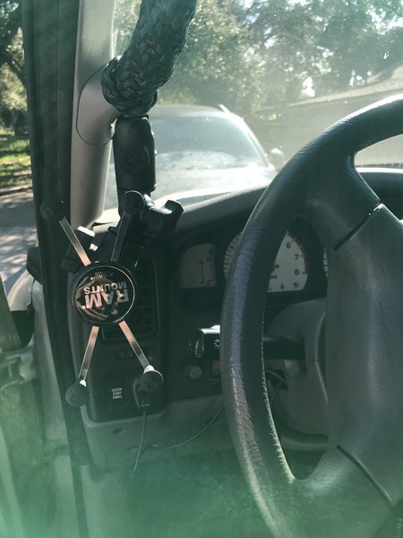

    I finally managed to do this on my 1st Gen ('98 PreRunner) looks like we have the same M6 bolt pattern but our handles are shallower so it looks like you could use a shorter bolt (maybe even the factory one) but I didn't bother since I went ahead and bought a 60mm.
    I'll post more pics tomorrow when I get the articulating arm. Just wanted to get the ball mounted so I don't have do much work when the arm comes.

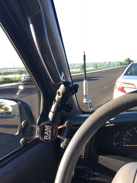

    Here it is in my '98! We have a lot less room and clearance from the steering wheel to the grab handle so it's a little difficult to get a good angle, but it works!
    I used the three piece articulating arm to have more room and mounting possibilities. I couldn't find a good way to position the mount above the dash and behind he steering wheel so I have to run it like this.

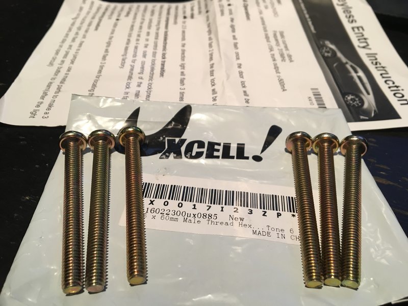

    I got excited when I was ordering all the RAM Mount parts off Amazon and it didn't occur to me that Home Depot would have the bolts and all the M6 hardware I needed. (I ended up just buying a black bolt there to match the finish)
    I ordered six (6) M6x60mm hex bolts that's used for this mount. It costs more for me to return it to Amazon so I thought I'd pay it forward.
    If anyone needs an M6x60mm bolt if you're taking on this project quote this and message me your address and I'll mail it to you free of charge. (Lower 48 States only) I'll throw in some leftover M6 hardware (while supplies last) too.
    I'll mail all of them out as soon as all 6 are claimed. :cheers: (Limit 1 per person)

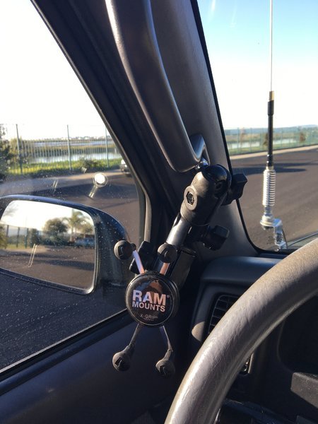

    So finally got around to doing this and its kind of a bitch for a 1st gen. was a lot of trial and error to get it perfect to get enough of the ball exposed. Also did this for my cousin on his 2nd gen and i was jealous how perfect it was with your instructions but not so much for me haha.
    Used a 60mm bolt with stacked washers, and had to go with the swivel adapter the long arm adapter pushed to far to window and blocked a lot of view or too close to steering wheel and was in my way so i did this. It worked out great IMO.. also didnt help having an iphone7+ shits huge
