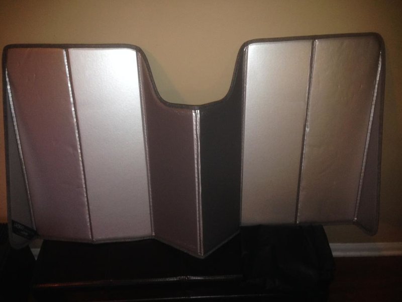

    Brilliant! For those that use a sun shield with this set up, does the mount and accessory get in the way?
    I have something like this.

    I use a similar type of sun shield and if anything it helps hold it in place better. But then again I start putting it in place starting from the drivers side and work my way across.

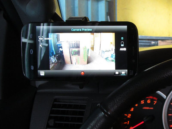

    Just want to say thanks to the op for this wonderful thread. Mounted mine today. image.jpg
