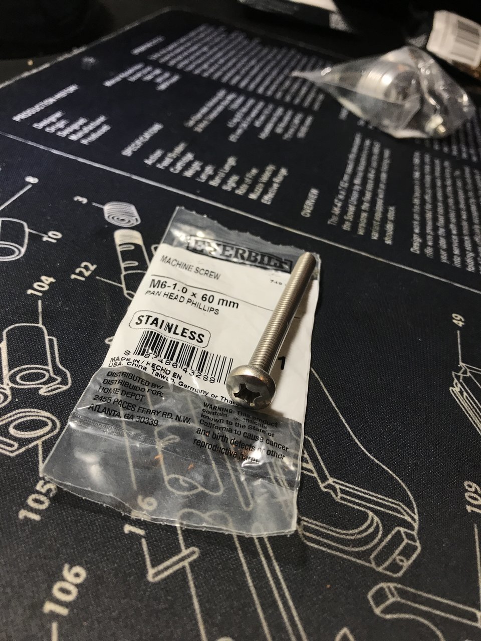

    Might be a tad long bit it will fit.

    2012 and newer it will fit perfect.

    Regrettably, neither do I. When I was first experimenting with mine for the 2nd gen I pulled the factory bolt which was 25mm long and figured that doubling the length would work. It did but reading through the thread the general census is that adding another 5mm to length is a little better.
    With that said, I’d try using the same formula to put yours together. Once you do please drop a line back here to let us know about your success.

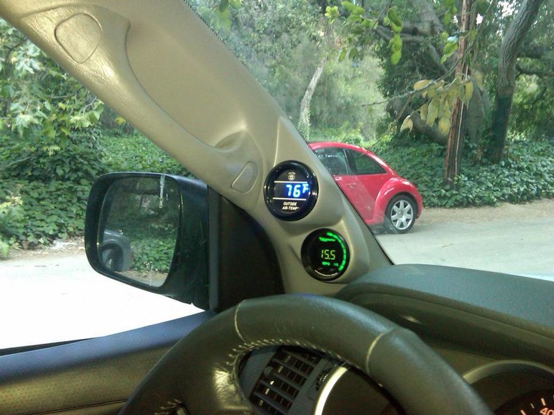

    I'm glad someone tried this, I will give it a shot and if it blocks my view, i will put it somewhere else. I went with the pillar pods so the bottom won't work

    Yeah I had my eye on the upper one as well, lower won’t work with your pillar pods there for sure, will be a dope cyberpunk setup when you get yours in, hardwire that ish too! That’s next level for my current skills but a definite future mod.
