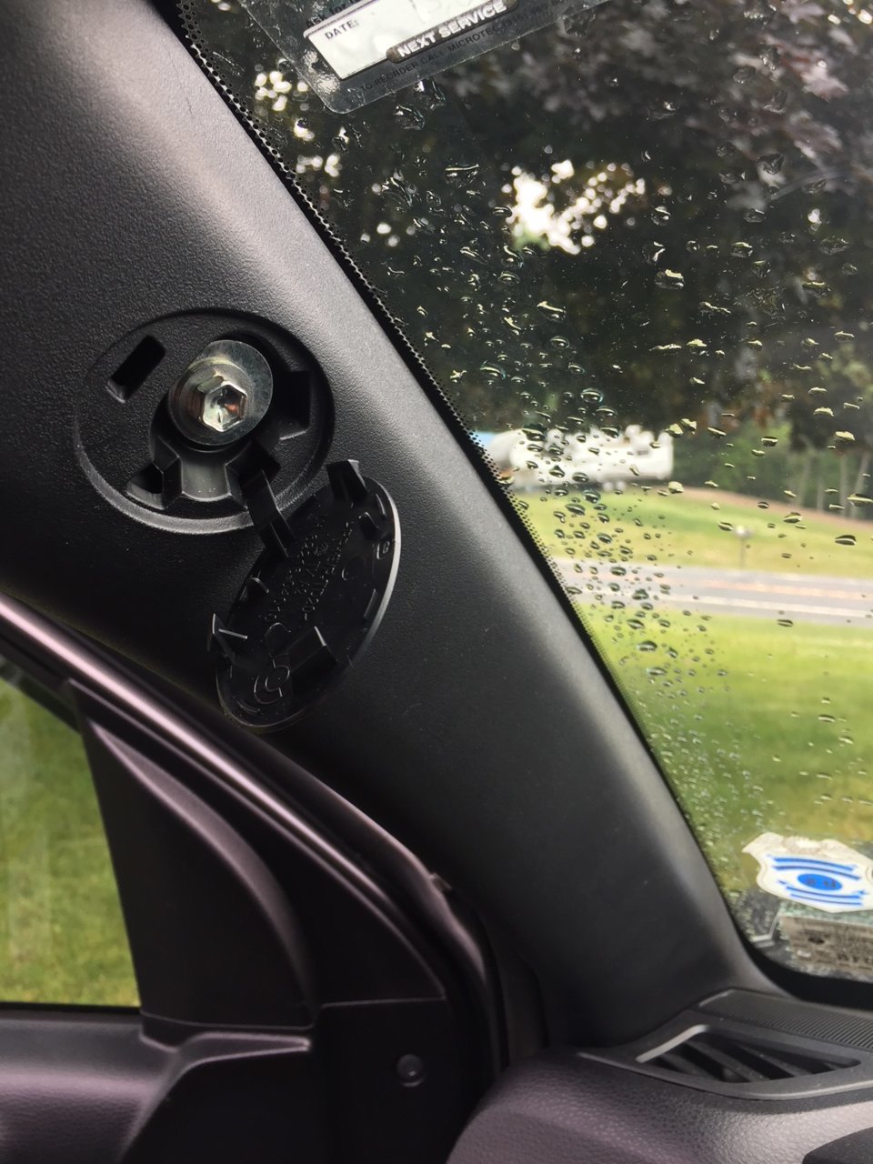

    HappyHiker72
    HappyHiker72 Active Member
    Jan 20, 2018
    #241848
    40
    Randy
    2017 Toyota Tacoma TRD Sport
    No grab handle in there 2017, but there is a bolt hold the cover on. I was wondering if it could mount here.

    If you're looking for the hardware required for this mod, I still have 22 bolt kits.
    Kit includes (everything you need except the RAM mount parts):
    (1) M6x1.0x55mm bolt
    (2) M6x1.0 nuts
    (2) M6 washers
    Price is $5.40/kit shipped via USPS First Class Mail.
    Paypal or Venmo or NANO accepted. PM me for ordering details.

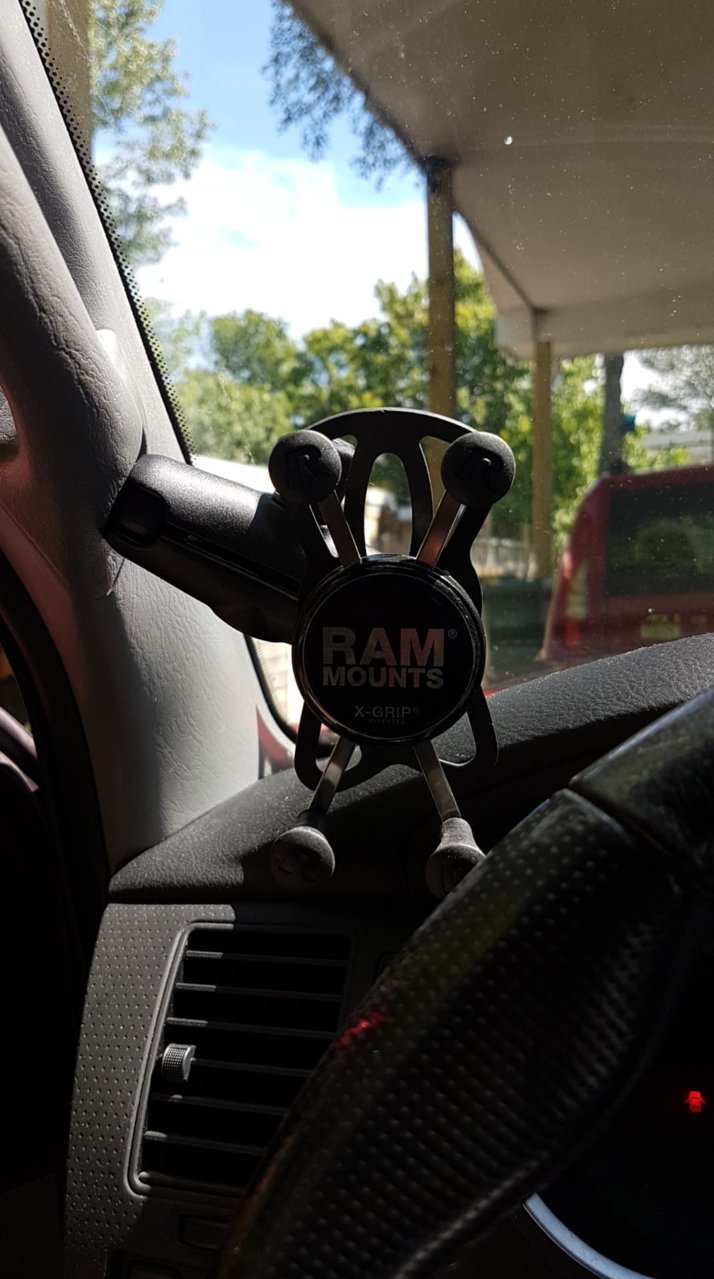

  20. Jul 3, 2018 at 4:51 AM
    #780
    gnewman545
    gnewman545 Well-Known Member
    Jul 10, 2017
    #223670
    64
    Gary
    2013 Red DCLB
    BWG Winch Plate Teck Deck K&N Vent Filter
    I love this mod. I wish I had stumbled across it earlier. The socket head cap screw (the bolt) was not easy to find, as others have mentioned here. I went to Fastenal and they actually gave me two of them for free. I used the 50MM bolt but I couldn't get it to bite with two nuts and a washer on it, so I just went with one nut. It doesn't seem to be going anywhere yet. The RAM mount I chose has the x-grip and the single long arm. I got it from a motorcycle store in Halifax. I had to order the ball that the cap screw goes through off Amazon. I've seen some people on this thread have used the "double jointed" articulated RAM mount that would let you move your device further away from the steering wheel. That might be a good idea. I hit mine once when going for the blinker but now I've got used to it and I never hit it. The X-grip holds my phone or GPS unit firmly and I'm not worried about it falling off. I thought to myself if motorcyclists trust them, I can trust them.
    Again, I highly recommend this mod. I will be adding a power cable to it this week so I can charge my devices without running cables across my dashboard.
