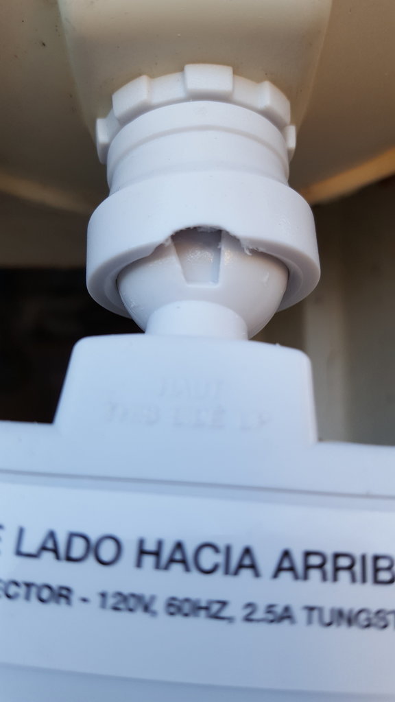

    I have a question for the OP or anyone who has used the "double socket arm" that the OP used. Some have said that this mod puts their cell phone or gps dangerously close to the steering wheel. What keeps this arm from moving towards the windshield more?
    Would it be possible to use a Dremel to carve away whatever is restricting the movement? That is what I had to do with the ball mount on a motion detector here at home. I couldn't aim it high enough so I removed some plastic to allow it to rotate a bit more.
