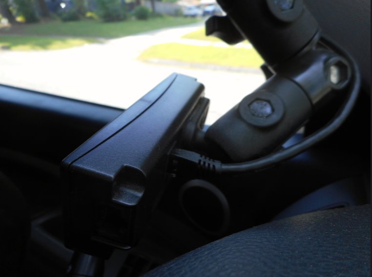

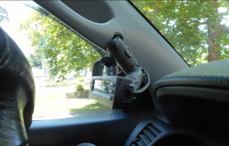

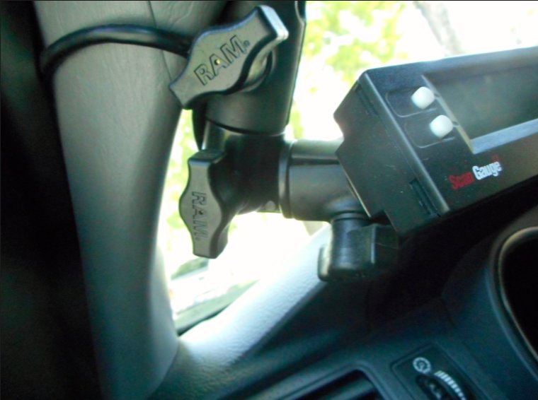

    Screen Shot 2018-08-06 at 1.08.32 PM.jpg Screen Shot 2018-08-06 at 1.08.23 PM.jpg Screen Shot 2018-08-06 at 1.08.51 PM.jpg
    Ones through the windshield didn't come out very well, didn't post those up.

    Great pics, thank you. Now I see the extra knobs aren't too bad and would be mostly hidden by my GPS. I may have to buy yet another RAM part :annoyed:

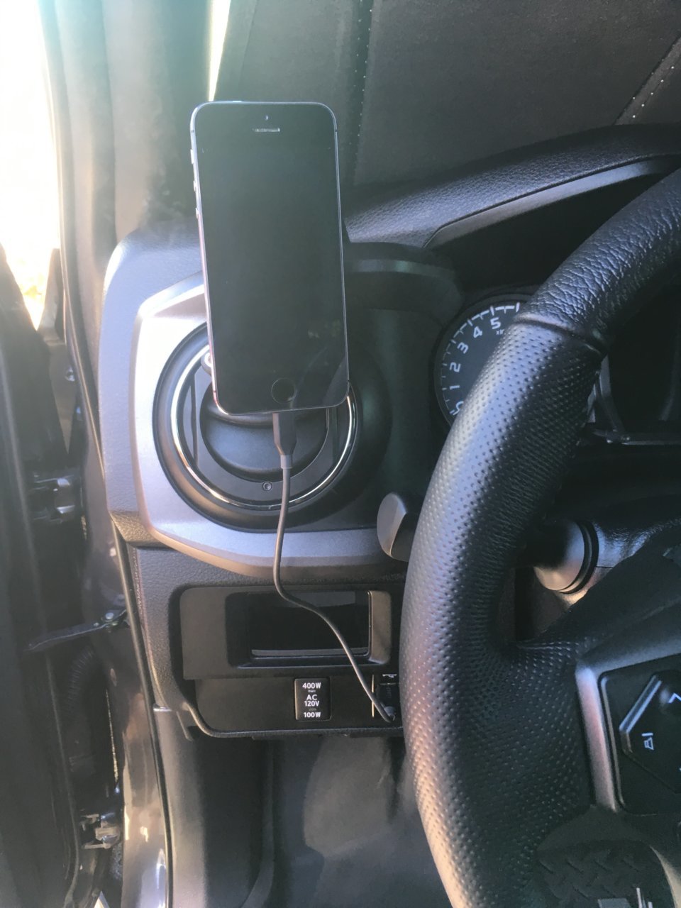

    I also did this. Didn't want my phone right up against the wheel. Plus I'm able to position my phone to take video when I'm offroad.

    The Scosche mounts seem really popular - any reason you chose that rather than RAM's magnetic mount option?

    How did that end up working out for you? Why did you decide to use the Scosche magnet mount rather than RAM's own magnet PowerPlate II mount?
    Same question as above? Scosche is popular, but why go between brands rather than doing everything with RAM?

    Worked not so great with my iPhone 6s w/ Magpul case (the ribbed case was too thick). I now have a heavier iPhone X but my case has a thin plastic backing and the hold on the magnet is super strong.
    As for why I went with Scosche, it's simply I didn't know Ram had a magnet that would work lol

    Didn't even know Ram made magnetic stuff, but from doing 2 minutes of research, even the "small" mount looks massive compared to the Scosche and the adhesive plate is freaking huge. Absolutely no way I'd be able to put my phone case back on with that thing. It looks at least 4 mils thick (conveniently no specs on the RAM page, only "shipping weight".. how useful). With the scosche, I can stick the plate directly to my phone and put any phone case over that. The scosche plate is barely thicker than a piece of paper.
    Btw not sure if the RAM base plate is an actual magnet... if it is, your phone's gonna stick to all sorts of metal shit. The Scosche base plate seems to be made of some sort of "only sticks to other Scosche mount" material.
    It is not magnetic... yet it is.
    Magic.

    Pulled back the GPS power cable, and ran it up into the A pillar. Made sure to follow the airbag wiring just in case. Hardest part was dremeling out the pillar cover to accommodate the right angle GPS plug. A regular micro USB plug would have taken less work.
    I'll see how I like this on long drives, then figure out if I need a different RAM arm.

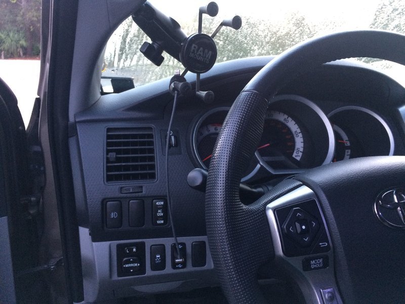

    How is this one mounted?

    How did you set up the usb port?

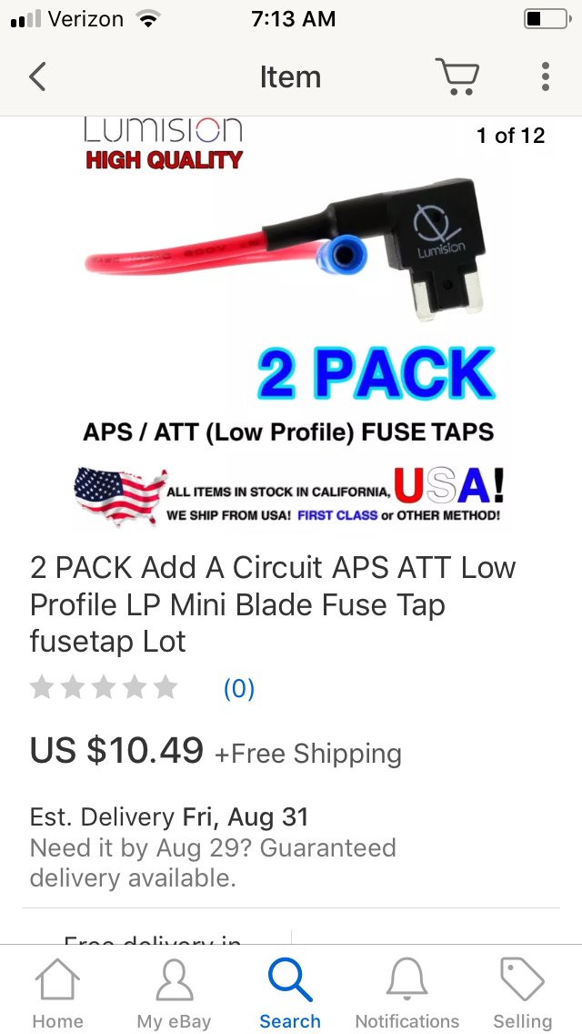

    I like that! Too bad its 65 bucks for two of them

    Used a low profile fuse tap for power, and ran it to the 4x4 fuse witch only supplies power when the ignition is on. Their is a convenient small bolt under the dash that I ran the ground wire to.
    Here’s the fuse tap I used:
    I also installed one in my ‘17 Tacoma.
