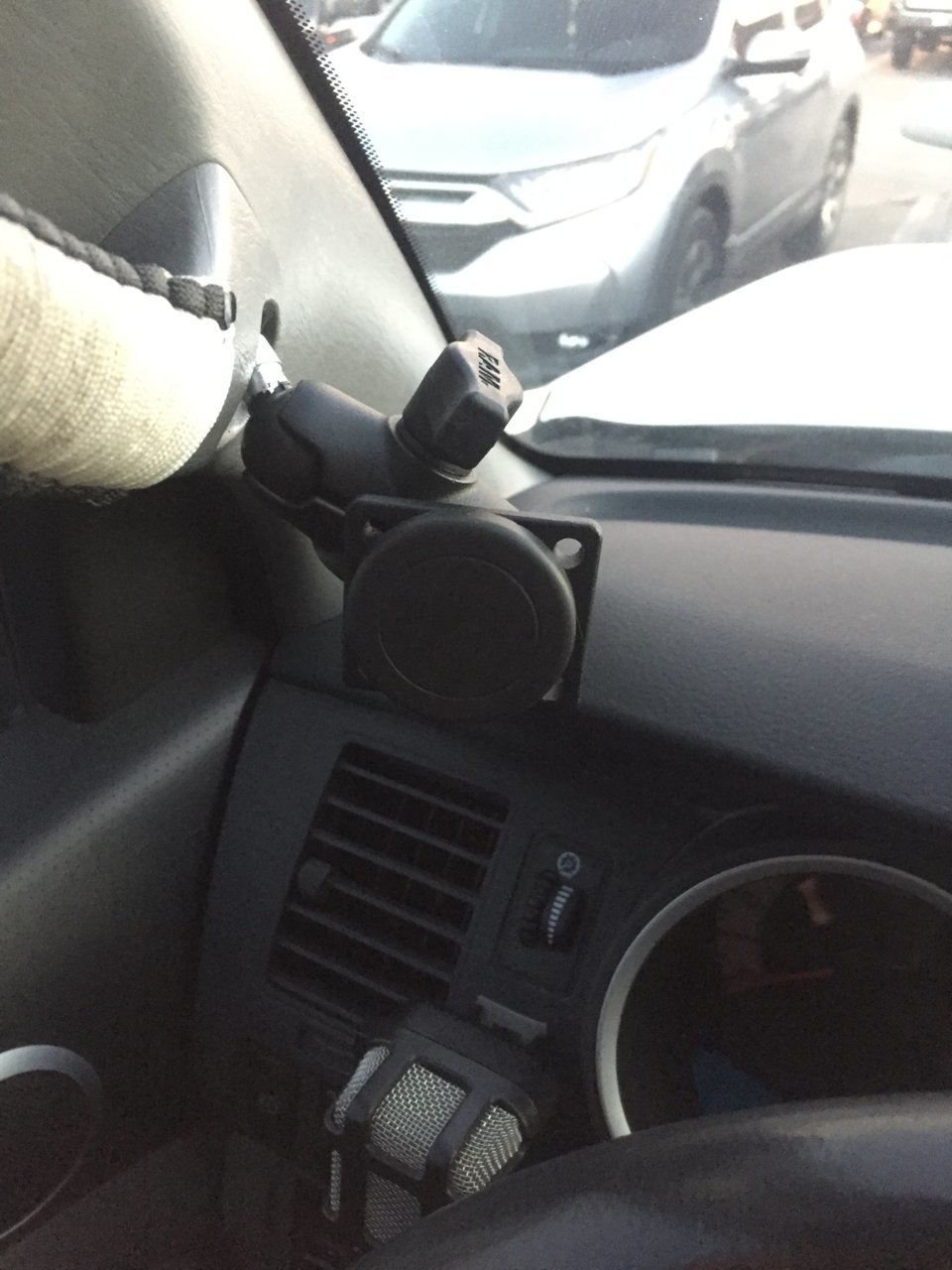

    Really like the magnetic attachment. What is the part number for that, did you use a base mount?

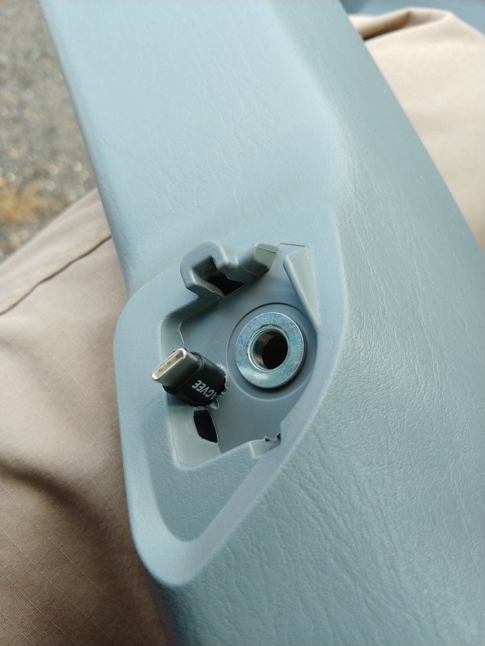

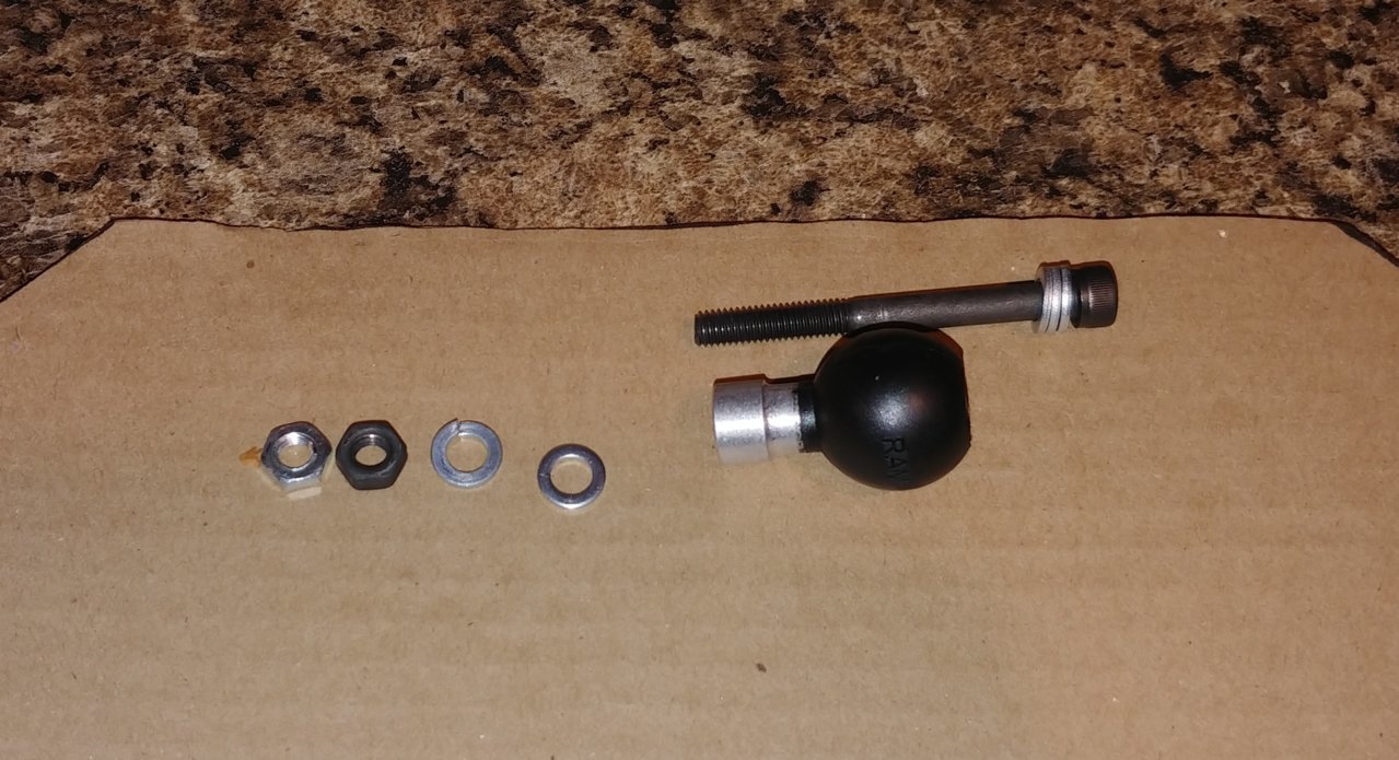

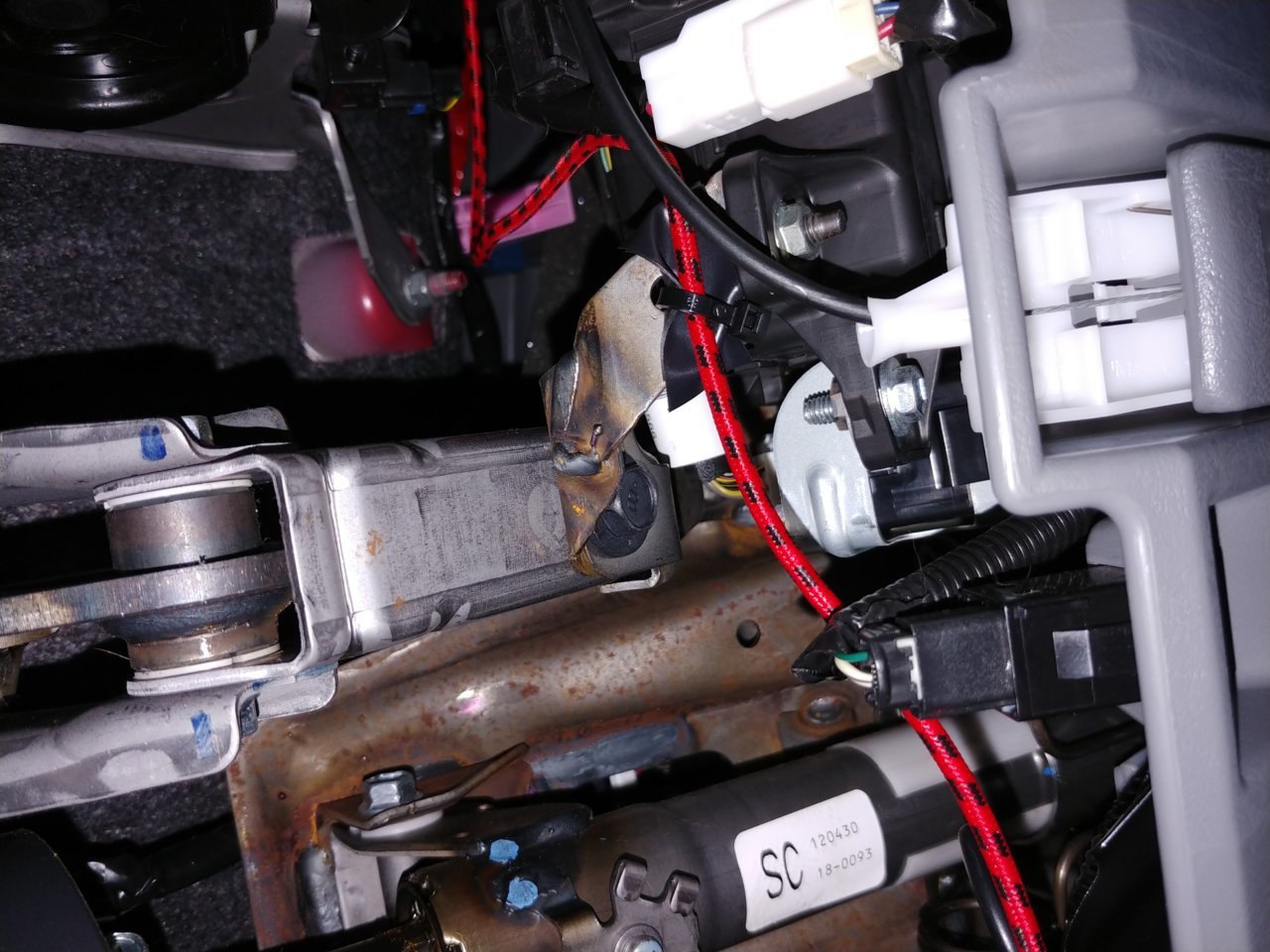

    Finally got around to doing this! Pretty happy with the results.
    Local hardware store didn't have a M6x55mm bolt, so I ended up with a 60mm. Stacked up a few flat washers, a lock washer, nut and jamb nut as pictured below. Gave an equally good result. Far enough out of the grab handle to swivel the arm around, but not too far. Went through a few iterations of RAM mount arms to get my big ass LG V30 to fit the way I wanted. Ended up with the 3" single arm as suggested in the OP and the Large X-Grip. Looks super clean, still have room around the steering wheel even with gloves on, and hardly lost any field of view out the front windshield.
    I tried the double socket swivel thing (RAP-B-200-2U), but didn't have luck getting it far enough back with such a big phone.

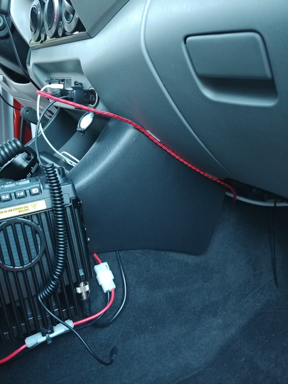

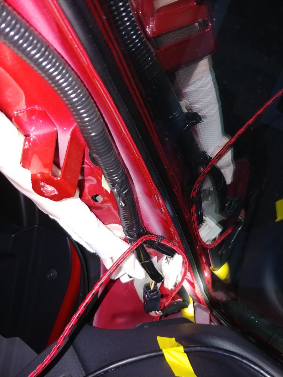

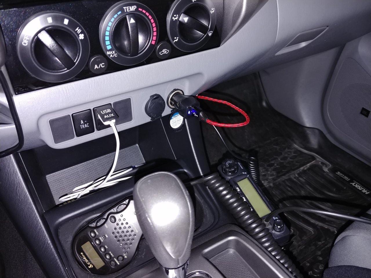

    Also ran a USB C charging cable up through the pillar while I was there. Ziptied it to the stock harness down through the pillar to hopefully keep it away from the airbag. Then under the dash, across the trans tunnel and over to the passenger side where to 12V outlets are. Plug it into a USB adapter when in use, or it just lays in the cubby. Drilled a few small holes in the pillar just big enough for the USB plug to fit through. Ziptied the excess up under the steering column.
    RAM p/n's used in final install:
    3" arm: RAP-B-201U
    1" (size B) ball: RAM-B-367BU
    Large X-grip: RAM-HOL-UN10BU
    M6x60mm, 3x flat, Ram ball, flat, lock, nut, jamb nut
    Few pieces of e-tape to keep the cord away from sharp edges. Left in this pic is the front of the truck, top-right is the hood release.
    Trying to keep the cord away from the airbag

    Lol not even sure you're still active but did you end up cannibalizing a dash mount or just going the peel and stick route?

    I cannibalized a dash mount, but the ball was too small to work with the RAM Mount. Also the magnet wasn't strong enough, in my opinion, to trust it to hold the phone securely with the case on it.

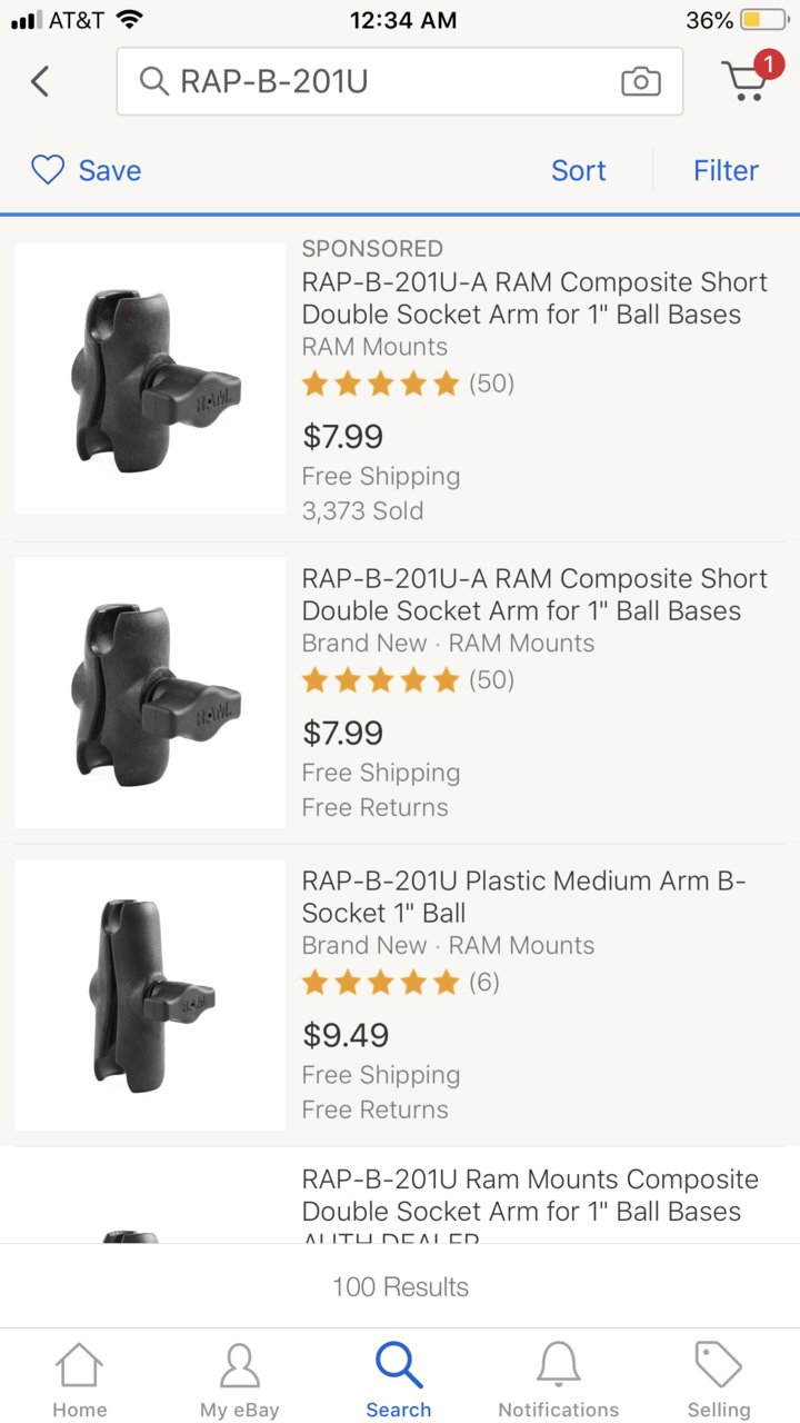

    which is the right socket arm i need? part numbers seem similar but one is short and one is longer??
  18. Jan 20, 2019 at 9:40 PM
    #878
    Little Bruiser
    Little Bruiser Well-Known Member
    Sep 10, 2017
    #229656
    189
    Jon
    Salt Lake City
    2014 tacoma TRD
    Depends on what you choose, the medium is metal which I like, i have 2 and a ball to ball mount
    Slashaar likes this.
