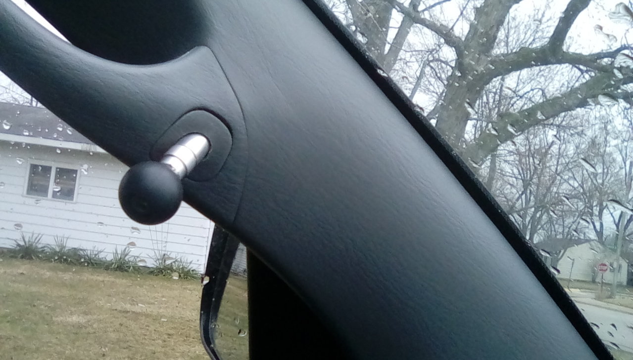

    What did you use to drill out the plug?

    I used a small drill bit to make a pilot hole then upped the drill bit sizes till I got the size i needed. After that I had to use a dremel with a sanding bit and slowly sanded some of the inside because the bolt doesn't line up to the angle of the hole i drilled. It took me like 15 or 20 minutes. I had to keep playing with it. I probably took it in and out 10 times. Just take your time.

    We’re you hand holding the piece or were you able to get it in a vise?

    I held it in my hand. It’s plastic so it didn’t catch to bad at the end of the bit.

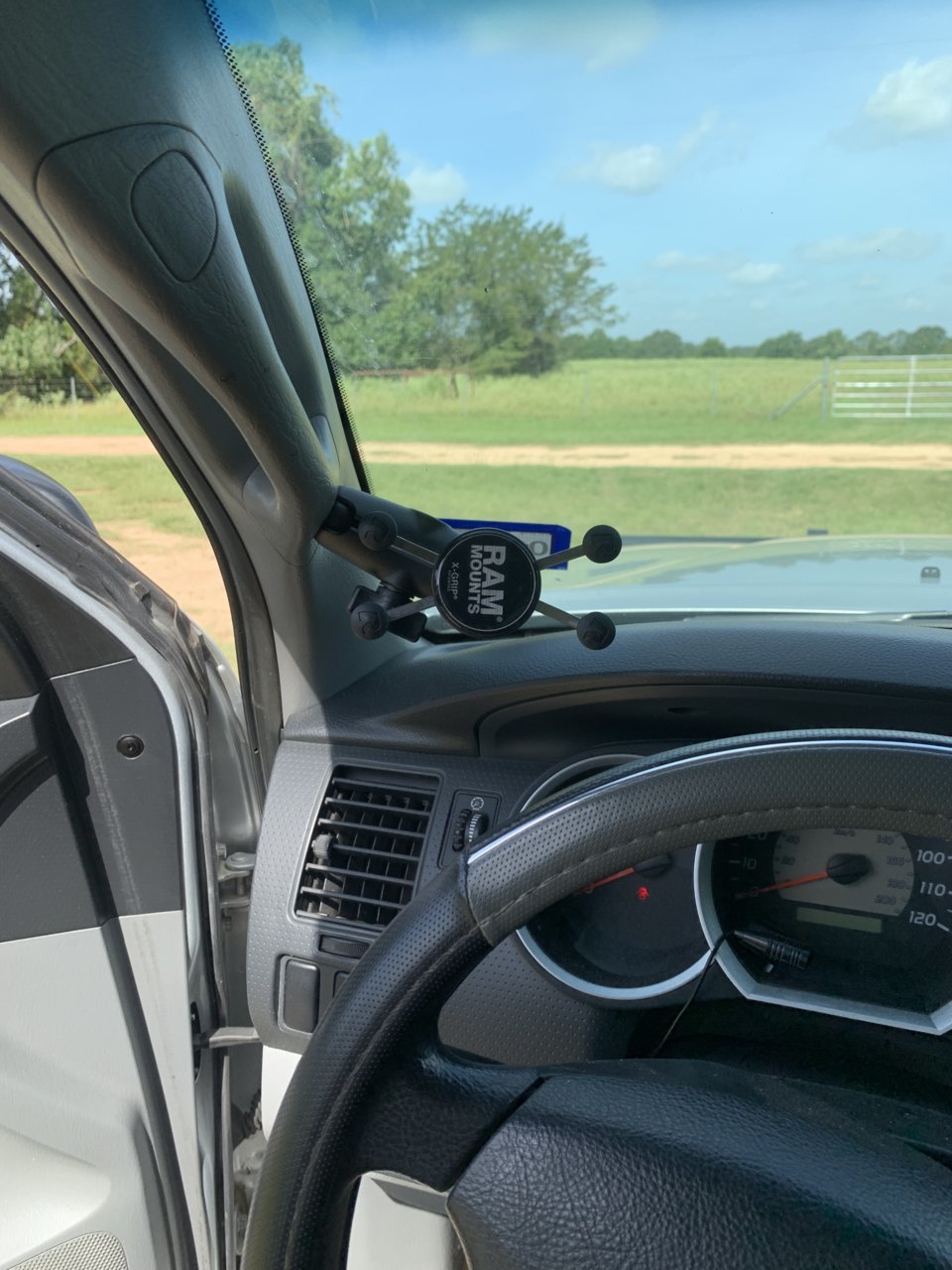

    Finally did the OP’s mod. I have an iPhone X max with a Lifeproof case, so I’ve got to keep my X Grip sideways (so it’s easy to put the phone in and take it out again) but it’s all very sturdy.

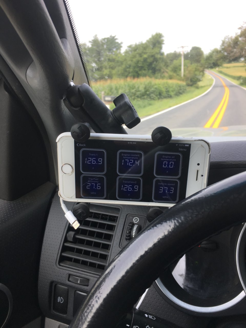

    It looks like you’re running a OBD2 reader on your iPhone? Can I ask what reader you are using? I was just scrolling through Amazon looking at options that’ll work with an iOS operating system. And, having the thingy on my phone would eliminate the need for another mount in front of my forehead, haha.

    This one, works awesome. It generates a wi-fi signal that my old iPhone pics up on the Fusion app.
