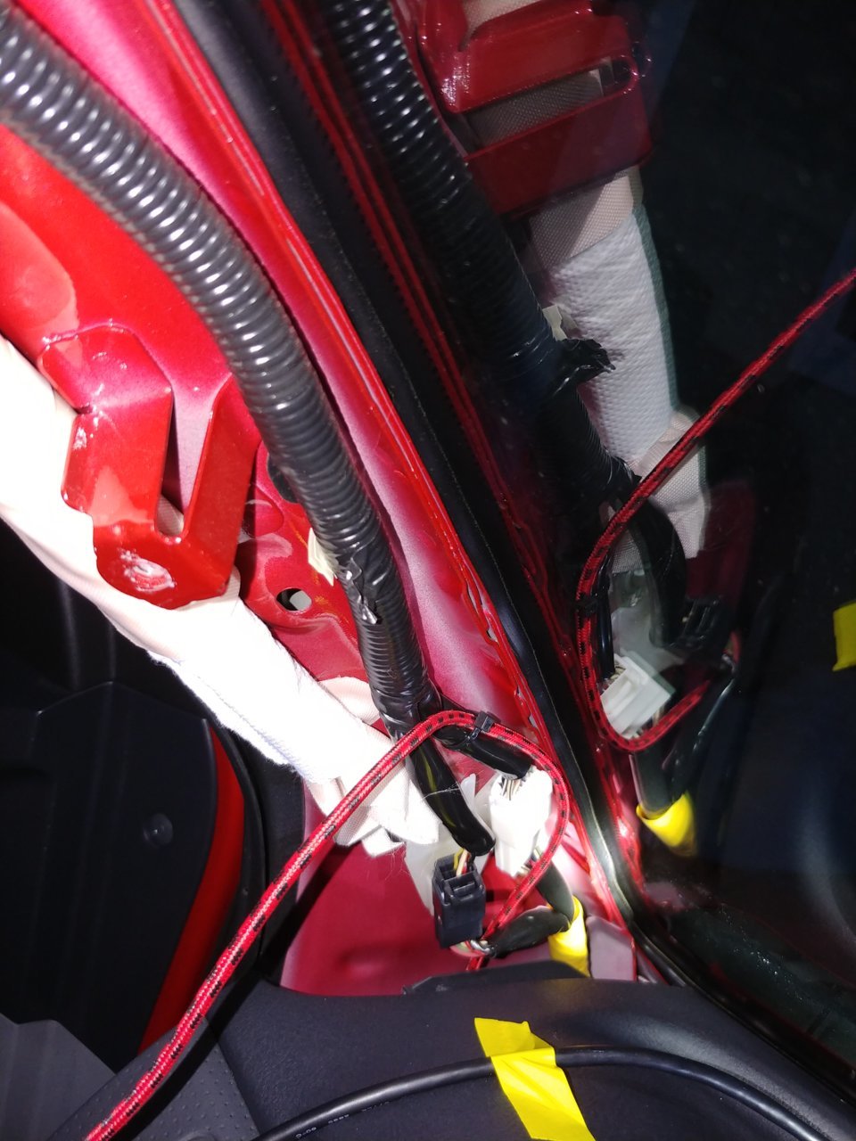

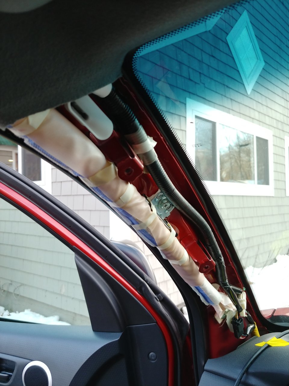

    Isn't it dangerous to mount anything to the "A" post with an airbag there? Wouldn't the mount become a projectile? I've seen mods using that post or even a mod for the Toyota symbol on the steering wheel, aren't there concerns about air bags?
    Just curious
    stbear likes this.

  8. Aug 28, 2019 at 12:40 PM
    #968
    G.T.
    G.T. [OP] Official TW Burrito Inspector
    Jul 14, 2010
    #40169
    19,797
    G.T.
    CONUS
    The A pillar air bag ejects to the side to act as a curtain between the drivers head and the side window. Hence the name, “side curtain airbag.” This mod, nor the solid handle and A pillar cover will become a projectile when the airbag system fires.
  9. Aug 28, 2019 at 4:19 PM
    #969
    SR-71A
    SR-71A Define "Well-Known Member"
    Jun 1, 2018
    #255145
    7,922
    Zack
    Southern Maine
    2012 DCSB, TX Baja Edition. Barcelona Red
    255/85/R16 Falken Wildpeak MTs, Mobtown sliders, ARB bar, SOS front skid, Icon RXT leafs, extended & adjustable Kings, JBA UCAs, OVS wedge RTT, dual AGM batteries, Gen2 xrc9.5 winch, CB, GMRS, S1 ditch lights...
    Bingo bango couldnt have said it better. The side airbags actually deploy under plastic trim, following the window down. Hence the name.
    I did take care around the trigger wires when I had the trim piece off though :anonymous:

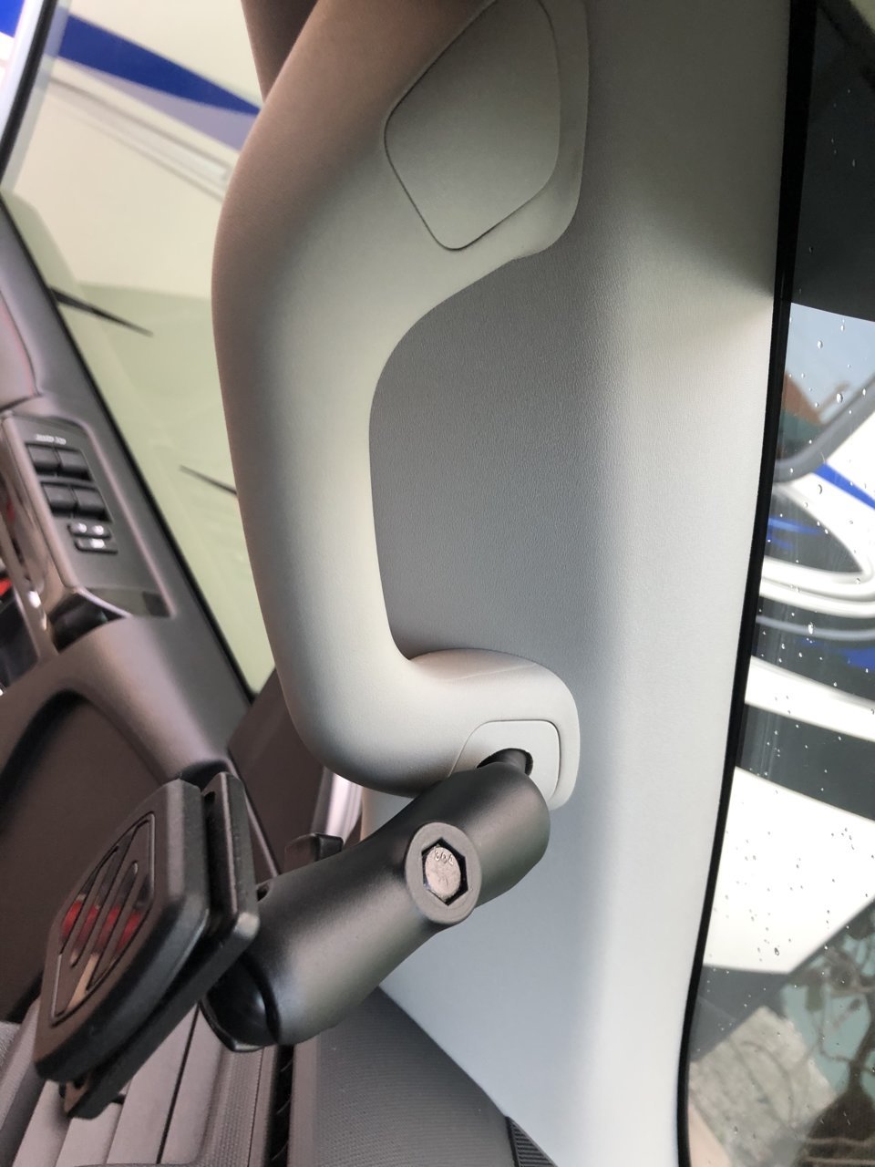

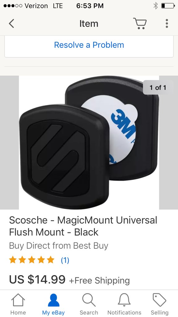

    I got tired of skimming through the 49 pages trying to find what I need. Does anyone have any experience using this mount but with a magnet plate instead of the the Ram x grip holder? I read on one of the first few pages that one guy used a Scosche with a ball base. Just looking to see if anyone else had luck with a similar setup.

    I used the listed above setup. Works great.

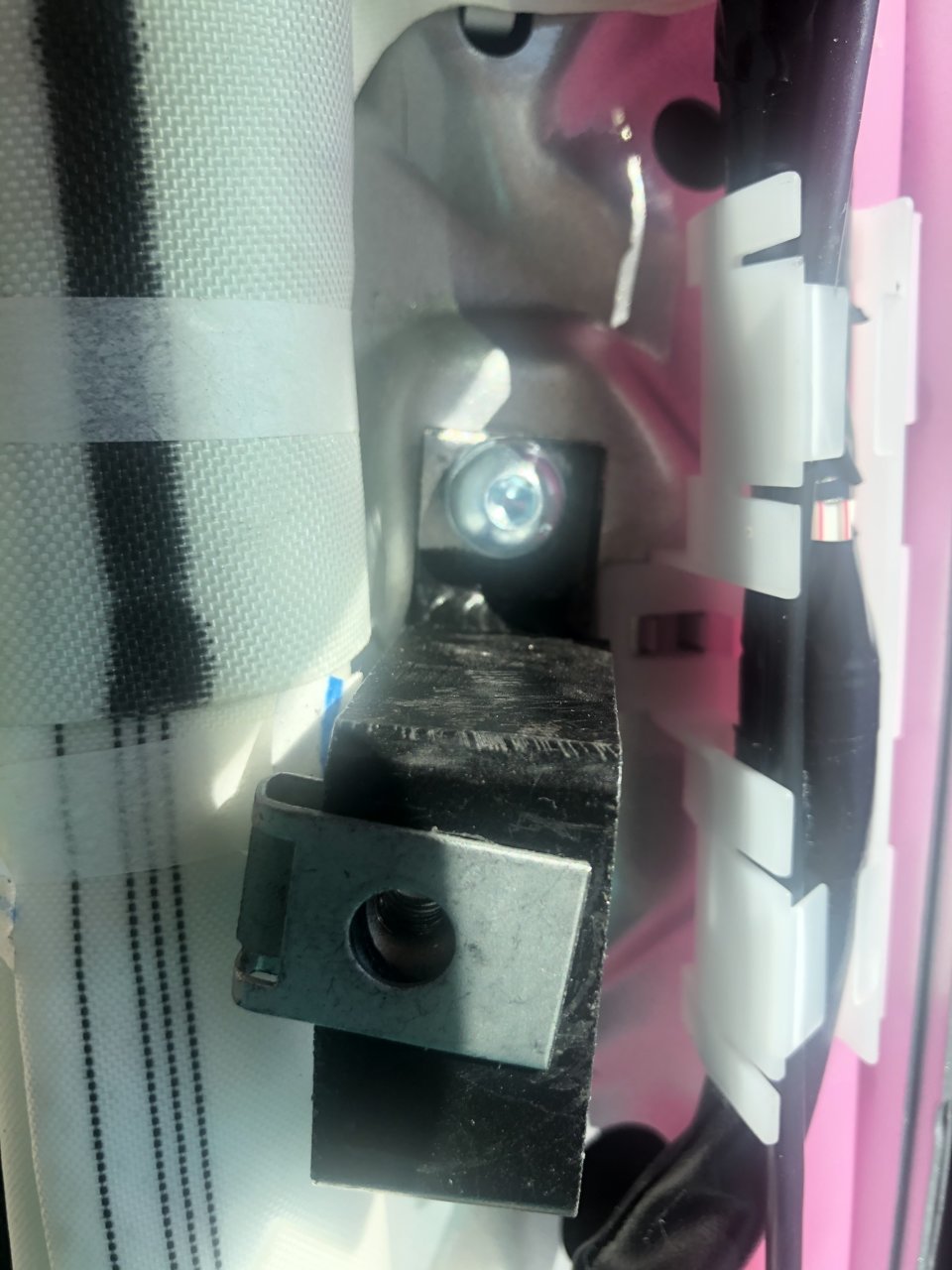

    The airbag doesn't go down the pillar. Plus you're removing a bolt for a grab handle and replacing it with a bolt that secures the mount. There are other car models that have an a-pillar trim with a "leash" clip that allows the trim to detach from the pillar but restricts the distance it will go so the trim does not fly across the car. Insofar as the steering wheel, the folks that sell the mods typically put up a disclaimer about it potentially becoming a projectile and to go at your own risk.

    It actually does wrap down the pillar. But its on the 'under side' of the grab handle mounts, wires, everything else. So it deploys under the trim downward.
