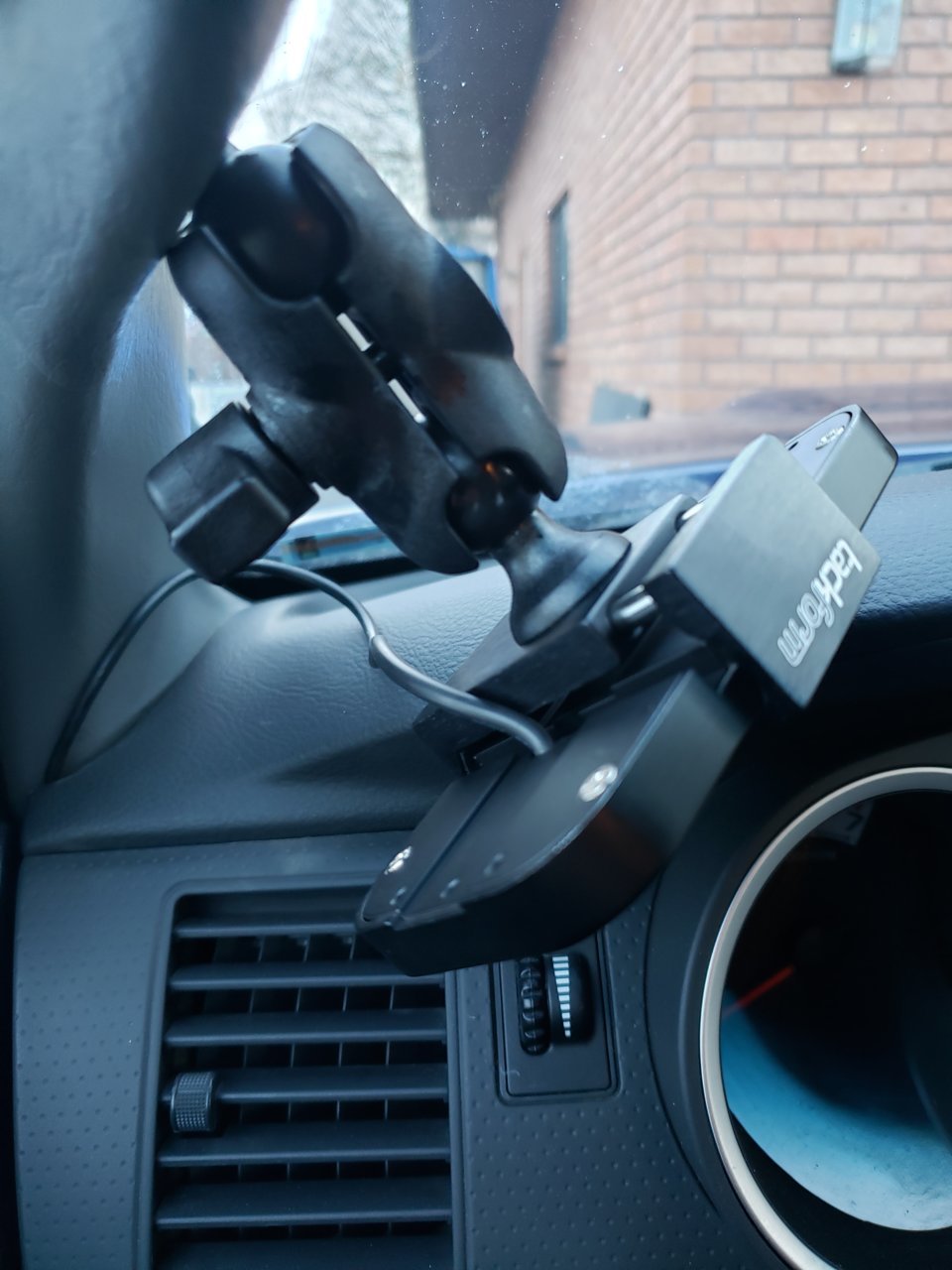

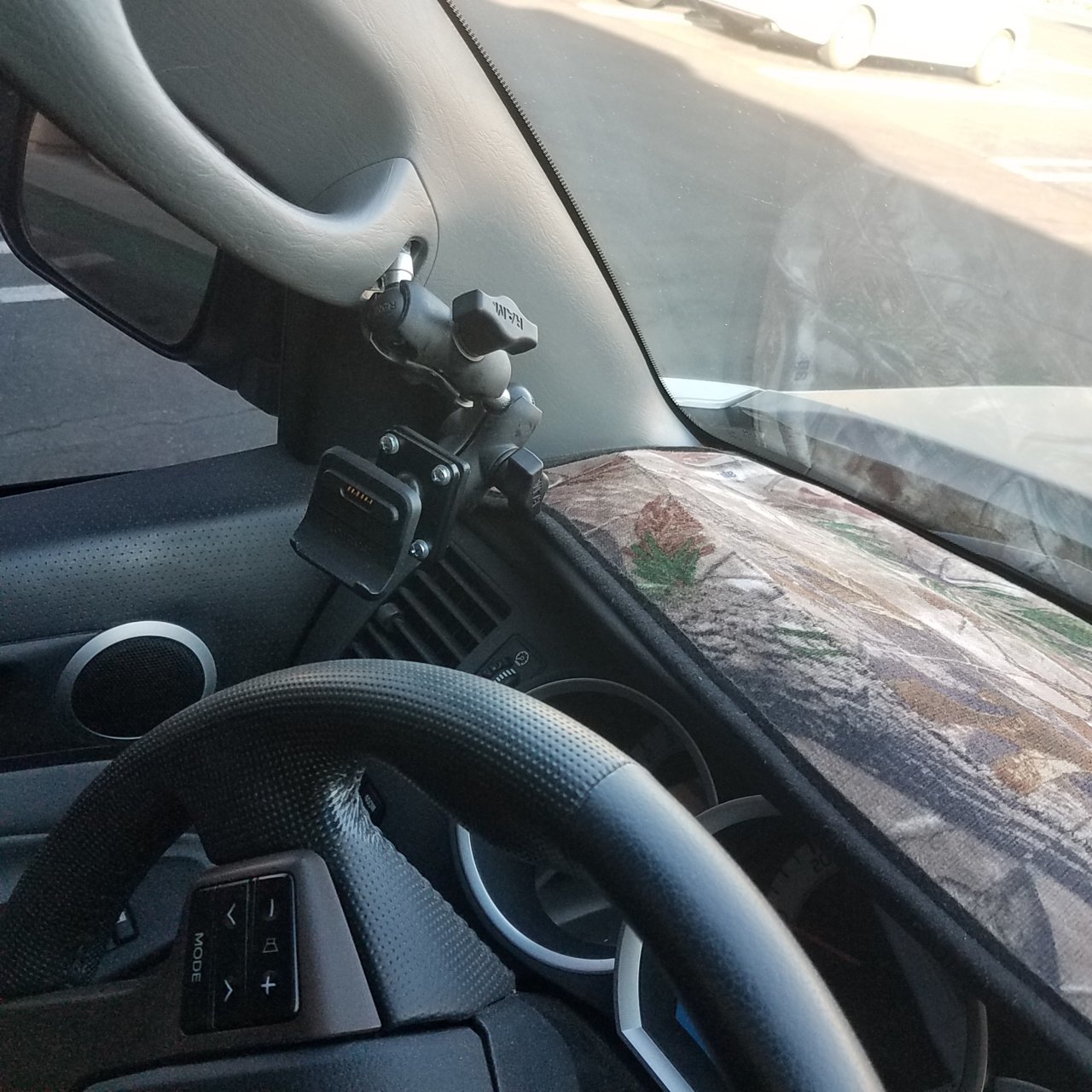

    I finally figured out a way to mount my TomTom GPS by using it's factory magnetic mount/Charger
    Parts Used:
    RAM-B-367U
    RAM-B-230U
    RAM-B-201U-A
    RAM-B-347U
    ProClip - TomTom Ball Mount Adapter Plate - Item: 215588

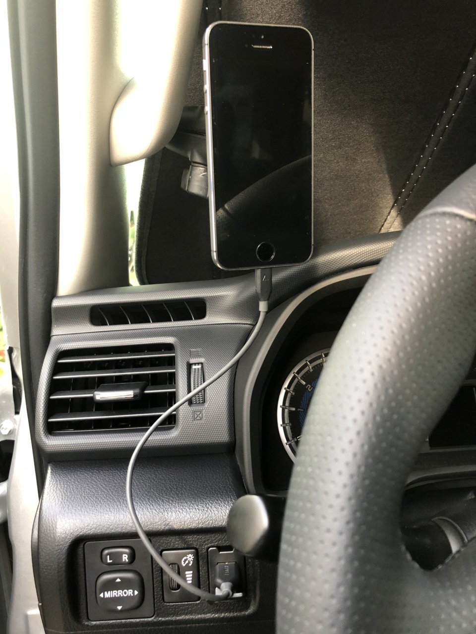

    Added a USB and a 12” Lightning Cord.

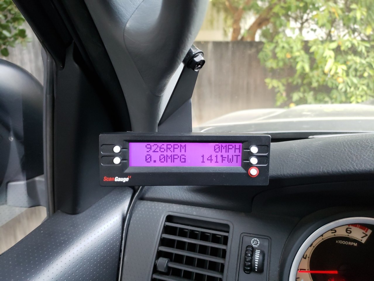

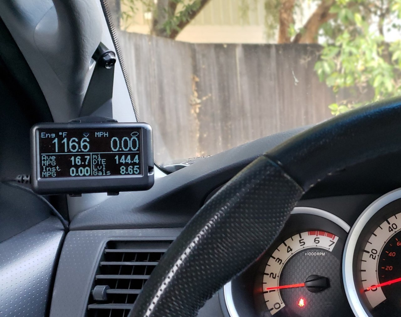

    For those of you asking about Ultragauge or Scangauge mounts using this method, I designed a couple of a-pillar brackets. These would work on their own to hold the UG or the SG, or in combination with the phone RAM mounts discussed in this thread. Have a look:

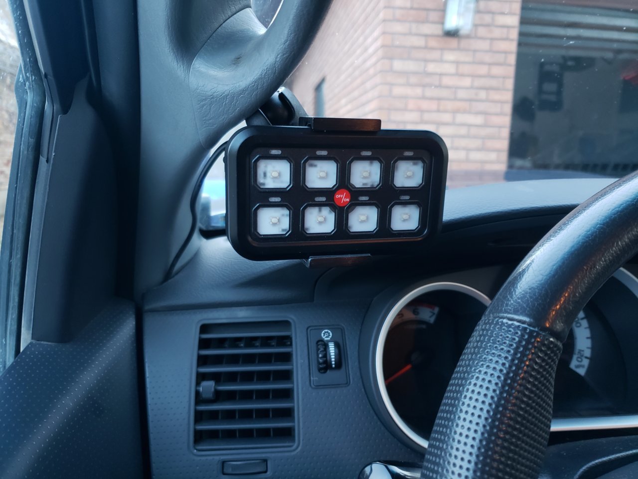

    789
    Cristin
    2015 Barely Stock TRD Sport
    Thanks OP! Very rad mod. Worked perfectly for the new switch panel.

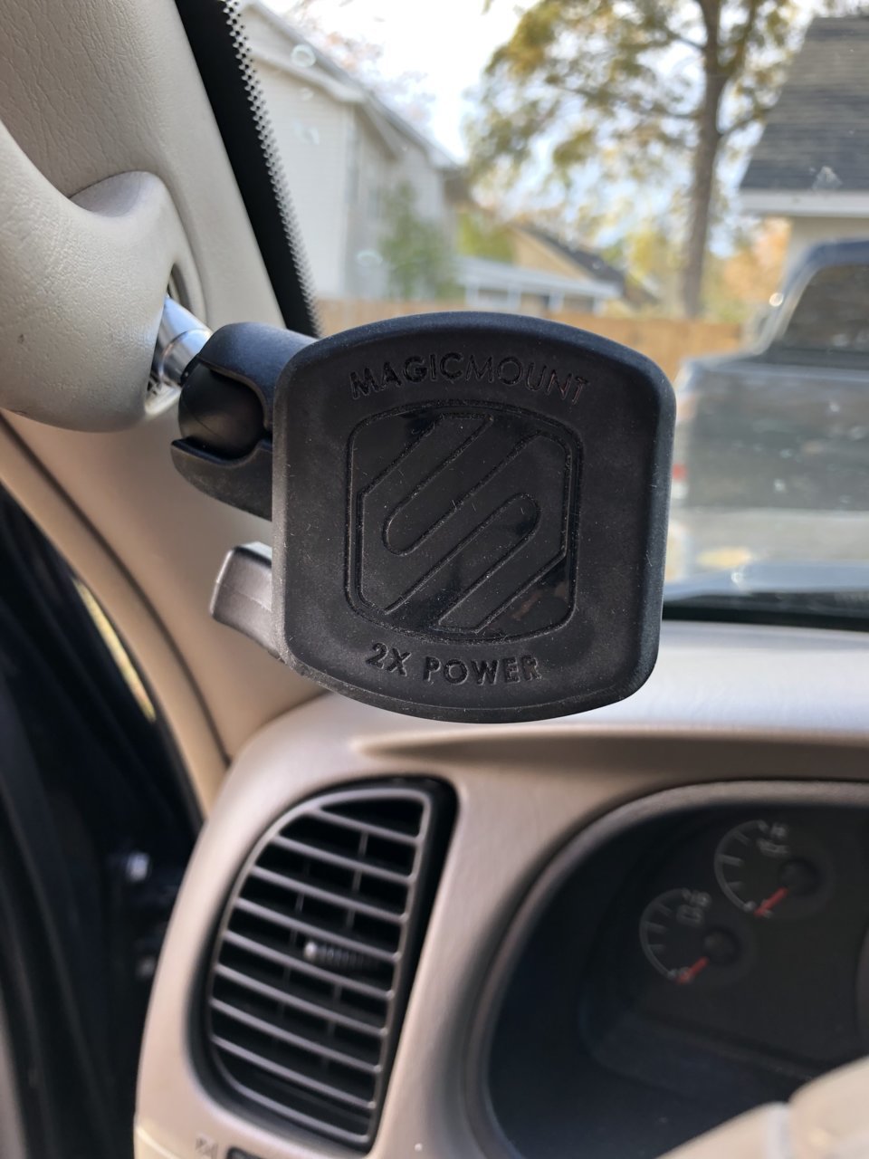

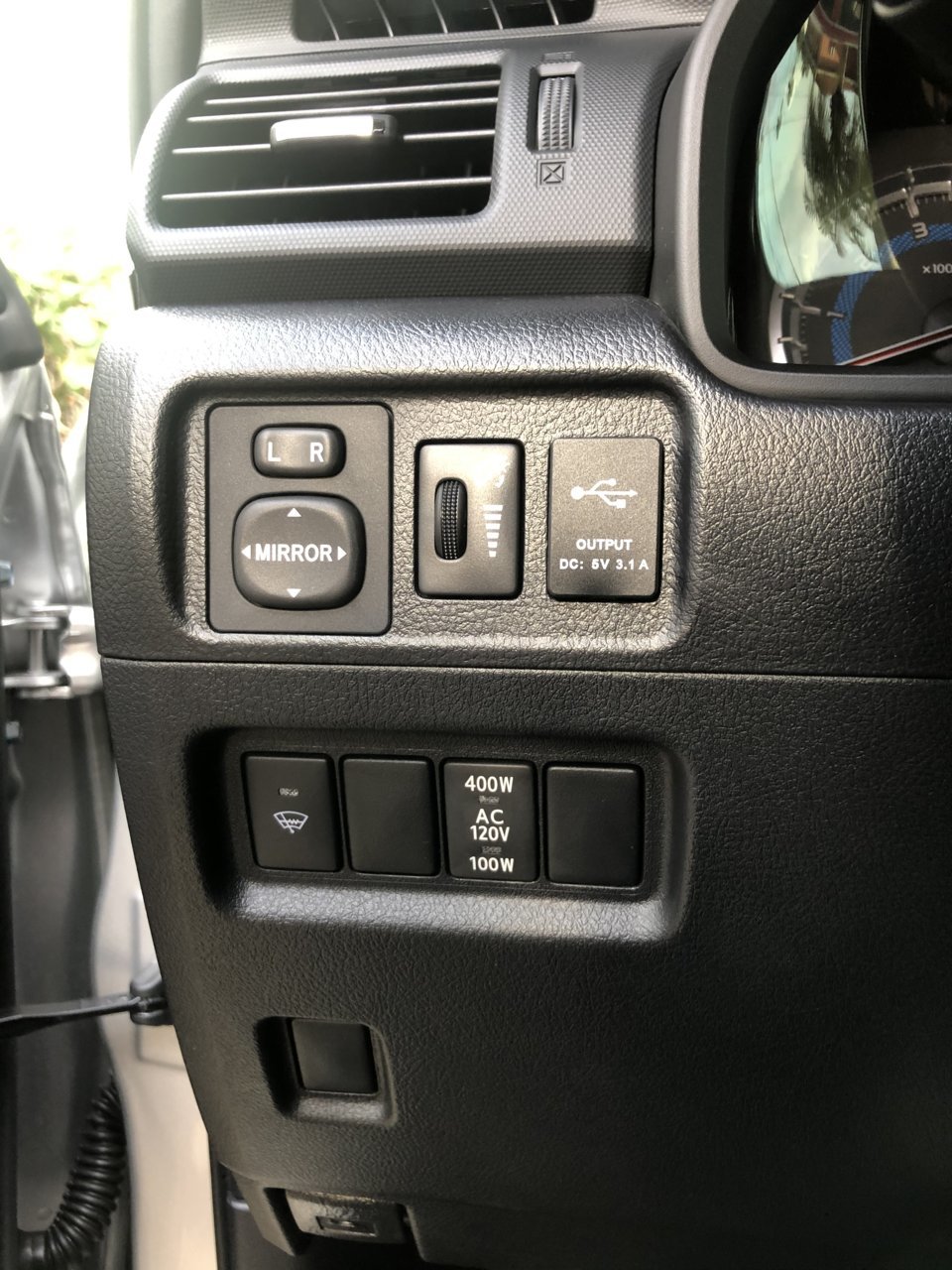

    @SeafireXV and @Soul Surfer can you guys post a link of your scosche mounts and ram parts? sorry it takes me to the scosche page when I click on your post and there are only like 100K choices to chooose from! sorry :( thanks so much looking forward to this mod .. also do I need the washers and bolts if I do the arm that you use ?

    Yes you need to mount the 1” ball to the A-Pillar with the bolt and washers. Here’s The Links:
    Base - https://www.rammount.com/part/RAM-B-347U
    Arm-
    https://www.rammount.com/part/RAM-B-201U
    Magic Mount-
    https://www.scosche.com/magicmounttm-surface
