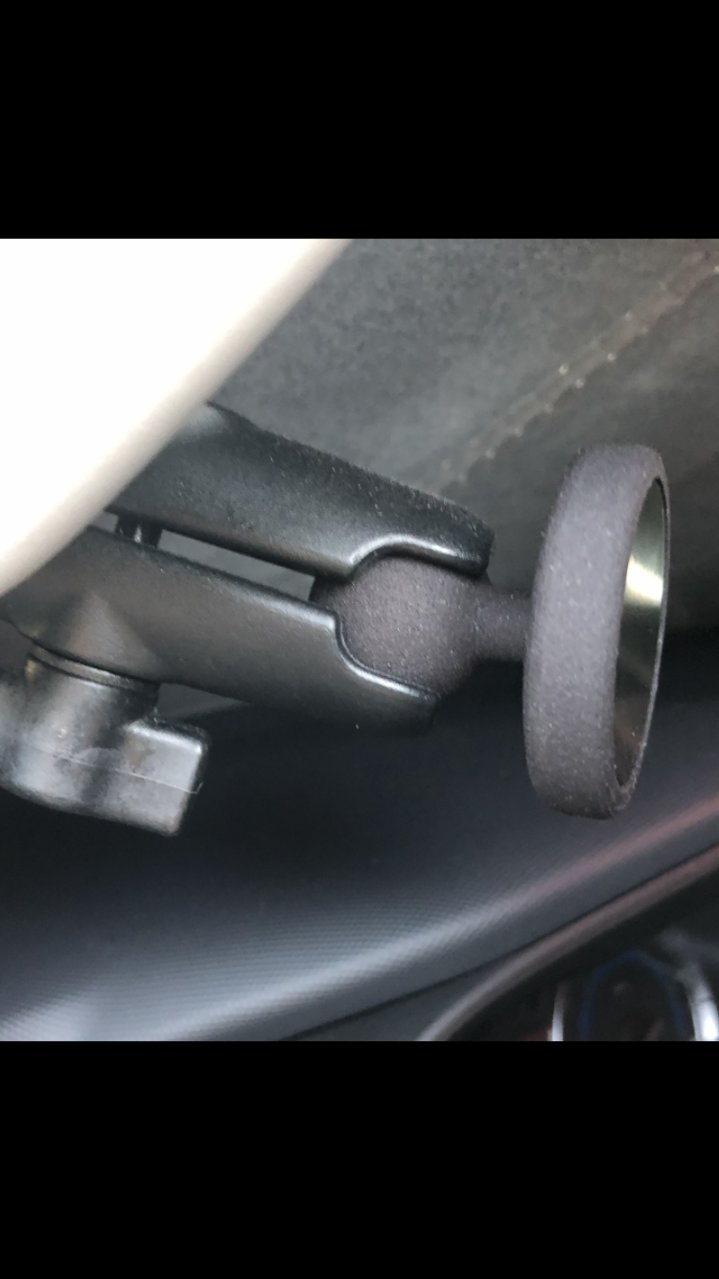

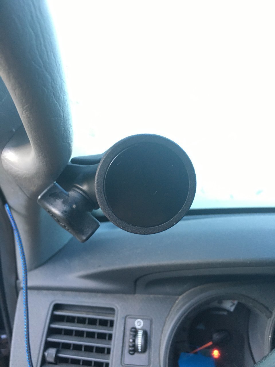

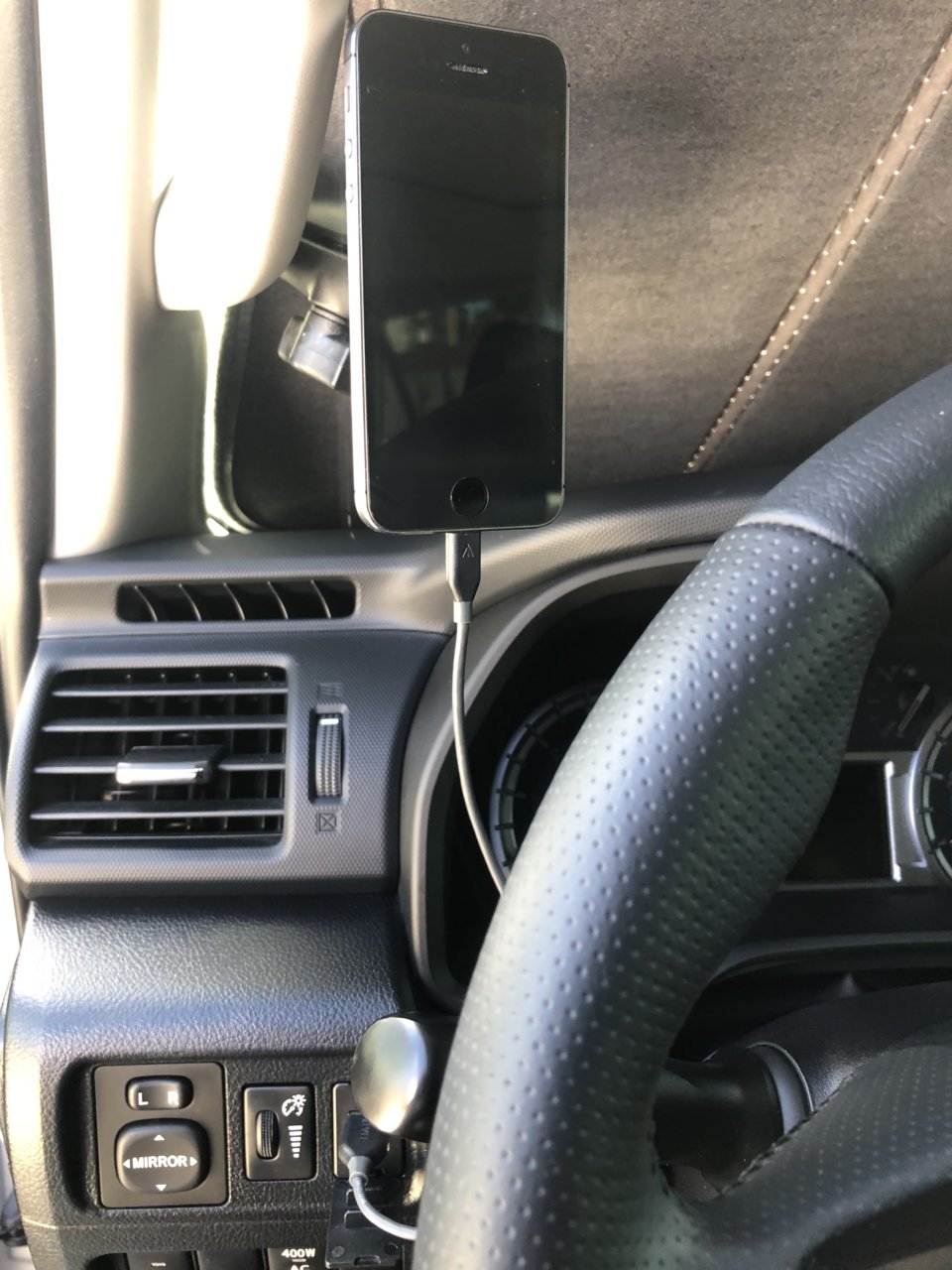

    I ended up changing my mount a little bit to a magnetic mount I 3D printed.
    60E8989A-6D9F-4185-AA0B-ADEF87213A89.jpg 0E2575A4-745C-4540-8392-1DC6F92431B9.jpg

    Nice Job. Let me know if there’re available to purchase.

    These are available for sale if you like.

    Is it just the magnetic part you're printing and selling or a full "bolt on" product with all components? Price?

    Just the mount with magnet inserted. $60 shipped in US.

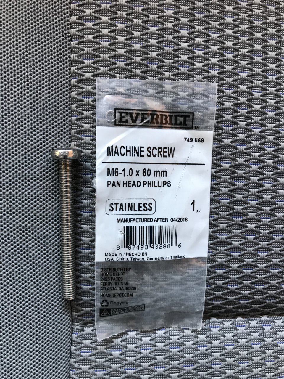

    I wound up making this my first mod...I had picked up an M6x50mm socket head cap, but found the 50mm to be just a bit too short. I headed over to Home Depot to grab a 55mm socket head cap, but they were out of stock when I got there, so instead I grabbed a pan head machine screw. The head is the same size as the M8 bolt that originally came with the Ram ball (this was a left over one from my ATV), so this fit perfectly. I also chose the 60mm length, and found it to be a better fit. The plan will be to mount my powered Garmin holder for my Montana. I did a test fit with both my shortest and regular length arms, and preferred the shorter arm.

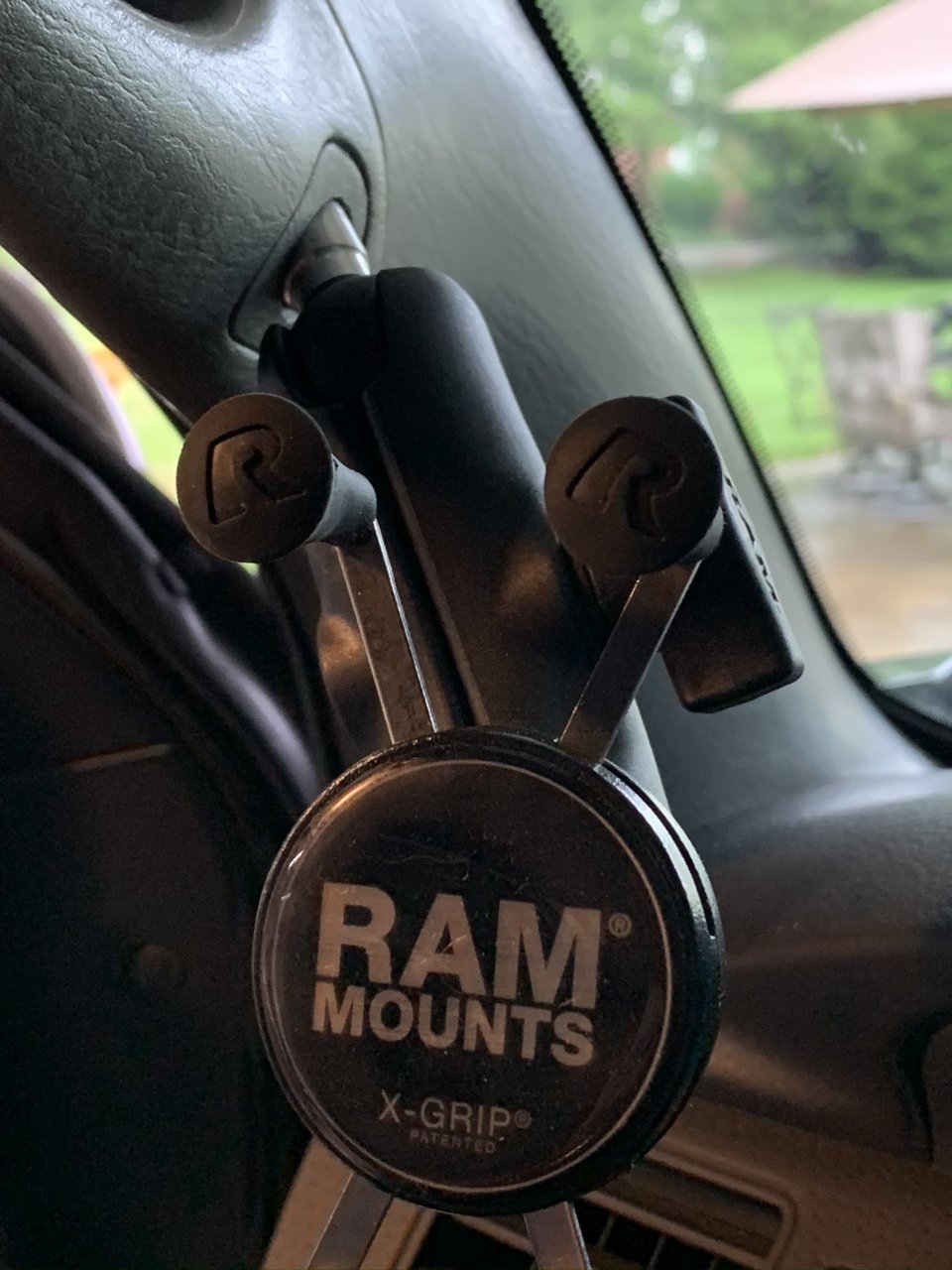

    Did the OPs method today. Very nice! :thumbsup: Went with a 55mm screw. Little less catch than I would like. Loctite for confidence boost. Stoked to get a dusty ram arm off the shelf into use. On the the next mod...

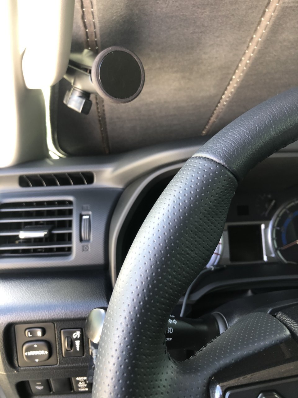

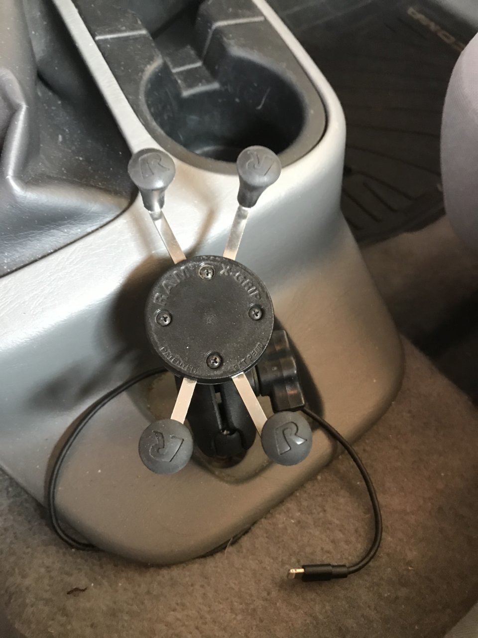

    While I had the mod in place, I never actually used it. I could never get the arms to set where I wanted the device, and I didn't want to spend the money on the swivel arm that RAM offers. I was also going to set it up for my phone, but found that the USB/3.5mm plate I mounted in the center didn't match the size of the three upper blanks. (I have a 6" USB-Lightning cable I was planning on using). So in looking for another place for my phone, I removed the useless rubber patch in the center console, and found that there was an M6 bolt there. I don't need my phone near my line of sight, since I upgraded to my CarPlay head unit, so this location works well. I'm using the shortest RAM arm I have, and it doesn't interfere with the shifter or the seat.

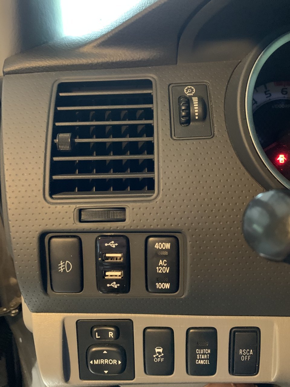

    I took a piece of round aluminum stock and used a lathe to drill a hole in the center then turned the OD to the same size of the shoulder on the Ram mount. I went ahead and installed an Add-a-Fuse and USB outlet in the spare switch location. A 12” lightning cable and viola! This is probably the most useful mod I’ve done so far - so handy!

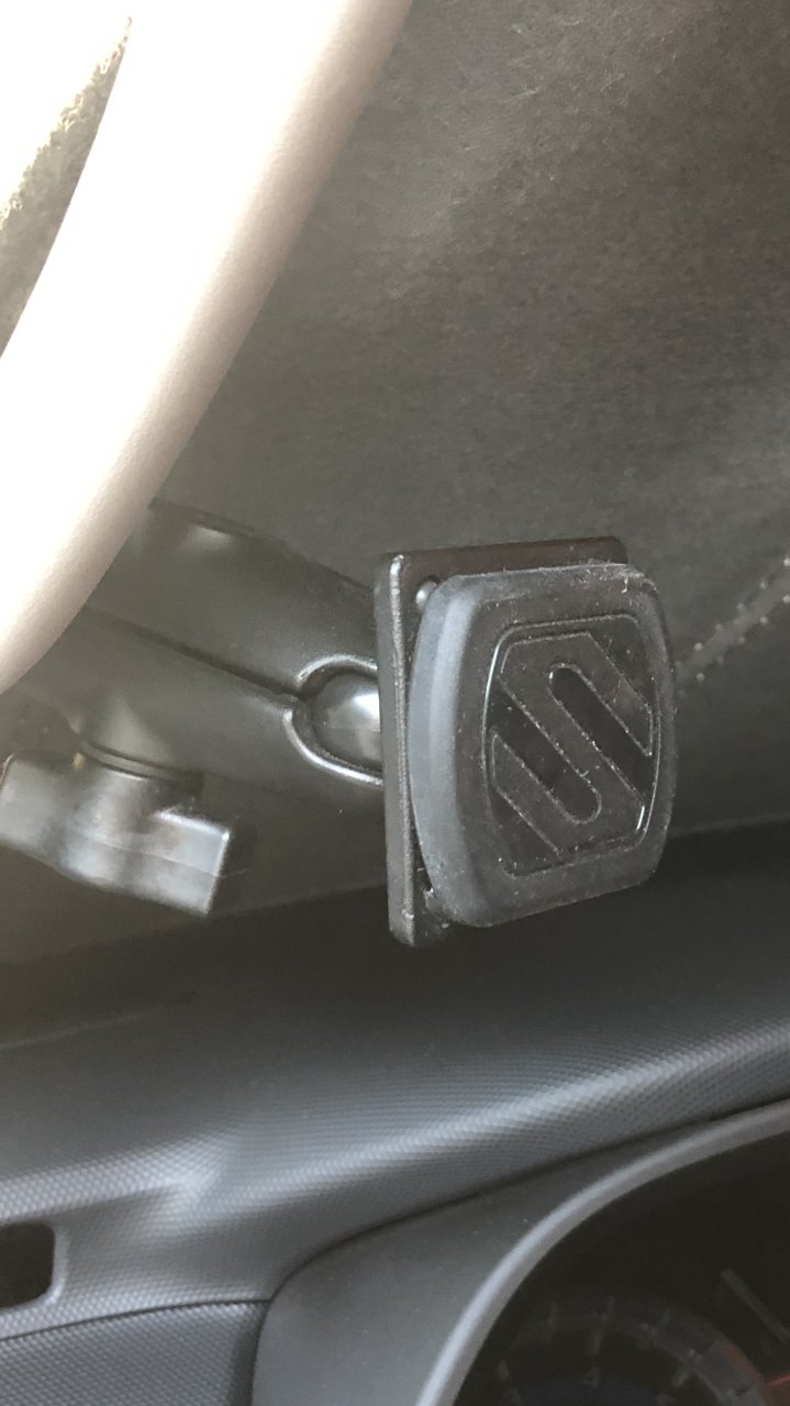

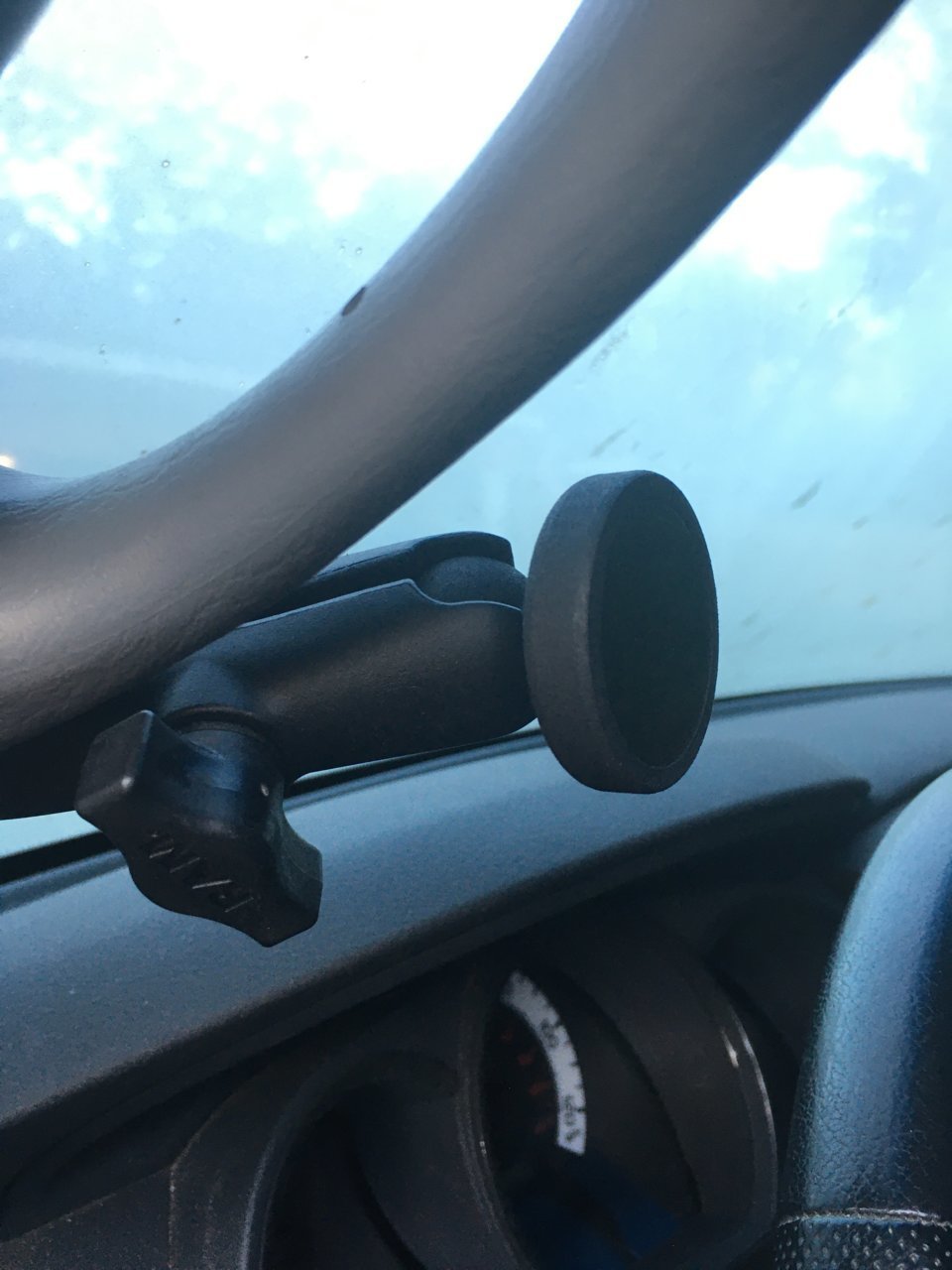

    Went From a Scosche magnet to a
    @docloco round magnet mount.
    Awesome product and a clean looking mount.
