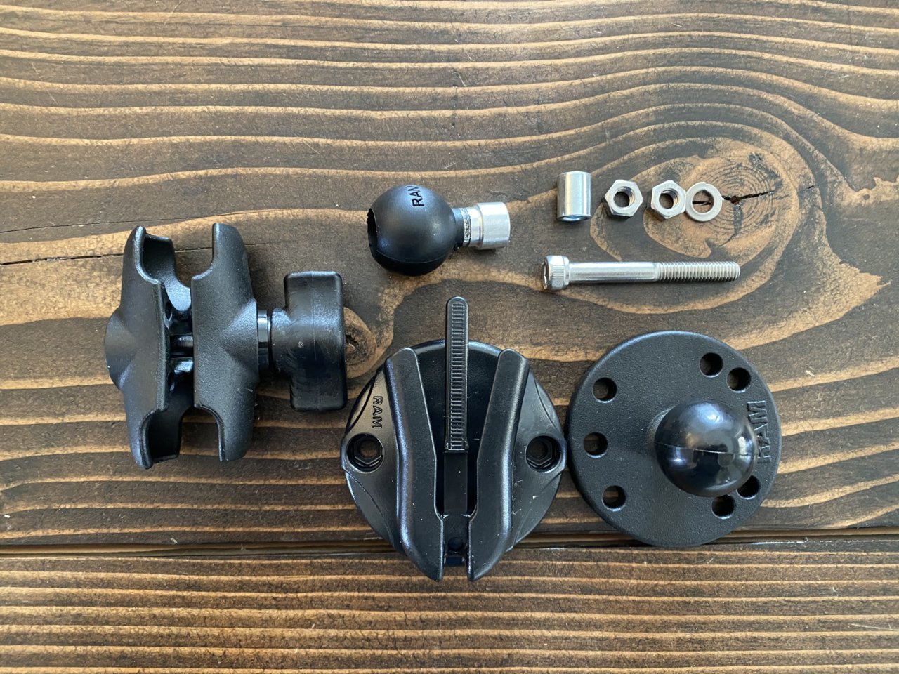

    I suppose I didn't make my post clear, or you didn't look at the one I referred to (https://www.tacomaworld.com/threads...gps-phone-holder.372250/page-55#post-24825879). Anyway, if you can't manage to dock/undock your phone from a similar cradle one-handed, I think there might be a bit of an issue. Regardless you're right. They are a bit bulky, but I think they work very well to hold things in place, and the wireless charger is nice, but I think you may have found what you're looking for based on other suggestions. I'd like to see what configuration you end up putting together!

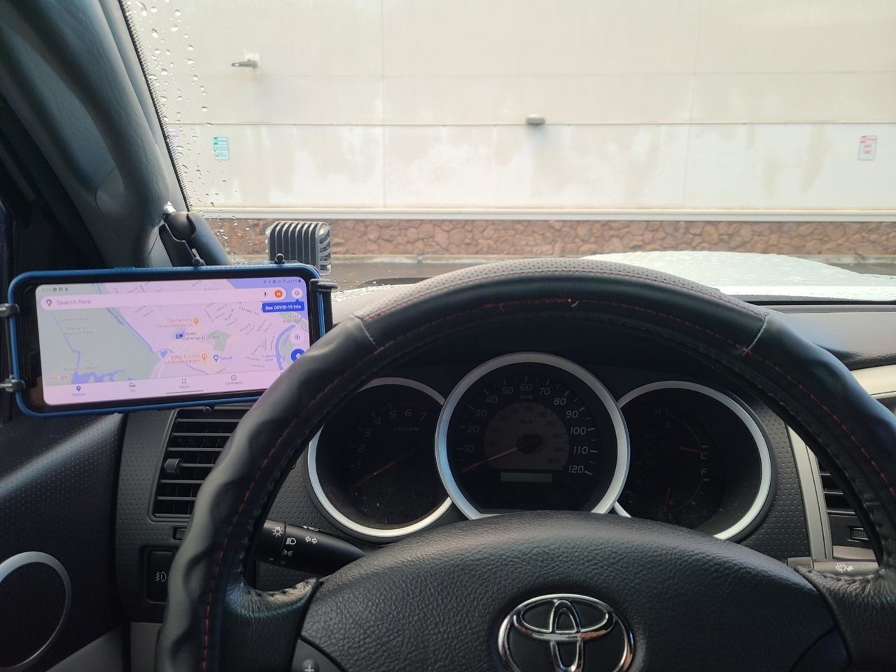

    Yeah, I had the same thought when I read that.
    I ordered the Quad Lock yesterday. We'll see how it looks when I get it. Not a huge fan of having the adapter on the back of my phone case full time, but it looks like a really solid mounting option as far as keeping the phone secure and in place

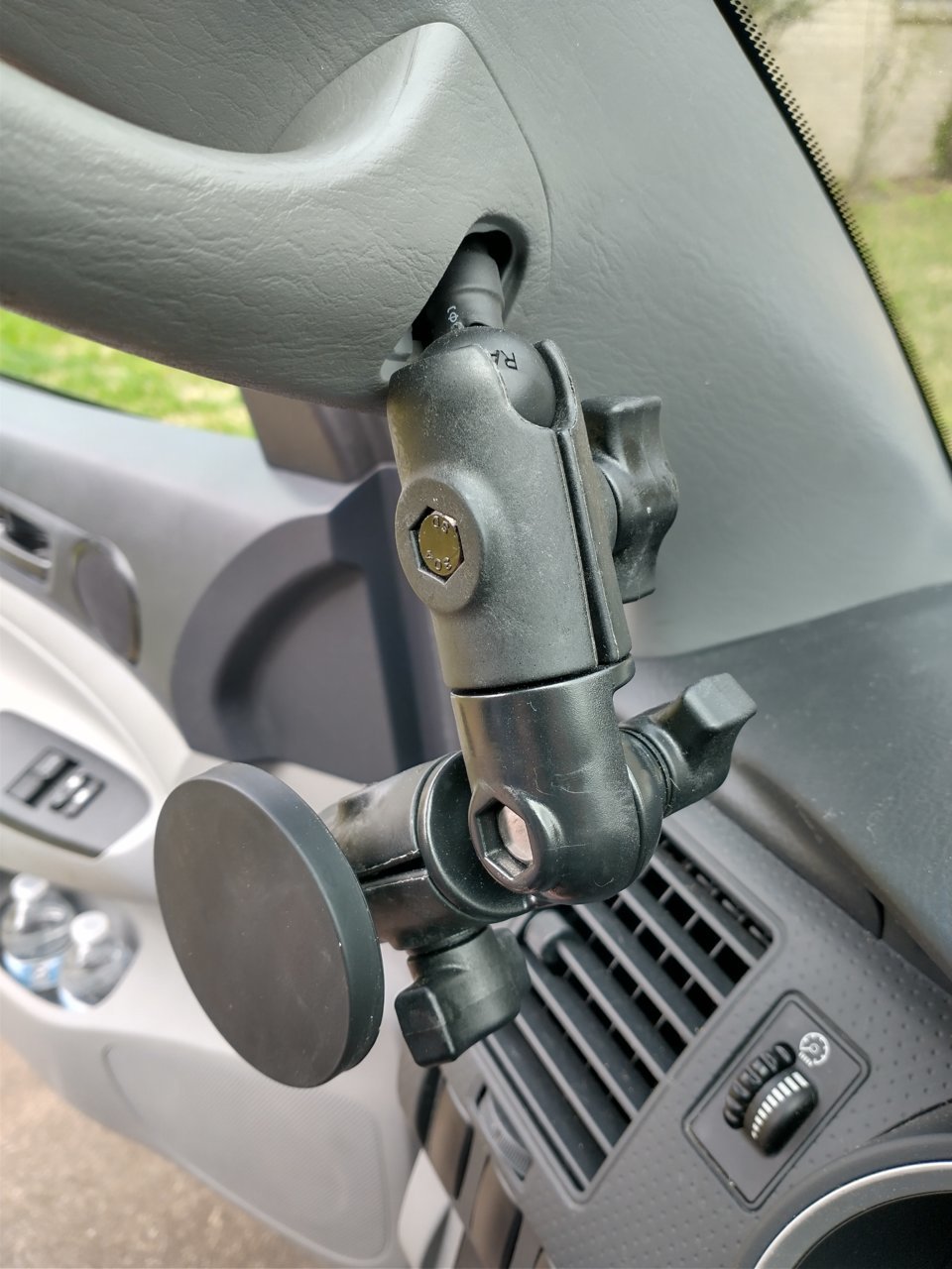

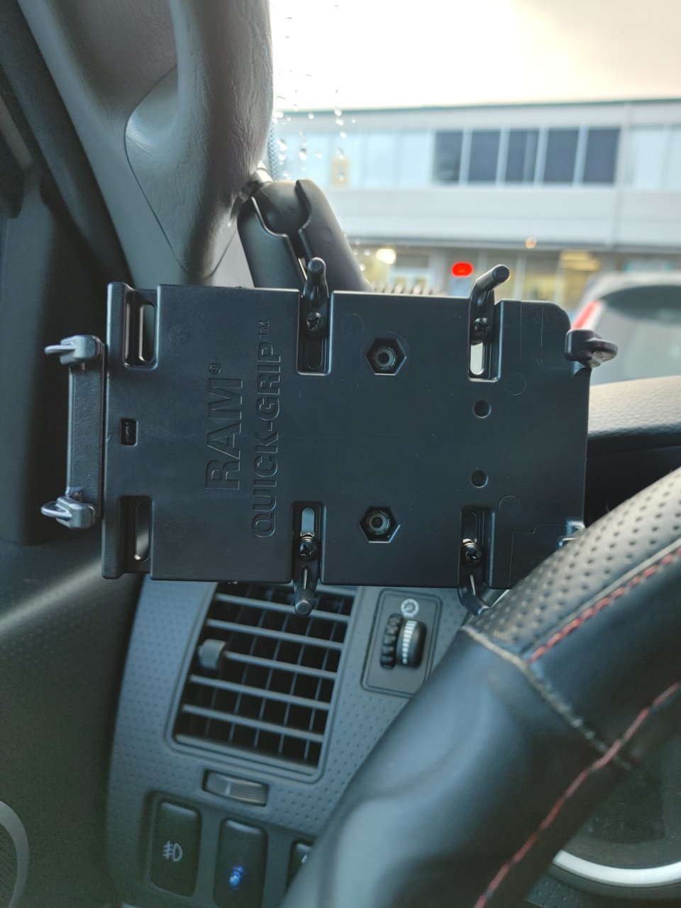

    Finally got around to doing this mod. It works great! I went with the 55mm bolt and the Ram Quick Grip instead of the X-Grip. The phone is an LG V60, it's a large phone and can be run with a dual screen. Had to go with the XL size Quick Grip.
    4x4cajun, omegaman2, Biscuits and 2 others like this.

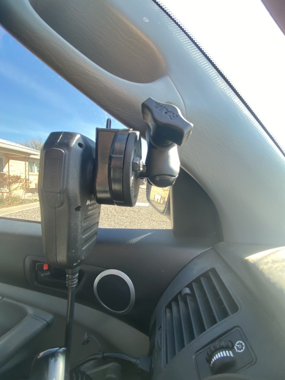

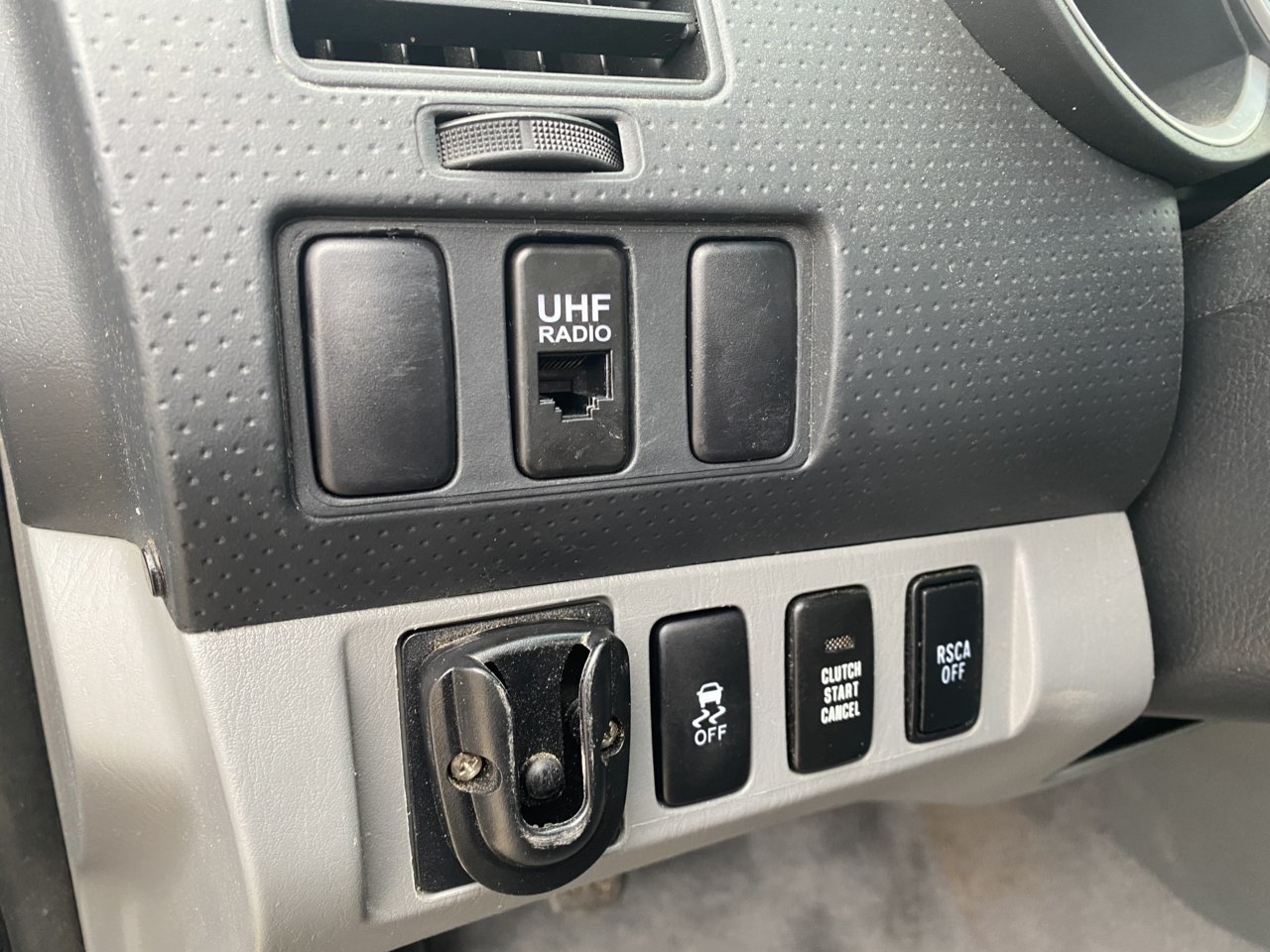

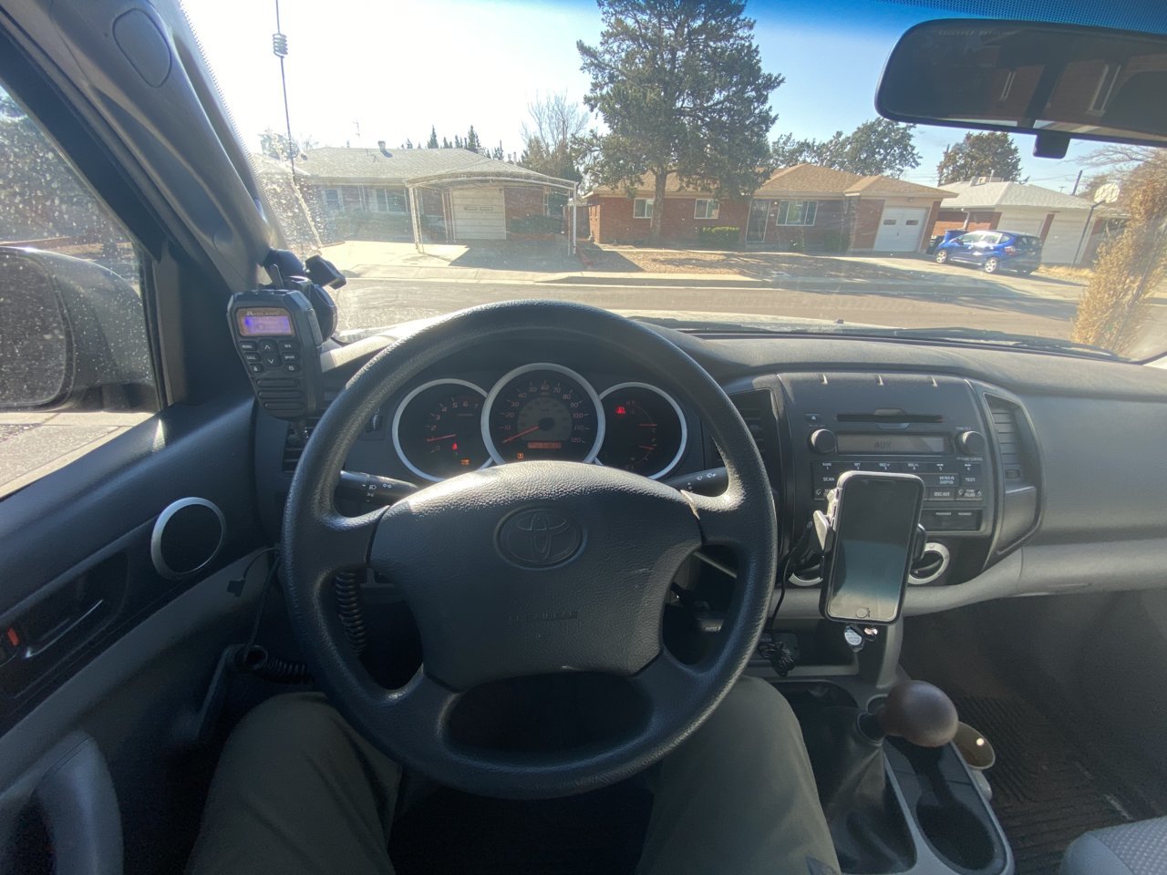

    Got the parts installed, I put in a UHF plug in the dash the APillar mount but I’m trying to figure out if I like the top or bottom better.

    Ya I think it’ll work well I’m trying to decide if I want it at the bottom or too bolt.
    bottom seems a bit close to my hand and the top seems a little too close to my head. I might switch to one of those double swivel arms to see if I can move it a little further out of the way.
    Did you also get one of the UHF plugs? The one I got seems to be slightly broken and I don’t want to deal with a return over seas so I hope it holds up.
