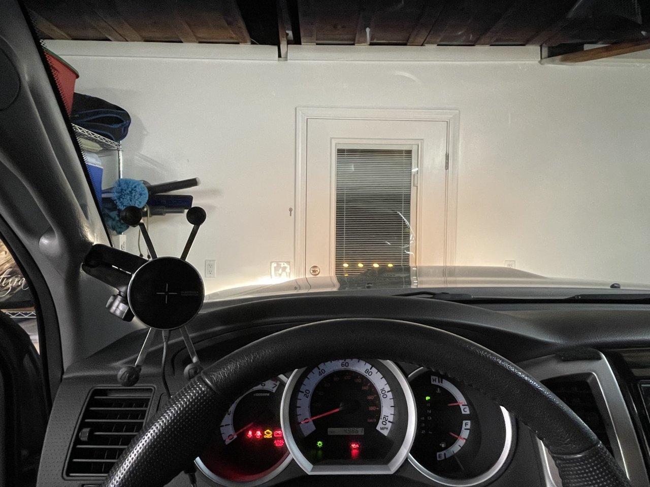

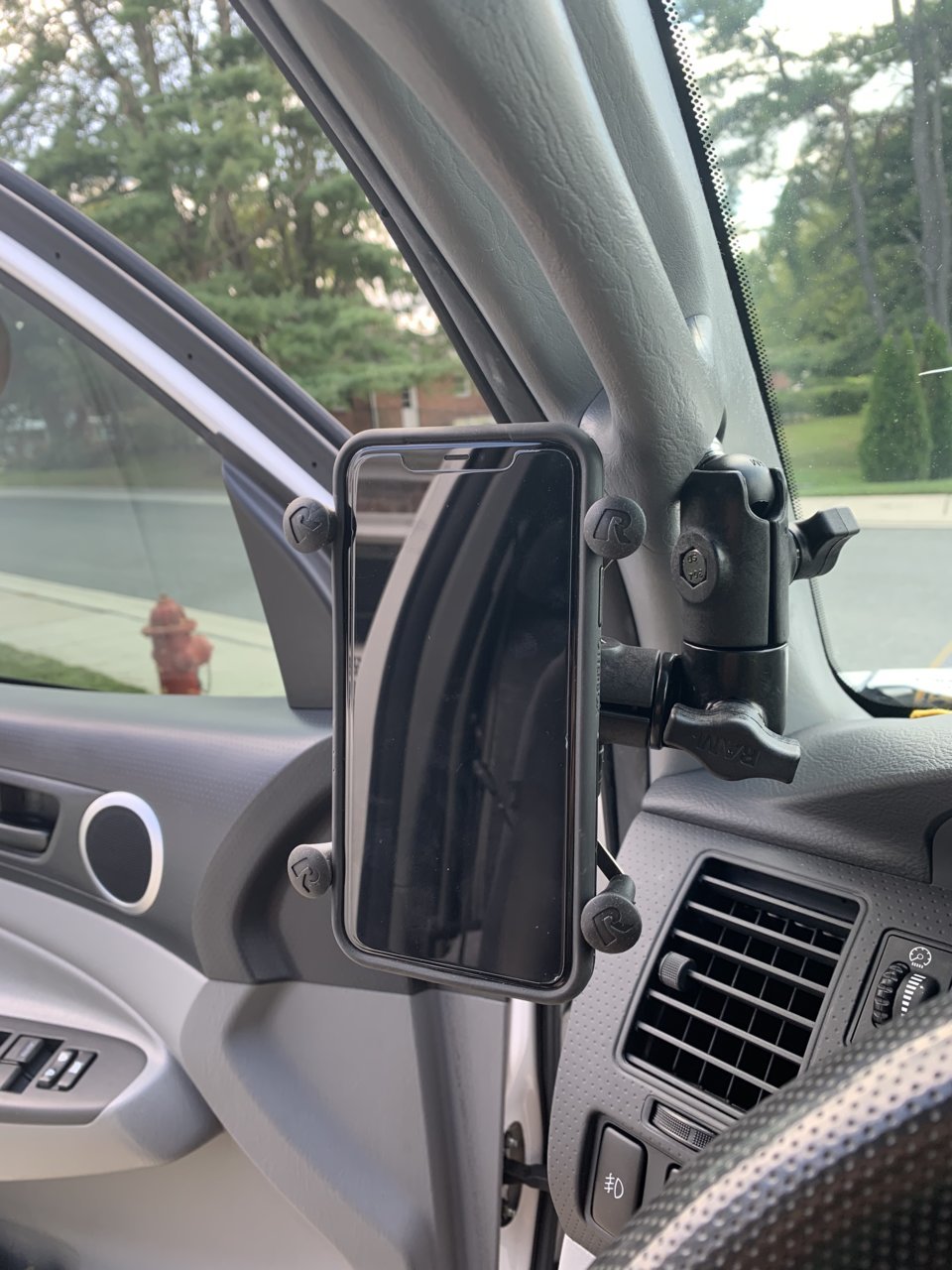

    I recently did this mod with the following changes.
    - Used an M6 x 65mm
    - Went with the RAM Quick-Grip XL
    With the 50mm bolt, the phone sat a bit high still, blocking some of my vision. The 65mm bolt allowed the Quick-Grip to come down at an angle clearing my view some and shifting away from my A.C. vent.
    I needed a one-hand operation for my phone (iPhone 11) so I tried out the Quick-Grip. After using it for a couple weeks now, I like it. It's quick to put in and take out and it's super sturdy. I didn't install the side grips since it only would've got in the way for me and it still holds solid.
    Anyway, just thought I'd share.
