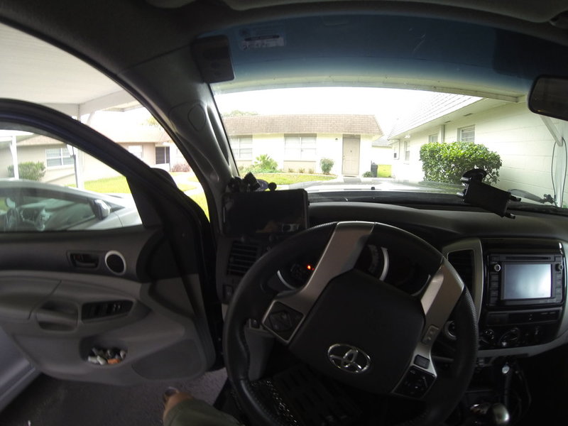

    Seems like these bolts are hard to find. Will 40mm work?

    HD did not have it. My small mom & pop hardware store did.
    I think 40mm will put the ball too close to the grab bar. Wouldn't it @Palehorse1 ?

    The longer bolt is so you can use washers, nuts, spacer or combo of to move the ball out from bar enough to have room for the arm to seat and be able to have some movement for aiming your device towards you. Even doing that the ball is still close to the grab bar. If anything I might try a 60mm bolt to get ball out just a bit further from the pillar.

    The only concern is if you run a cable to your device under the A-pillar cover itself. Make certain to have it arranged onto the windshield side so that it will not interfere with your side curtain airbag.
    I don't have my truck right now - getting fiberglass fenders fitted and painted - but I will make a point to take a picture for you this weekend.
    It could work for some depending on where they want their device to be situated, but the reason behind the use of the 50MM bolt and the specified hardware was so that the ball could be far enough out of the handles bolt cavity that you could mount the arm to it and have enough of the articulation needed to put your device where you want it. Some people are alternating between multiple devices and they will need that flexibility to accommodate different size devices and their mounts. If you know you are only going to use one device and mount you may be able to mock it up and see if 40MM will make a useable solution for you.
