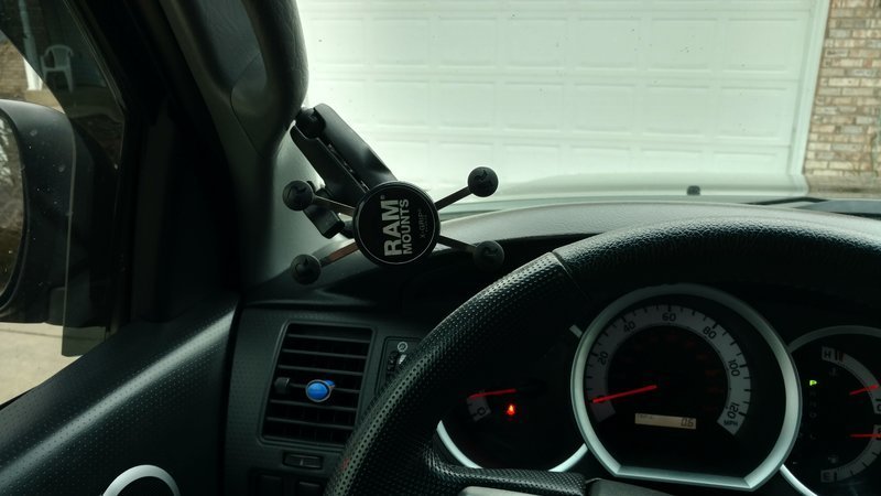

    Thank you to the OP Palehorse1. I installed mine today. I got the standard size X-grip hoping that it would work with my phone (Moto X Pure Edition in Otter Box case). It barely fits but it works and I'm IMG_20160208_131616240_HDR.jpg happy with it. Thank you for posting this. Now as soon as it warms back up I'll be doing the rear diff breather relocation mod.

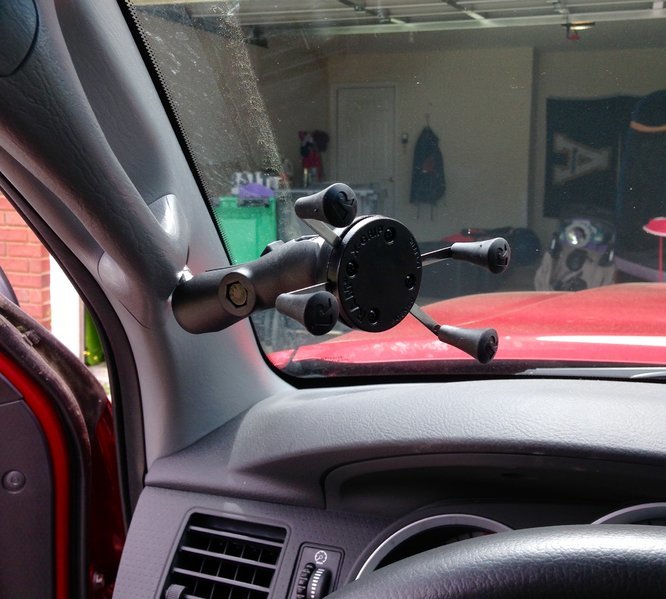

    I went with the RAM-B-360, its a motorcycle mount that fits perfect. It has a built in knuckle that helps keep the mount further away from the steering wheel.

    How did you bolt in to the grab bar mount with that? The picture I found of it aren't clear about both that come out of RAM mount.

    The bottom side piece comes off and tossed. The bolt then has enough threads to attach in the a pillar hole. Just make sure to get the right length bolt and threaded correctly. I think i used a 50mm, not positive on that size, i purchased a couple different lengths.

    This is what my installed looks like.....

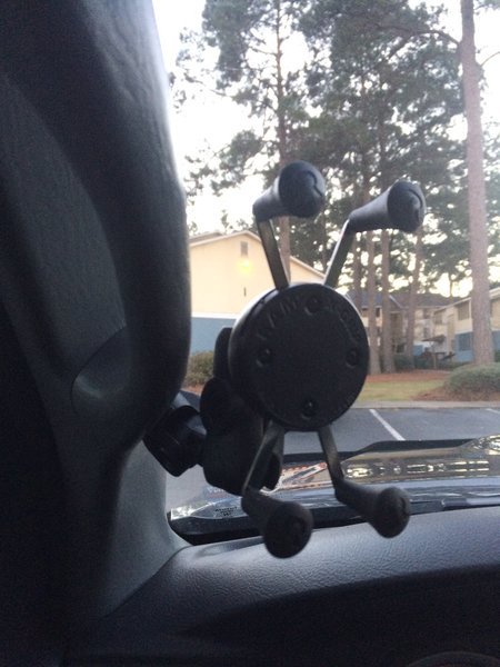

    Installed today! FYI I had to go up to a 55mm bolt because I couldn't get the 50 to bite. Not sure whats different about my 2015 A-pillar than other trucks. Love this mod.
